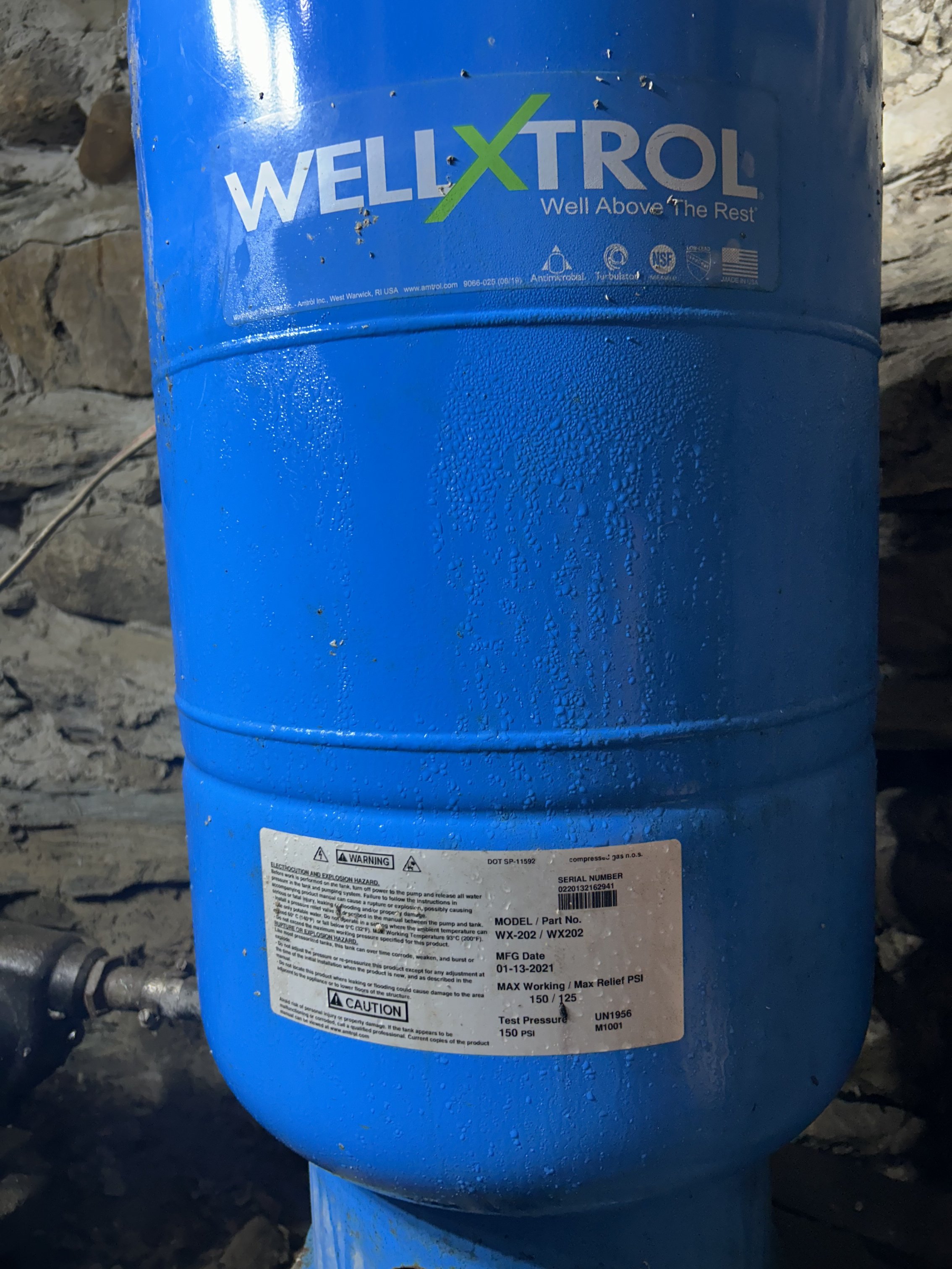

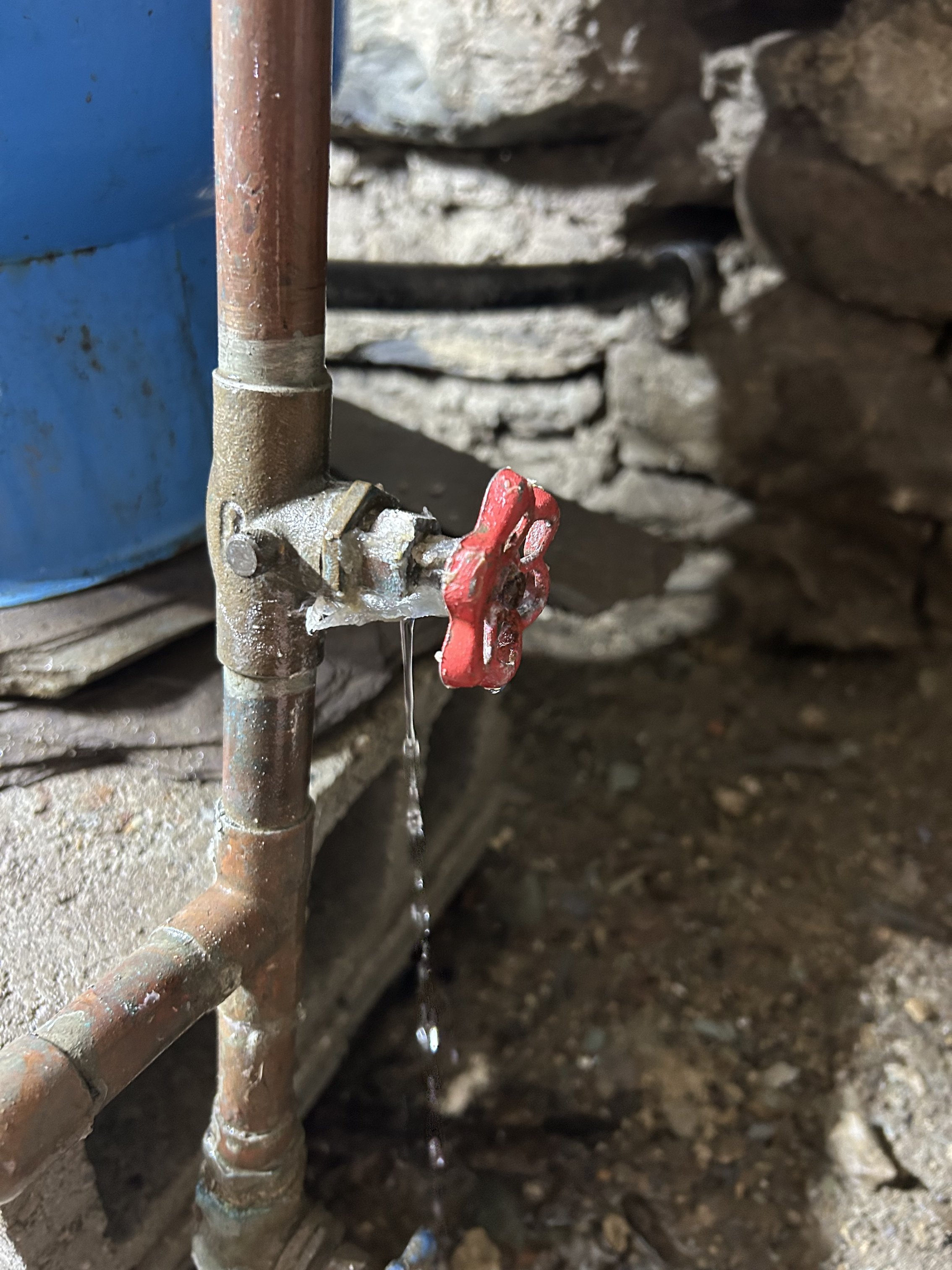

not sure what to buy to replace this leaking valve. Any help would be appreciated!

    mattmia2 Member Posts: 17,906
    String packing. Or possibly just a crescent wrench.

    Jamie Hall Member Posts: 27,699
    This ^^^^^. Before you go to the trouble of replacing it, which would be a bore, try fixing it — which might take a few minutes…

    Intplm. Member Posts: 3,131
    Or, you can tighten the packing nut. It's located just below the valve handle and surrounds the valve stem. The nut has the flats on it for wrench tightening.
    If that doesn't work, repacking the valve as mentioned above would be next. And if that doesnt work, a good quality ball valve should be the replacement.

    Psmith77 Member Posts: 3
    I looked closer, and there is a splice in the little area (copper tube) right before the valve. Looks like a replacement is necessary. Tried some sealant and it just wouldn’t hold.
  • Psmith77
    I believe the nut is what is split? But have someone coming to check it out.
