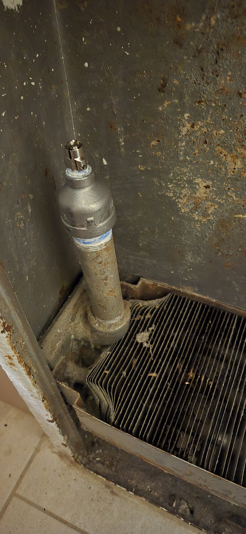

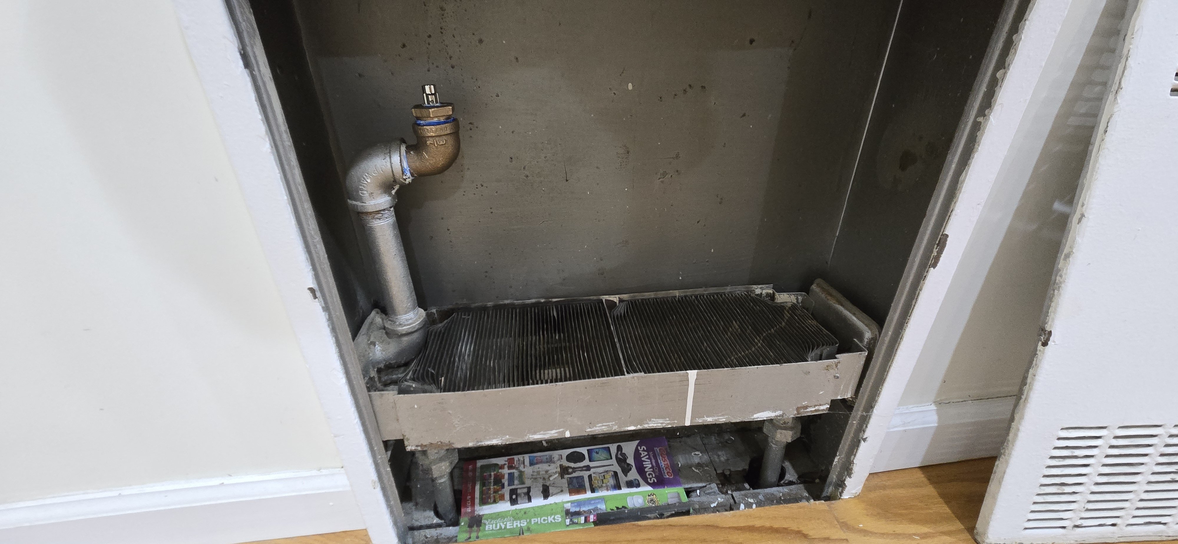

Moved into a new house in NY. The heat is hydronic gas boiler. The bottom piece im assuming comes in on one side and out on the other. Why does the top do?? Doesn't seem to have a flow path.
    EdTheHeaterMan Member Posts: 12,543
    I can see no purpose to that extension from the location where there should be a vent of some kind of vent to expel air from the convector. You may find it in a circa 1950s popular mechanics magazine, when there were many innovative ideas. But I can see no benefit.

    EBEBRATT-Ed Member Posts: 20,554
    Weird. The 3 pipes were originally put there for some reason. Is there another tapping on the right-hand side of the original convector?
    mattmia2 Member Posts: 17,571
    I don't even see where much of any water is going to get in that contraption

    Will this be the correct fix? Remove the top baseboard and add an 1/8" bleeder.
    Is the automatic bleeder reliable ? Or stick with the manual one ?
    Thanks again for all the responses.
    Mad Dog_2EdTheHeaterMan
    I would use a manual bleeder. Less likely to leak in an area where they are not visible

    It does heat when I tested it, not sure how well. I checked out rest of the house and found all upstairs to have the same set up except that some have manual bleeders in addition to the non circulating loop, and some dont. Some have manual bleeders, some have saddle valves installed for bleeding , and some have none. Im going to remove them all and just stall manual bleeders.
    If they have a way to bleed them, they will heat some through convection of the water but they will do little to add to the output of the convector.
    HVACNUT Member Posts: 7,539
    There's enough room to pipe in a 3/4 ball valve, then a 3/4 x 1/8 coupling, and an 1/8" Hy-vent.

    The third pipe is connectconnected to the convector, meant for bleeding im sure. The boiler is about 10 years old, Williamson 105k. Its a typical setup , expansion tank , hy vent , coming off the boiler. Pretty sure someone, definitely not an expert, at one point attempted to get more heat out of convectors. Out of the 10 units , 2 have saddle valves piecered in the pipe for venting , 3 have coin bleeders , and the rewt dont have a way to bleed at all.
    The the cover is slotted at the bottom and the top to allow for air movement.
    I Ordered the fittings and manual bleeders , so arrive tomorrow.

    The OP confirmed the 3rd pipe is the vent. How many times do you see a vent that big? All it needs is an 1/8" coin vent.
    I think that convector element has tapings to feed it from the top or bottom or connect in a loop or feed as 1 or 2 pipe steam so it has several taping that can be used different ways for feed or reduced for a bleeder or steam vent.

    There are thousands of homes on Long Island with that type of convector on mono flo systems that have a 3/4 tap for bleeding. I don't remember who made the original bleeders, but they looked like brass rockets. About 4 or 5 inches tall.
    I have to admit, I never saw one where the tap was on a vertical, so it is deceiving. A pic from another angle would show it better.

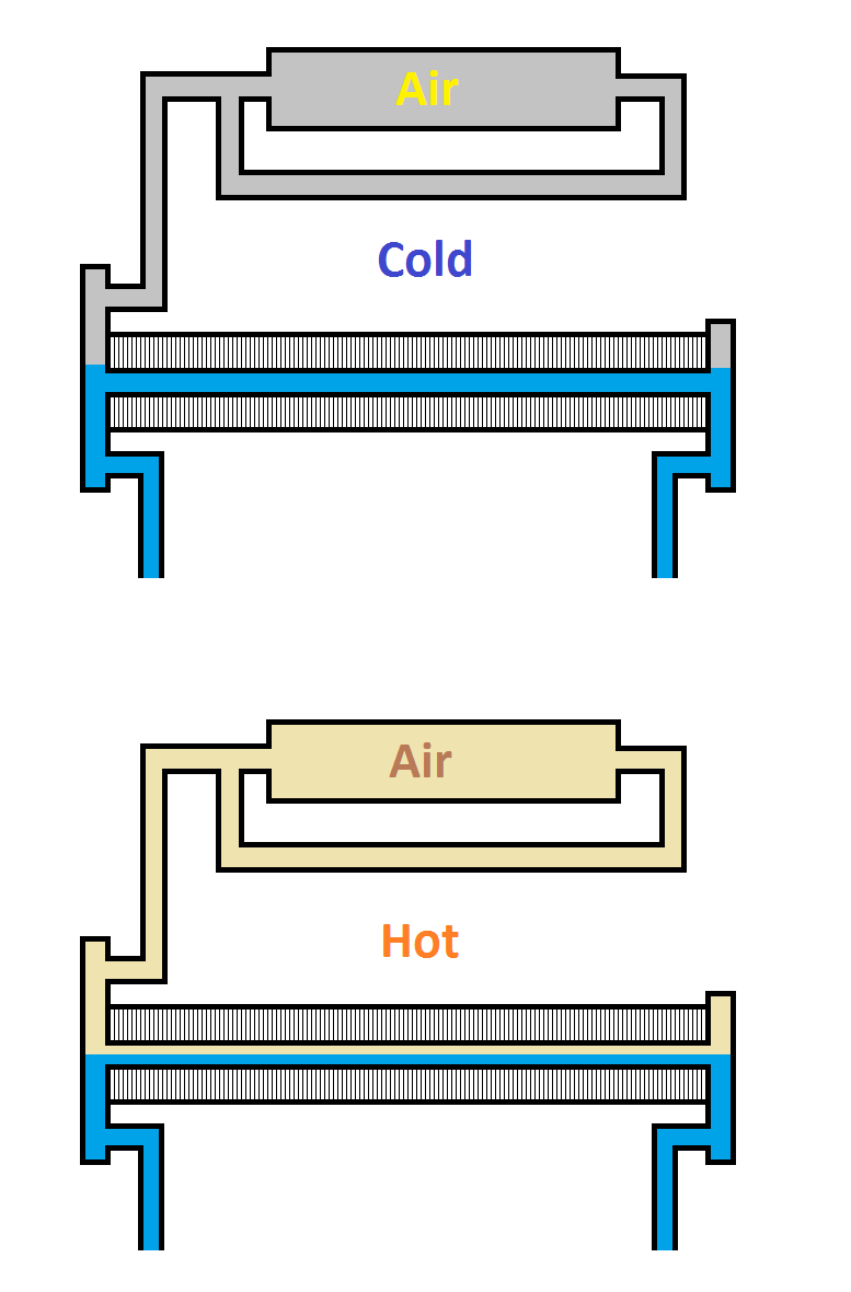

    As I alluded to before, I believe it was an attempt to reduce or limit the heat output, not enhance the heat output. Did the home have gravity or coal fired heat at one time ?
    As illustrated below when the upper air chamber is cold the convector has full flow, when heated up the air expands entering the convector coil, thus reducing the volume of water that could pass through the convector coil, limiting the heat. Whether this worked well or not, I have no idea, apparently the concept never gained any traction.
    109A_5 Member Posts: 4,228
    If it actually works as I illustrated I would have built it so it could not trap water like it would now. The Copper pipe over the aluminum finned air bound section.

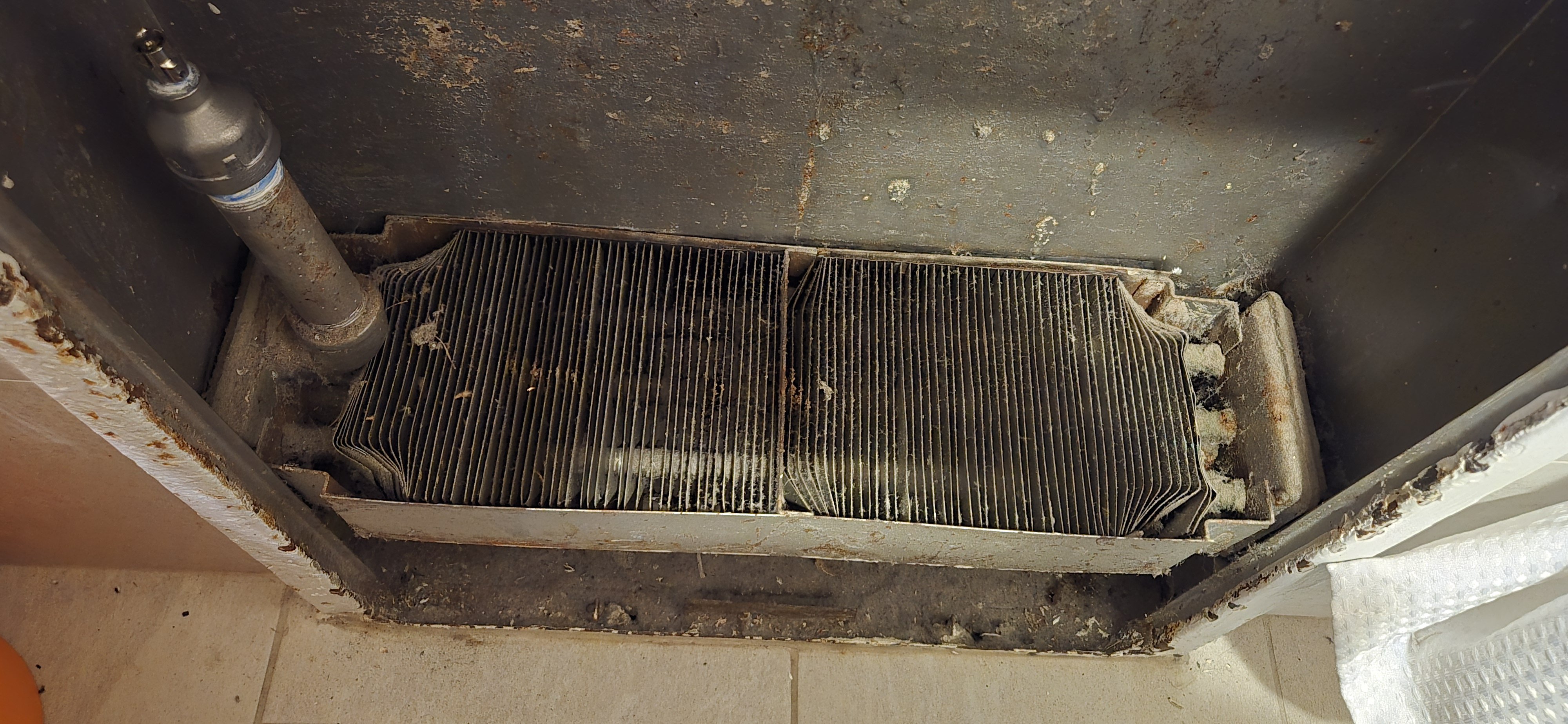

    All 11 convector heaters had their top section removed and replaced with just an 1/8 coin bleeder. I was able to bleed air from all of them and they all heated up nicely.
    Again , out of the 11 of them. Some had coin bleeders on the top loop, some had saddle valves installed, and some had neither. Very very strange.
    mattmia2HVACNUT
    Might want to seal up those holes in the floor so it pulls air from the room instead of from under the floor. Use foam or something around the pipes so they can move.
