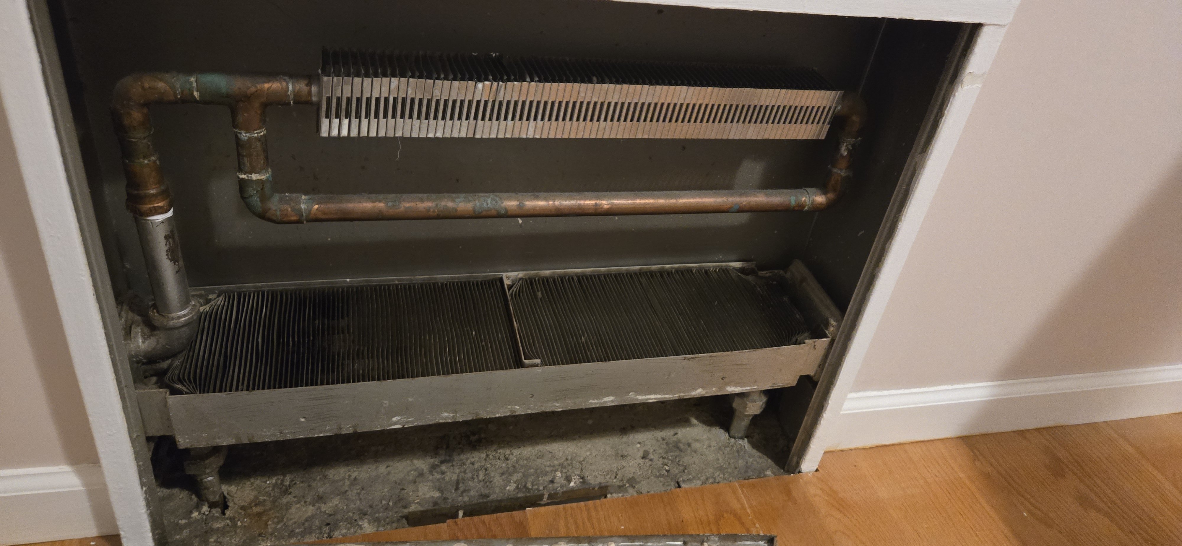

Moved into a new house in NY. The heat is hydronic gas boiler. The bottom piece im assuming comes in on one side and out on the other. Why does the top do?? Doesn't seem to have a flow path.
    I can see no purpose to that extension from the location where there should be a vent of some kind of vent to expel air from the convector. You may find it in a circa 1950s popular mechanics magazine, when there were many innovative ideas. But I can see no benefit.
    Mad Dog_2
    109A_5 Member Posts: 4,346
    Is it known where the third pipe goes to ? Could the slight internal pressure change of heating the upper part modulate the water flow through the lower part ?
  • DanHolohan
    DanHolohan Member, Moderator, Administrator Posts: 16,732
    I would say it was someone’s useless attempt to get more heat out of that unit.

    Don't even see a bleeder vent. Mad Dog
    HVACNUT Member Posts: 7,613
    It looks like the air eliminator was eliminated.
    mattmia2Mad Dog_2EdTheHeaterMan
    hot_rod Member Posts: 28,078
    That added loop probably emits a small amount just from convection.
    Unless we don't see another piping connection, I don't see it actually circulating through?
    Mad Dog_2
    Weird. The 3 pipes were originally put there for some reason. Is there another tapping on the right-hand side of the original convector?
    mattmia2 Member Posts: 17,905
    I don't even see where much of any water is going to get in that contraption

    Will this be the correct fix? Remove the top baseboard and add an 1/8" bleeder.
    Is the automatic bleeder reliable ? Or stick with the manual one ?
    Thanks again for all the responses.
    I would use a manual bleeder. Less likely to leak in an area where they are not visible
    mattmia2HVACNUT
    Does this unit not heat ?
    Maybe when the tapped air in the upper part expands it adds air to the convector coil, so the heat output is self limited. I'd leave it alone if it is not leaking.
    If you need more heat from that unit you could remove upper part and and add a manual air bleeder. You may get more heat from it since you can get more air out.

    It does heat when I tested it, not sure how well. I checked out rest of the house and found all upstairs to have the same set up except that some have manual bleeders in addition to the non circulating loop, and some dont. Some have manual bleeders, some have saddle valves installed for bleeding , and some have none. Im going to remove them all and just stall manual bleeders.
    If they have a way to bleed them, they will heat some through convection of the water but they will do little to add to the output of the convector.
    There's enough room to pipe in a 3/4 ball valve, then a 3/4 x 1/8 coupling, and an 1/8" Hy-vent.

    The third pipe is connectconnected to the convector, meant for bleeding im sure. The boiler is about 10 years old, Williamson 105k. Its a typical setup , expansion tank , hy vent , coming off the boiler. Pretty sure someone, definitely not an expert, at one point attempted to get more heat out of convectors. Out of the 10 units , 2 have saddle valves piecered in the pipe for venting , 3 have coin bleeders , and the rewt dont have a way to bleed at all.
    The the cover is slotted at the bottom and the top to allow for air movement.
    I Ordered the fittings and manual bleeders , so arrive tomorrow.

    The OP confirmed the 3rd pipe is the vent. How many times do you see a vent that big? All it needs is an 1/8" coin vent.
    I think that convector element has tapings to feed it from the top or bottom or connect in a loop or feed as 1 or 2 pipe steam so it has several taping that can be used different ways for feed or reduced for a bleeder or steam vent.
    Since the unique tapping is only at one end and on top and the supply and return is from underneath I still think it is a self metering method. It seems deliberately made that way.
    It's not like trapped air that needs bleeding like with a typical vertical CI radiator.
    There are thousands of homes on Long Island with that type of convector on mono flo systems that have a 3/4 tap for bleeding. I don't remember who made the original bleeders, but they looked like brass rockets. About 4 or 5 inches tall.
    I have to admit, I never saw one where the tap was on a vertical, so it is deceiving. A pic from another angle would show it better.

    As I alluded to before, I believe it was an attempt to reduce or limit the heat output, not enhance the heat output. Did the home have gravity or coal fired heat at one time ?
    As illustrated below when the upper air chamber is cold the convector has full flow, when heated up the air expands entering the convector coil, thus reducing the volume of water that could pass through the convector coil, limiting the heat. Whether this worked well or not, I have no idea, apparently the concept never gained any traction.

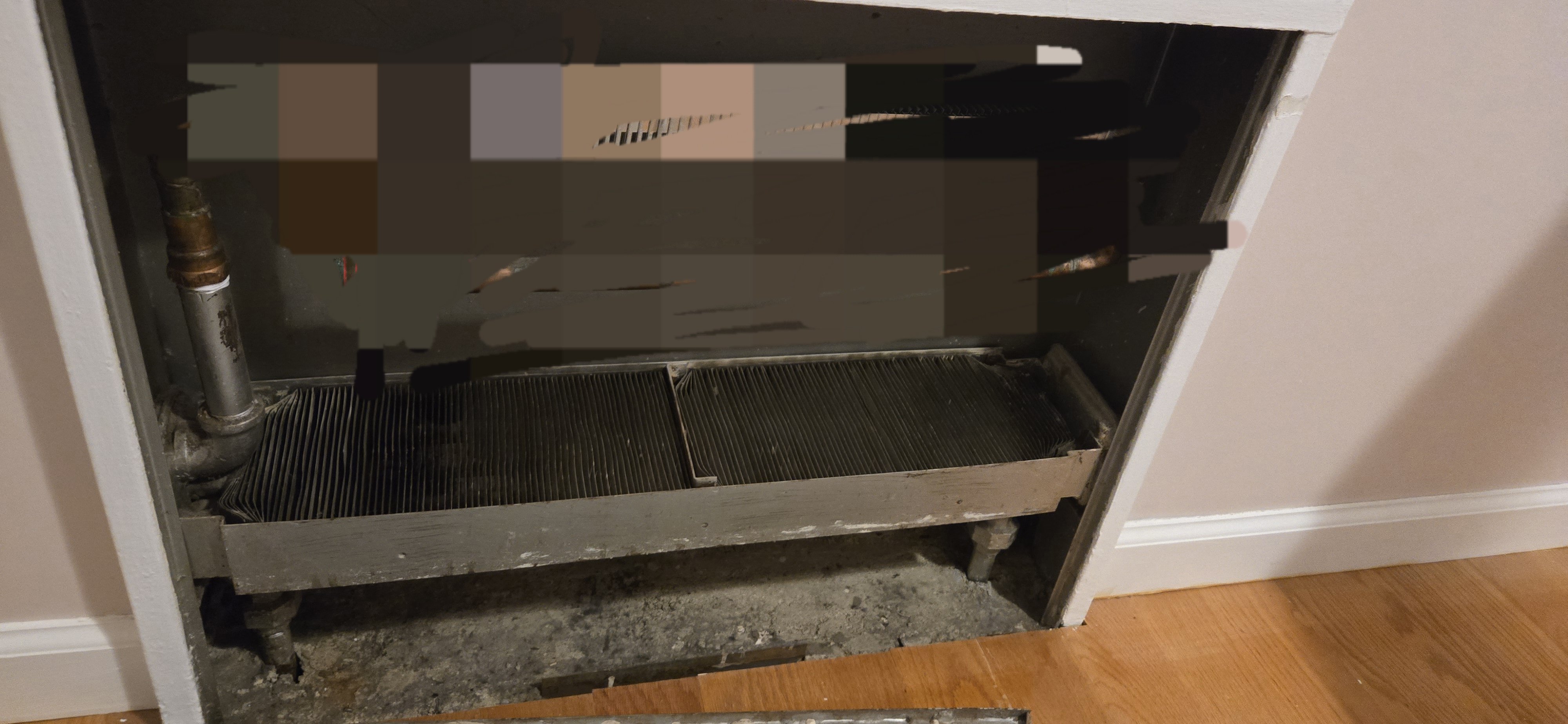

    All 11 convector heaters had their top section removed and replaced with just an 1/8 coin bleeder. I was able to bleed air from all of them and they all heated up nicely.
    Again , out of the 11 of them. Some had coin bleeders on the top loop, some had saddle valves installed, and some had neither. Very very strange.
