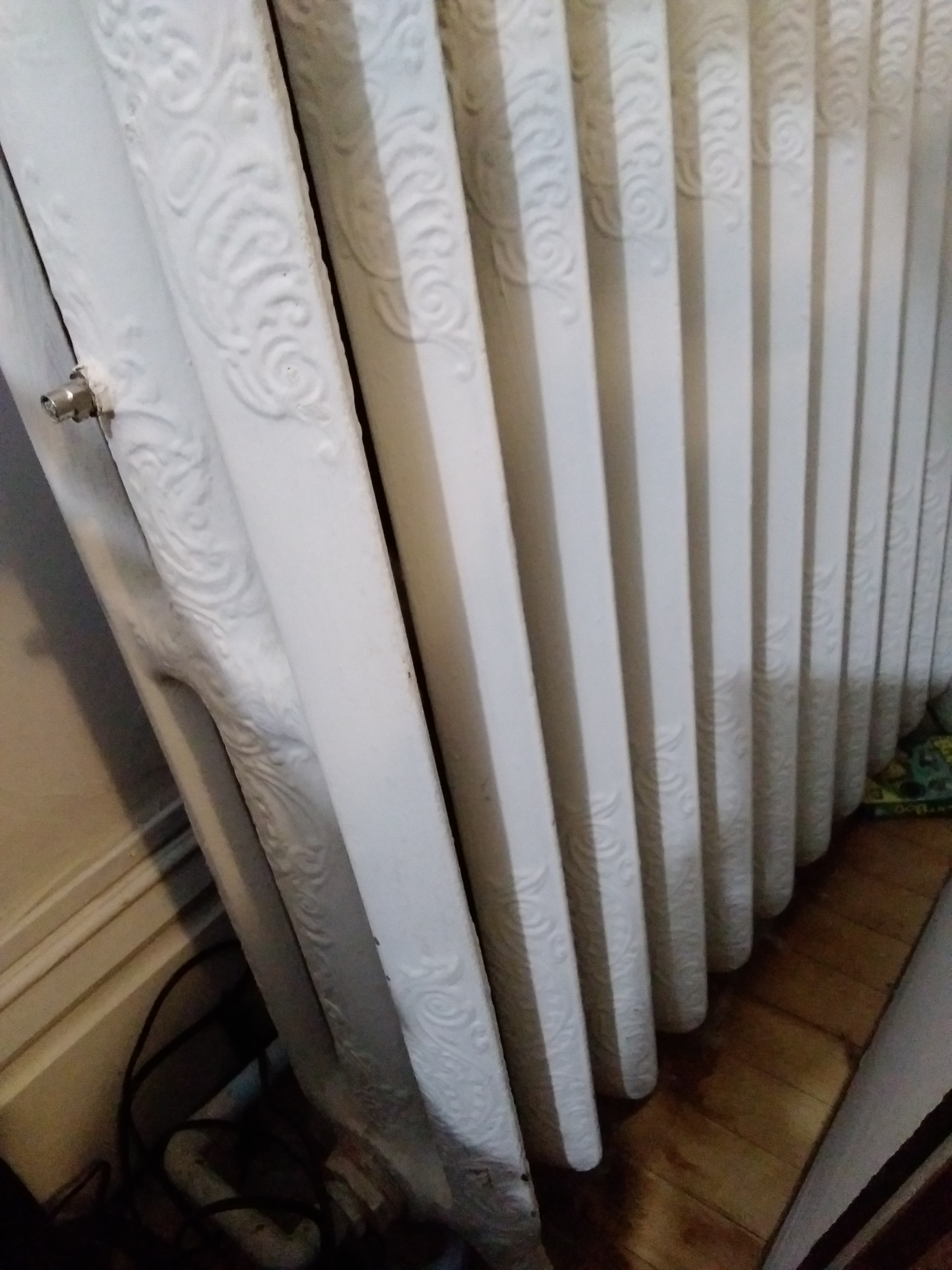

Studied all the charts and tables but still need help. This is an old cast iron radiator about 3 ft high. It has three columns and is about 9 inches wide. On one end, about 2 ft up, is a bleeder screw. There are 12 'sections?' along the length of about 30 inchs. Assuming 160 F degree water, what is a good estimate of btu/hr that can be emitted if this radiator is half full of water? I beleive its an old steam radiator…when I try to bleed out air, it fills to the level of the screw and water comes out, so cant fill it any higher by myself? The bottom of this radiator gets quite warm but never so hot that I cant hold my hand on it. Its at the end of the return line. I hope this is enough info. If you want a pic, I can do that. Its a big heavy old one, kinda cool.

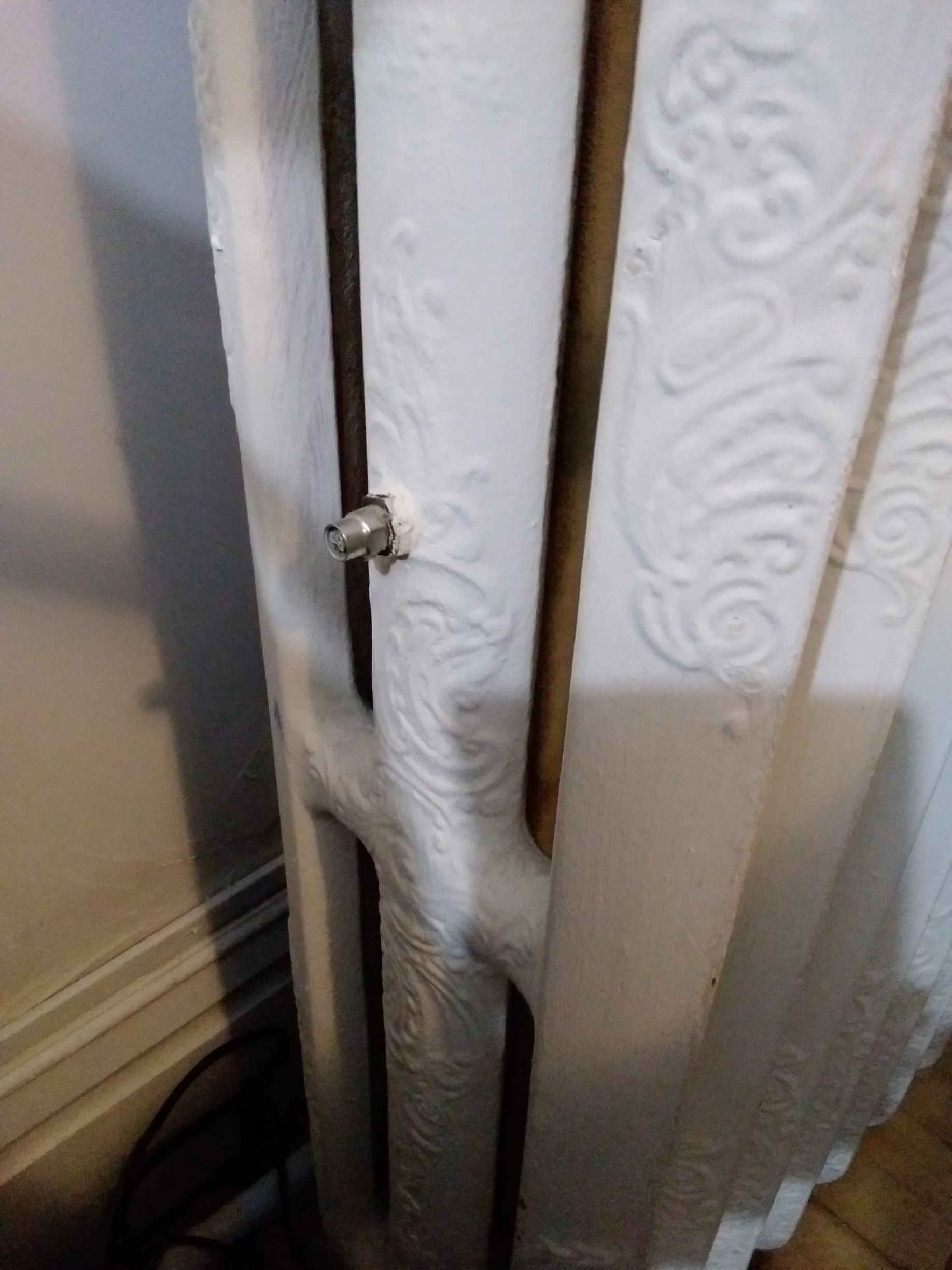

    there should be a low tapping for a steam vent and a high tapping for a hot water bleeder.

    Definitely sounds like a steamer. Post a pic from the front and the side where the bleeder is, and we'll have a look.

    Nope, sorry, somebody put only one bleeder screw on the side. No more at the top. I dont have that many hydronic baseboards on this loop, I am just wondering if this radiator emits more btu per foot of length just in case I replace it with baseboards. Thank u
    mattmia2 Member Posts: 17,208
    the output of a radiator is far more than a couple feet of cast iron baseboard. if the radiator is connected at the top so that it is compatible with hot water, it should have a tapping near the top and a tapping about 2/3 of the way down. you plug the top tapping and use the lower tapping for steam, you plug the lower tapping and use the upper tapping for hot water.

    109A_5 Member Posts: 4,158
    Steam only radiators work poorly with hot water since the top of the sections are not connected together so air is trapped. The sections of the radiator pictured are connected at the top (Red Arrow) so it will work with either Steam or Hot water.
    One example, typical places for venting / air bleeding.

    being piped in copper that is not the original home of that radiator. that tapping is for the steam air vent. look for a probably slotted plug near the top.
    that is a common earlier radiator, others will know it. possibly an arco rococo. (arco is american radiator company, now american standard)

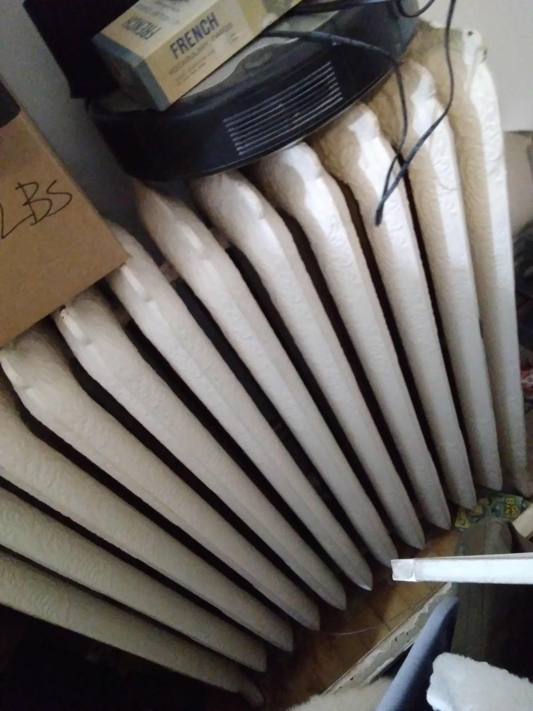

    That looks like a steam only radiator, the sections are not connected at the top. Even though you can bleed that end section to the bleed port level the rest of the radiator is probably mostly air bound.

    it was all the same picture when i looked at it earlier so i couldn't see the top. yeah, that radiator isn't compatible with hot water unless you drill and tap a bleeder in the top of each section. it is steam only.

    Looks like an American Rococo, and yes, it is steam-only. It cannot have been original to that system.
    Please do not desecrate it by drilling and tapping for bleeders on each section. You can probably arrange some sort of trade with someone who has a hot-water Rococo. That one you have is 60 square feet.

    it is more that most of it isn't filled. cast iron radiators that are filled with water but only have the bottom tapings used for the supply and return work fine because they heat by convection of the water in the columns.
    does the room heat adequately? what sort of baseboard does it share a circuit with, is it cast iron baseboard or fin tube?
    looks like someone that didn't know what they were doing tried to convert it from steam to hot water if the return is copper and the supply is black iron.
