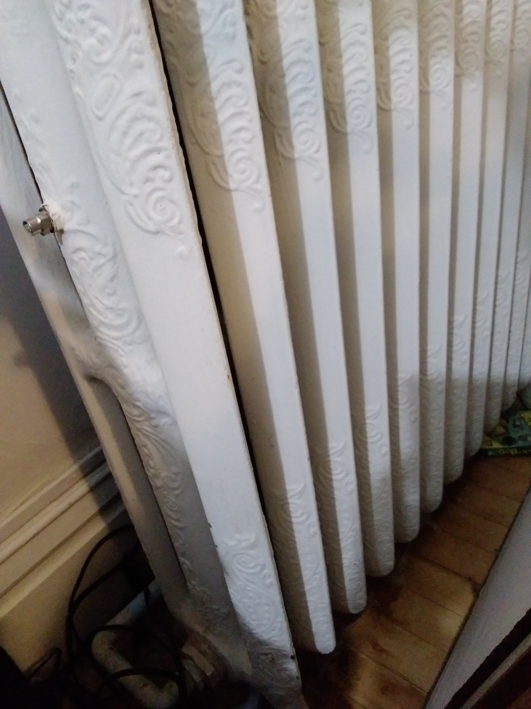

  • Nope, sorry, somebody put only one bleeder screw on the side. No more at the top. I dont have that many hydronic baseboards on this loop, I am just wondering if this radiator emits more btu per foot of length just in case I replace it with baseboards. Thank u
    the output of a radiator is far more than a couple feet of cast iron baseboard. if the radiator is connected at the top so that it is compatible with hot water, it should have a tapping near the top and a tapping about 2/3 of the way down. you plug the top tapping and use the lower tapping for steam, you plug the lower tapping and use the upper tapping for hot water.

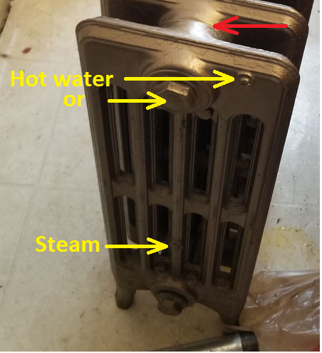

    Steam only radiators work poorly with hot water since the top of the sections are not connected together so air is trapped. The sections of the radiator pictured are connected at the top (Red Arrow) so it will work with either Steam or Hot water.
    One example, typical places for venting / air bleeding.

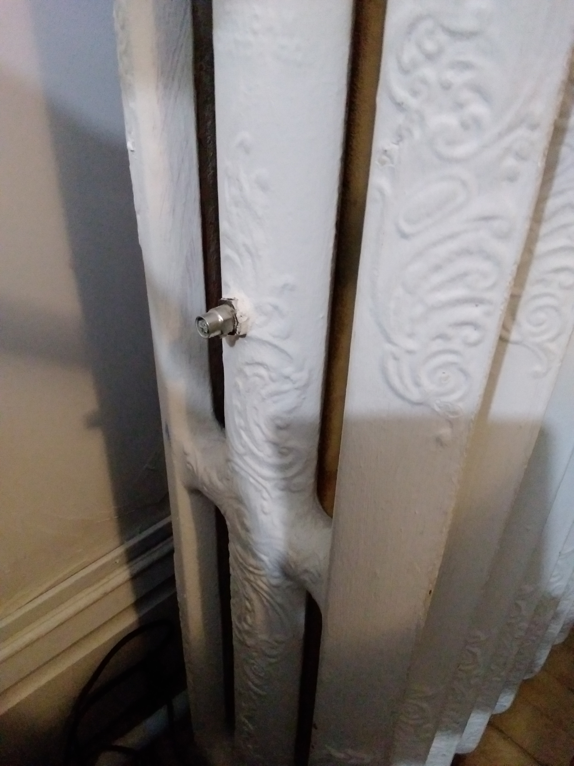

    being piped in copper that is not the original home of that radiator. that tapping is for the steam air vent. look for a probably slotted plug near the top.
    that is a common earlier radiator, others will know it. possibly an arco rococo. (arco is american radiator company, now american standard)

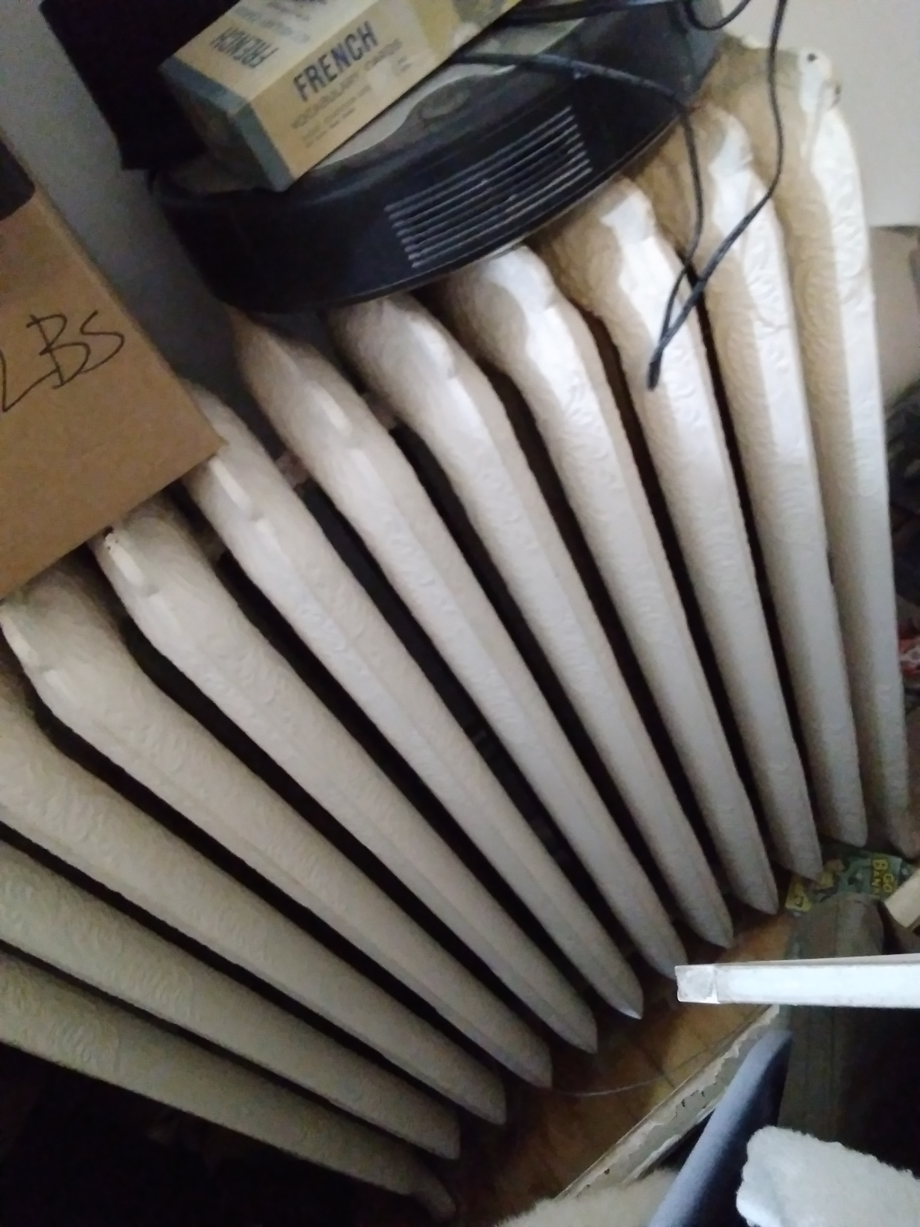

    That looks like a steam only radiator, the sections are not connected at the top. Even though you can bleed that end section to the bleed port level the rest of the radiator is probably mostly air bound.
  • The house was built around 1918. I doubt that radiator has ever left that room, I concur somebody attached some 3/4 copper piping later but it fits perfect in one spot. It does put out some heat, doesn't seem to be a way to fill it with water but will look again. No idea how old the radiator is, but thanks again!
    it was all the same picture when i looked at it earlier so i couldn't see the top. yeah, that radiator isn't compatible with hot water unless you drill and tap a bleeder in the top of each section. it is steam only.
