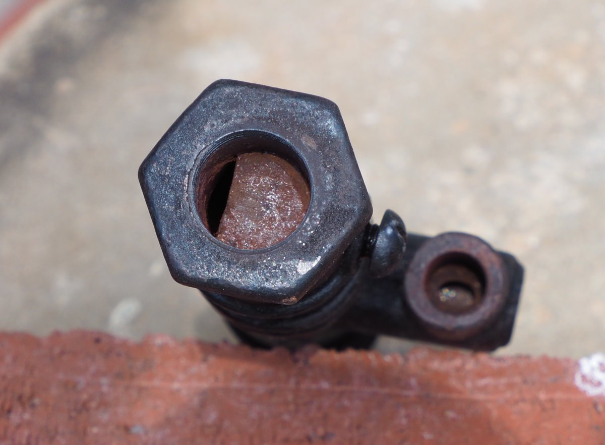

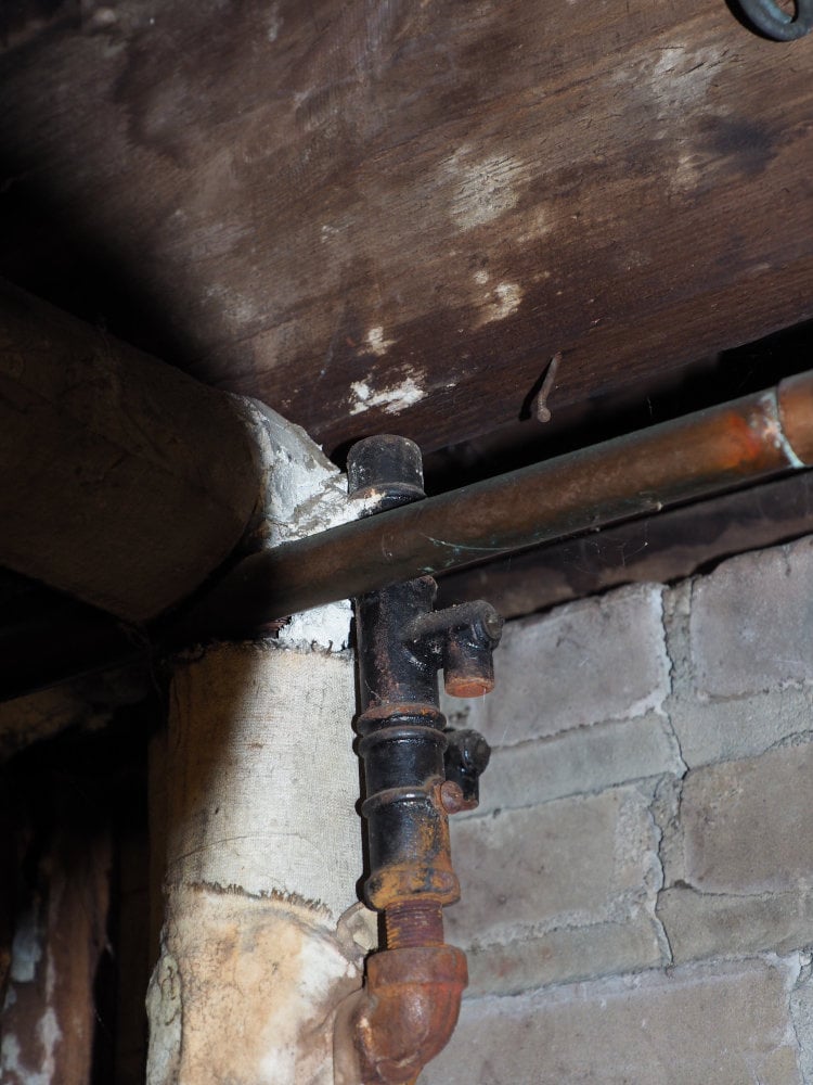

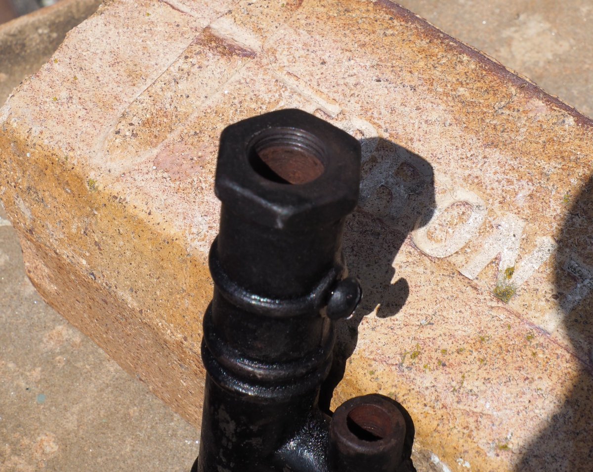

I would like to identify the vent found on my radiator returns. See pics below.
Note: in the first pic, the second bump is actually the L of a second vent behind the first.
EDIT: Found adjustment key
The vent has no identifying marks of any kind. It is 6" long. The bottom threaded hole is slightly more than a 1/4 NPT. The opening on the L is threaded. The L hole communicates with the bottom. However, on heating the vent, it did not close off air (perhaps broken). There is a rod and brass cap of the L; the rod has a threaded section, but sits loose in the inner hole. The the screw on the body is removed, the hole communicates with both the bottom and the L; when tightened, it is airtight. I hoped the body screw would loosen the inner parts; but it did not. It appears as if nothing more can be disassembled (but maybe there is a trick).
Some background on my system. It is an apparently uncommon 2-pipe system; each radiator has a separate runout from the main; each radiator has a separate return to the a common wet return near the floor of the basement; so, the returns do not communicate with each other; the radiators have generic supply valves (not indexable; no orifices); there are no traps at the radiator; there are vents at each radiator return, in the basement near the ceiling; all but two of the returns were updated with Hoffman 1A in the 1970s; the two remaining are as in the pics; there are no other vents or mechanical contraptions or special pipe arrangements, just the boiler.
The house was built in the 1910s; originally with a Pierce coal-fired boiler and radiators; a Kel-Mac vapor system is named in the blueprints. Circa 1924, the Pierce was replaced with a Bryant gas boiler. In 1997, it was replaced with a commodity Carrier (Dunkirk) gas boiler; existing near piping was unchanged.
System works well except for 2 of 20 radiators; one (furthest) rarely heats; the other (much closer to boiler), the supply pipe bangs a bit and radiator rarely heats. Neither have the old vent attached. Oddly, the two radiators with the old vent heat nicely.
I would also like to find more info on the Kel-Mac system. LAOSH only has a 1/2 page mention.
Thanks.
EDIT: Additional details

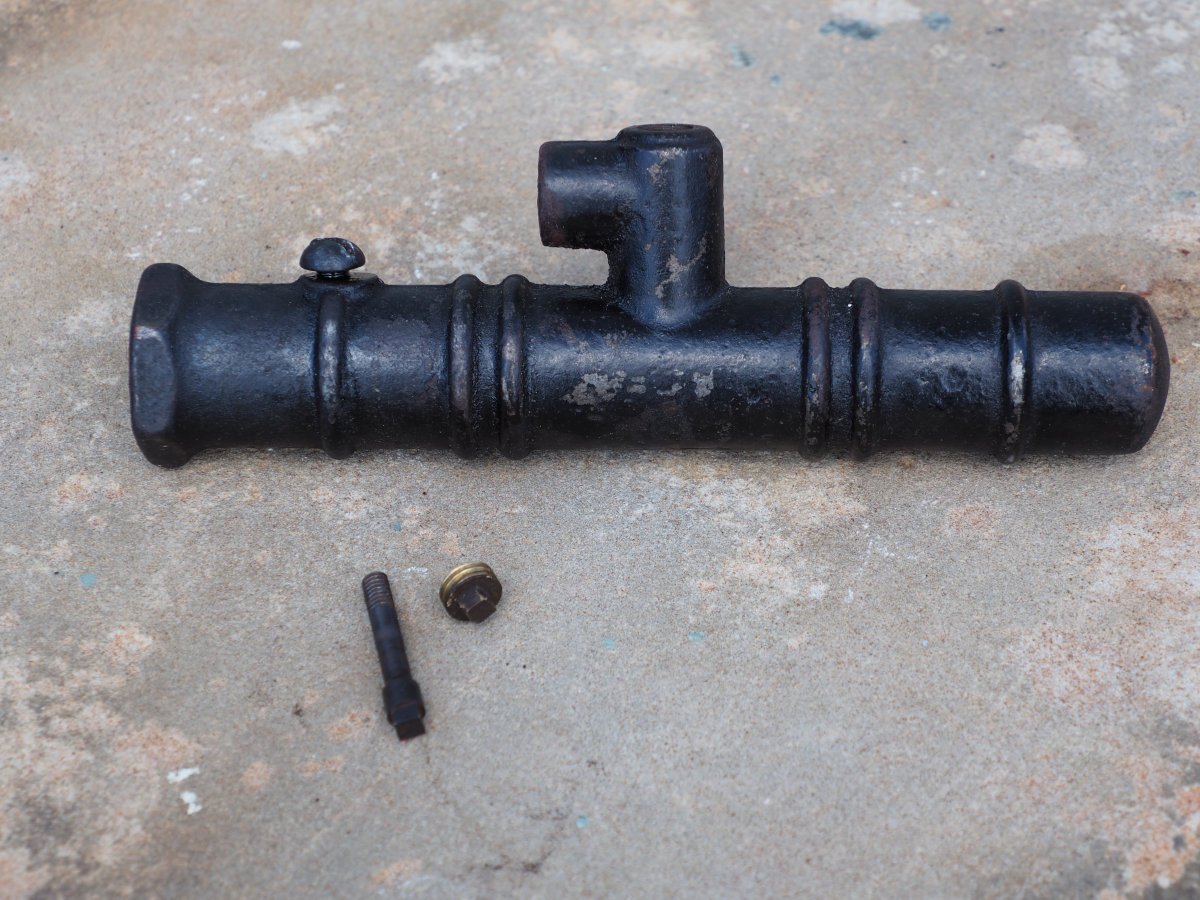

- The vent is "Breck" (Moses P. Breckenridge), may be his 1868 design (unconfirmed);
- Is thought to have a bi-metal component to actuate the valve.
- The bottom thread fits 3/8" NPT;
- The adjust screw in the "L" does screw into the inner hole (found original key for this);
- The "L" outlet thread fits 1/8" NPT (not confirmed if actually tapered hole);
- Heating the vent with a flame did not cause it to close (perhaps broken or rusted;
- Placed in acetic acid (5%) for 3 days; de-rusted very well;
- Re-tried heating test to cause valve to close; did not close;
- Still unable to disassemble;

If each radiators return is piped individually to a wet return then you need no traps. You should have an air vent large enough to vent the air from the supply run out through the radiator and the return line and the air vent should be located at the top of the riser where the return drops into the wet return
1 -
Since all the radiator condensate returns have their own vent and then drop down to a wet return, if there is not, a main vent at the far end of the steam main from the boiler may help. Also with the poor heating radiators and banging check the pipe pitch, there may be trapped condensate there.
" Oddly, the two radiators with the old vent heat nicely. " If it ain't broke don't fix it ???

@pacoit said- "The opening on the L is threaded"
My educated guess is this went to an air line that led to an ejector which pulled air from the system, similar to the Paul system. Or, it might have led to the chimney and used the draft to pull the air out, as in the Broomell and other systems.
Obviously, and regrettably, whatever was connected to this is long gone.
2 -
i think the system diagram has an air vent line. see the other thread.
@Steamhead said, "My educated guess is this went to an air line that led to an ejector"
That is my guess as well. The threaded L hole seems perfect for an air line fitting. As @mattmia2 mentioned, the blue prints detail one indirect radiator under the living room floor; the outlet tees off (may not have been literal) with condensate return on one side and a "KelMac retarder" with "air-line" on other side. The KelMac retarder (probably adjustable) might well be the vent above.

If I had to guess this screw is a calibration adjustment. When steam gets to it, it or what it screwed into expands to stops the steam from exiting the system, minimizing water consumption. It would not surprise me if it screwed into a bi-metal leaf spring.
The other slotted screw may have held the baffle assembly or the whole guts in place. The guts may be rusted in place now.

I haven't been able to disassemble the vent beyond what is shown in the pics. What looks like an adjustment screw now fits loosely in the inner hole that it probably once screwed into, but is now rusted away a bit. As to the body screw, nothing inside came out when I removed it. So far, I have hesitated to bang on it (other than some tapping) until I (hopefully) find some more information.
I thought my old vent may have been the KelMac retarder. Apparently, it is a different component. My system has no trace of radiator traps; the return elbows look as old as the radiators. There is also no trace of KelMac radiator supply valves. Mine are apparently generic globe type; they have a big spring inside; and they are identified with an "S" inside of a triangle. The simple round, smooth, hard rubber handles look old (possibly going back to the 1924 switch to a Bryant gas boiler—-gas had just arrived to the city).

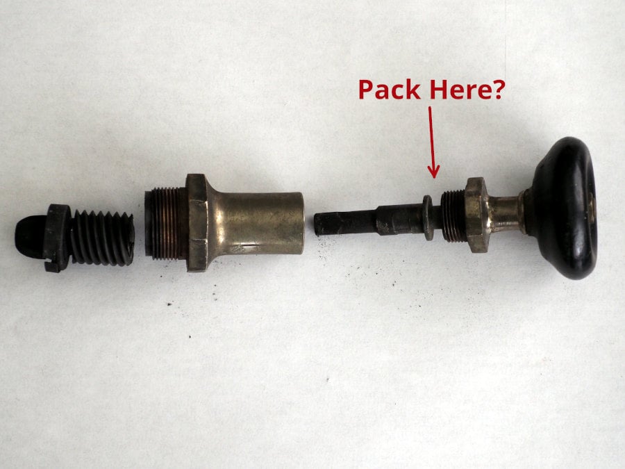

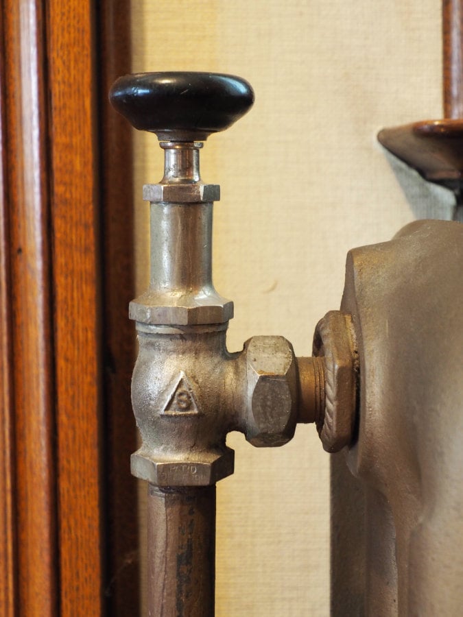

By the way, what is the proper way to repack these valves?
might be sylphon.
how to repack depends on the type of valve. some use a bonnet with a packing gland in it, more premium valves used a bellows or some other "packless" arrangement.

do you see packing in the bottom of the bonnet above that disc on the upper half of the stem?
it will probably be a lot easier to see what is going on if you take the handle off and take the bonnet off and it will be easier to replace the packing without the stem through it.
packing material frequently contained asbestos, frequently graphite coated, though it could be other fibers too.
It looks like it is a non-rising stem globe valve with conventional packing but it could be something else.
That's a "spring-packed" valve. ISTR the washer on the stem compresses the spring against the packing which is located underneath the spring. Replacement packing would look like a washer with a hole in it the size of the stem.
Also, the stem is non-rising and has no threads on it. It engages with the threaded portion at the left, which runs in threads inside the bonnet (or sometimes in the valve body) to open and close the valve. This puts less wear on the packing, and is one reason these valves last as long as they do.
Not sure what the S stands for though.

You could probably use string packing if you can't find a suitable packing washer although you might need to initially press it together with your hand and the stem on a table or some socket or pieces of pipe and a vise to pack the new packing together.
@mattmia2 , Yes, there was some tiny residue of packing on the top side of the disk (at arrow). I previously removed the handle; the screw cap slides out and there is nothing else.
@Steamhead , I didn't quite follow your description as to the washer position. You are correct that the stem is non-rising.
It appears to me that the packing/washer should fill the space at the arrow; the screw cap presses down from the top; and the spring in the "barrel" presses up against the the bottom of the disk. Is that correct?
@pacoit , it looks like there is a washer below and slightly left of the arrow that says "pack here?". It also might be part of a sleeve. That should be what compresses the spring. Is there any evidence of packing material below the spring?
@Steamhead , Ah, the "disk" just left of the arrow is a solid part of the stem; the spring presses up against it; cap screw and packing press down. The bottom of the (very stiff) spring is fixed in the "barrel". I see no evidence of, and no place for, packing below the spring.
My guess is that the spring provides a little flexibility so that the amount of packing doesn't have to be exact and still allow the screw cap to be screwed all the way in.
I found a small amount of thin string in one valve (at arrow location). I tried twisting 3 strands of that thicker blue thread tape to form a ~1/8" string. It worked on several valves, but one valve has failed twice despite heavy packing (I'm running roughly 0.5 psi air in the system to find leaks.).
the spring does come out, might have to twist it in the direction that makes it smaller to get it to move but you don't have to remove it. try some small string packing and try using a vise with some blocks of wood or a c clamp and wood, one with a hole in it to use that shoulder on the stem to pack the string packing together. i'd probably use teflon, once you get it in there it will last forever. if the stem is rough where the packing rides on it, polish it with fine scotchbrite. mcmaster carr sells spools of all sorts of string packing.
@mattmia2, Yes, the spring comes out; the bottom rests on a ledge in the "barrel".
Some valves I repacked apparently successfully; a few I packed and repacked harder but still leak. Interestingly, the existing good valves (not repacked) have a springy up/down motion when I press on the handle; the repacked one do not.
It's probably far-fetched, but I wonder if some springs have weakened, don't provide the push back/compression once the packing and screw cap are in place? Something seems amiss.
@mattmia2, I repacked several valves, today, following your suggestion, and used smooth parallel pliers to pack the thick teflon tape (formed into strings). The extra packing made the difference! All the valves appear to seal (tested with ~1 psi piping pressure, and then with digital audio recorder).
I also found a couple valves still packed (at the arrow in the pic of my earlier post). The packing was essentially dust. Anyway, it confirmed for me how to pack the valve.

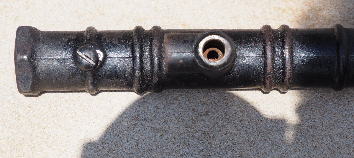

I also found a third vent in a drawer. The adjustment screw in the "L" is still screwed into its hole (hole not rusted out). The screw has a small square head; it's in a small space, and there must have been a special key to access it. Still have to try to de-rust and disassemble one of the vents.
Oh, my! Look what I found rummaging through an old drawer in the basement:
It's the key to the—-now verified—-Breckenridge vent regulation screw!!!
Folks, It may be the only one left in the world! Has impeccable provenance! Found with original identifying tag, and in the building where it was used! Last used by the current owner of 55 years! Step right up closer, folks. This item is now available for purchase for the first time in over 110 years! Now accepting bids of above… $1 million.

With the unit that has the messed up threads, if it can be nondestructive dissembled I wonder if the threads can be repaired with a Heli-Coil.

If it is that old it may not be a standard thread. If those are indeed bimetal steam air vents you are better off replacing them modern vents and keeping these vents as collectables. It may be designed to vent everything through these vents, they might be much larger capacity than modern radiator vents so the main can vent through the radiators. If that is the case your best bet is to add main vents. you could get a higher capacity by using a radiator steam trap but this system probably balanced better with coal than with a cycling gas or oil burner with the original vents.
Yeah, sadly the 'New Stuff ' does not play nicely with the vacuum agenda. If you have not, you may want to review how @PMJ runs his system, your returns may have to be modified or adapted.
" there are vents at each radiator return, in the basement near the ceiling; " This may work to your advantage, so the tapping are already there for a common venting and equalization system (since all returns drop down to a wet return).
Too bad you don't have all the original Breckenridge vents with the threaded vent ports.

FYI, the adjustment screw on the Breck is 4mm diameter with 32tpi threads.
@109A_5, The Brecks and the basement tappings suggest to me the system was in fact originally a vacuum system, probably actively controlled. I'd like to reproduce that—-if the piping proves tight enough.
