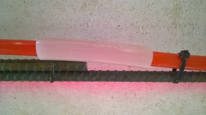

  4. pex running under control joints?
    1. take preventative measures: using conduit or pipe wraps where pex runs under control joints

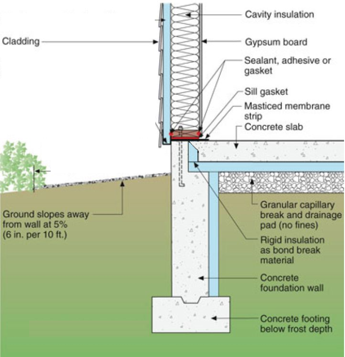

    1. I was thinking we should taper the top of the edge insulation
      1. similar to this diagram, though our sill is flush with the stem walls, and don’t think we would put insulation on edge below the bottom of slab (I am in climate 3)

    3. pex running under control joints? —-I think this would be best—-

    Ideally a control joint is 1/3 the slab thickness, which is not doable with tube. Best you could gamble would be a 1” deep cut if you have tube 2” below the top. But a crack will travel across a 1” cut. I’m not convinced any type of control joint is 100% able to prevent or stop a crack. It the tiny little cracks, called road mapping, that drive me crazy in finished slabs. Prepare your self for those.
    A troweled in joint will not look good at all. It would be a wide joint to caulk nicely?

    if you have a delta t of ~100f the edge insulation on the slab will be very important.

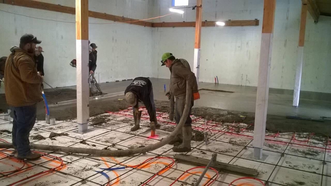

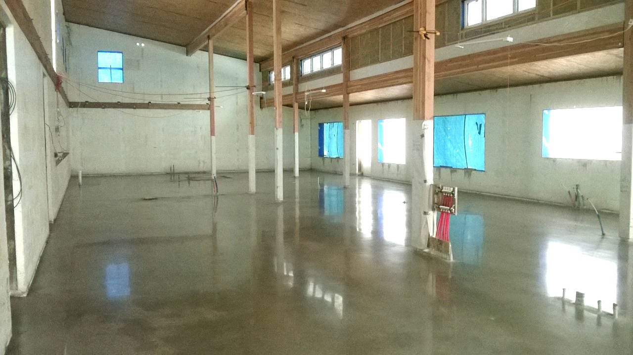

    Our new home has a polished concrete floor with radiant tubing. The walls are ICF so the foam provides a thermal break and expansion joint at the perimeter. The slab was poured on 3" of 25psi EPS foam for a thermal break to the ground below since we are in a northern climate. There is a 10 or 15 mil vapor barrier under the foam that was glued to the ICF perimeter wall and taped around all penetrations.
    We debated placing saw-cut control joints and placed the PEX as low as possible to allow this option. The tooled control joints filled with polyurethane at our local WalMart look pretty bad so we took a chance and didn't cut any control joints. The floor is about 80' x 35' with 9 embedded column bases. It was in the late fall so we poured concrete mixed with hot water, I think it was 3500psi, no fiber mesh. I can't remember if they added any plasticizer. It stayed warm and very humid inside as the concrete cured. We had some minor cracking but only where the slab was restrained. For example, at the doors there was rebar from the footings folded back into the slab along with rebar out to the thermally broken threshold so when the concrete shrank we got some small cracks at the corner of a couple of the doors. There are also two doors where the concrete continues into the garage and into a mechanical room. We have some cracks there where the slab was continuous. It would have been better to place a control joint in those doorways that would have been covered by the door threshold. Around the perimeter there are gaps up to 1/4" or more in some places due to concrete shrinkage but these will be covered by drywall and baseboards.

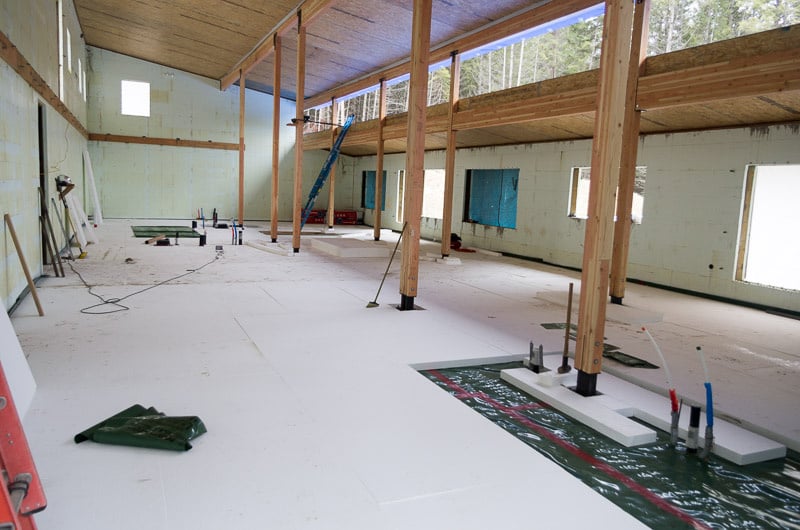

    Our initial plan was to use a mix with a larger black aggregate. This stone was crushed so they wanted a pump truck with a 3" hose. At the last minute we had to work with a smaller pump and they were afraid the larger crushed stone would jam it so we went with standard washed round stone, probably 3/4" if I recall. There is also a fair amount of smaller stone in the mix.
    They hand floated pads at the screed depth and then used a vibrating power screed. We had hoped so see more of the large rock exposed after polishing but the vibra screed pushed the rock too far down. It would have required a lot more polishing to expose it. As a result, there are areas with good rock exposure and other areas that are more of a uniform grey. We also have some 'interesting' bonus features caused by small twigs and other items that were blown into the sand and rock used to mix the concrete.
    The PEX was tied to a 2' grid of rebar. The rebar was placed on custom made 1" dobies to set it as low on the EPS foam as possible. The PEX was buried in the under slab foam from the manifold to the desired room in some cases. A 2" deep groove was cut with a hot knife, PEX inserted, the removed foam glued back in the groove above the PEX with spray foam and then trimmed flush. This same method was used to run 3/4" PEX to a central manifold. A piece of 3/4" PEX was slit and snapped over the 1/2" PEX in areas subject to damage. Buried PEX was brought up out of the foam in a piece of blue flexible conduit (smurf tubing). The entire system was pressurized to around 60psi before and during the concrete pour to make sure any damage was found and fixed.
    Overall we are pleased with the floor even though it is not perfect.
    Since the house is very thermally efficient it will not need much heat. The water to the floor will only need to be about 95F on our coldest design day of around 5F. The water temp is set by an LK outdoor reset on a mixing valve which seems to be working very well. In order to increase perceived comfort, the PEX was not placed on a continuous grid in most rooms. Instead, less PEX was placed in locations where people would most likely stand or be seated. This allows a higher water temperature in those localized areas so the concrete will hopefully be warm enough to feel the heat. I found a couple of articles online describing this approach. Here's a FLIR image taken as the system was initially warming up.
    We polished the floor before any of the interior framing was built. This lowered the cost of the polishing but requires extra care during the rest of the build. The densified concrete seems quite durable but as @DCContrarian pointed out, you can damage it and any repairs will be difficult and filled in cracks will show.

    Nice looking job, @OffGridICF . The main thing I would have done differently is to use fibre reinforced concrete and done control joints around known restraint locations — but what's done is done. The cracking you have will not improve, and you will need to live with it…
    Do you plan any additional floor covering? Just area rugs? No additional? ??

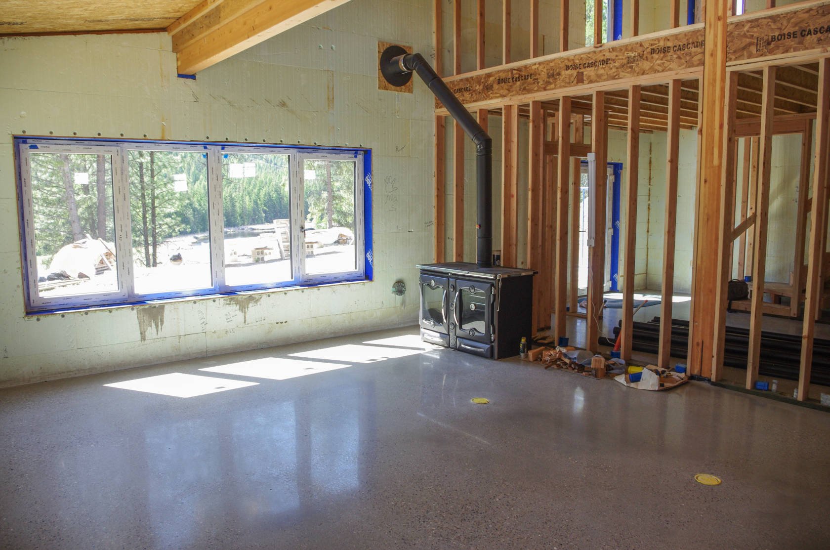

    Thanks @Jamie Hall, we will use area rugs where needed. I expect we'll have a few thicker cushioning mats in the kitchen. No additional floor covering is planned unless we end up hating the polished concrete.
    The floor is not perfect but the minimal cracking we have is acceptable. We talked about control joints and placed the PEX low enough to saw cut them. After getting a quote to cut and fill the 4' x 4' decorative grid we wanted we decided to take a chance and omit them. Most of the resulting cracks are too small to easily fill and not very noticeable. There are no cracks in the open floor areas, they are all off the corner of doors where the concrete was not able to shrink without cracking. Some will be covered by door mats while the worst are in the garage and mechanical room where it's not a big deal if they are visible. We skipped the fiber mesh to avoid possible issues when polishing the concrete. The biggest negative came from twigs and softer material in the concrete which caused flaws in the polished surface but even that isn't a big problem for us. I'm not sure how that could have been avoided with our local batch plant.
    The interior slab shrank up to 1/4" away from the ICF wall on two edges and that movement probably prevented cracking in the middle of the floor around the columns. The thermally broken thresholds for exterior doors seem to be effective when combined with adjacent PEX loops but the rebar across the break probably contributed to the cracking there.
    The upstairs areas will be heated with Jaga low-temp panel radiators on a separate ODR circuit. This seemed like a much simpler approach than PEX in between the floor joists and TRVs offer independent control in each room with a single water temperature. The total heat load averages about 5 BTU/sq-ft at the design temp of 8F so the combination of radiant slab and radiators should work with relatively low water temperatures. So far there is no drywall or interior insulation and the entire space stays at 65F with about 85-90F water holding the slab around 70-72F. Keeping 800 gallons of heat storage charged to run the floor only requires one firing per day of the Froling boiler. This should improve once the ERV is operating to reduce infiltration losses. So far I'm very pleased with how well the system is working and especially the power consumption since we're off grid with minimal winter sun for power.

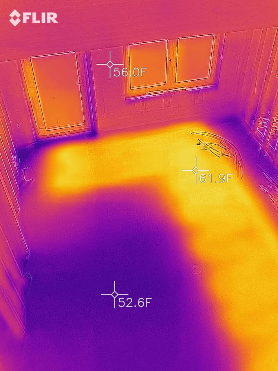

    I poured a shop slab this summer, still haven't turned on the radiant. It was a full 3 months before cracks started appearing. There is no rhyme or reason to how or when concrete cracks, from my years pouring concrete.
    The office in my last shop had colored concrete. We did saw control joints, but the tiny "road map" cracks traveled right through the control joints. It had remesh and fiber mesh added to the pour, foam expansion around the entire slab.
    Also all the saw cuts were grey as you cut through the aggregate that is not colored all the way thru. So we grouted the control joints with a soft acrylic caulk.
    The slab may expand as it is heated and close some of the edge gaps. But maybe you will never see that if sheetrock and base trim covers it.
