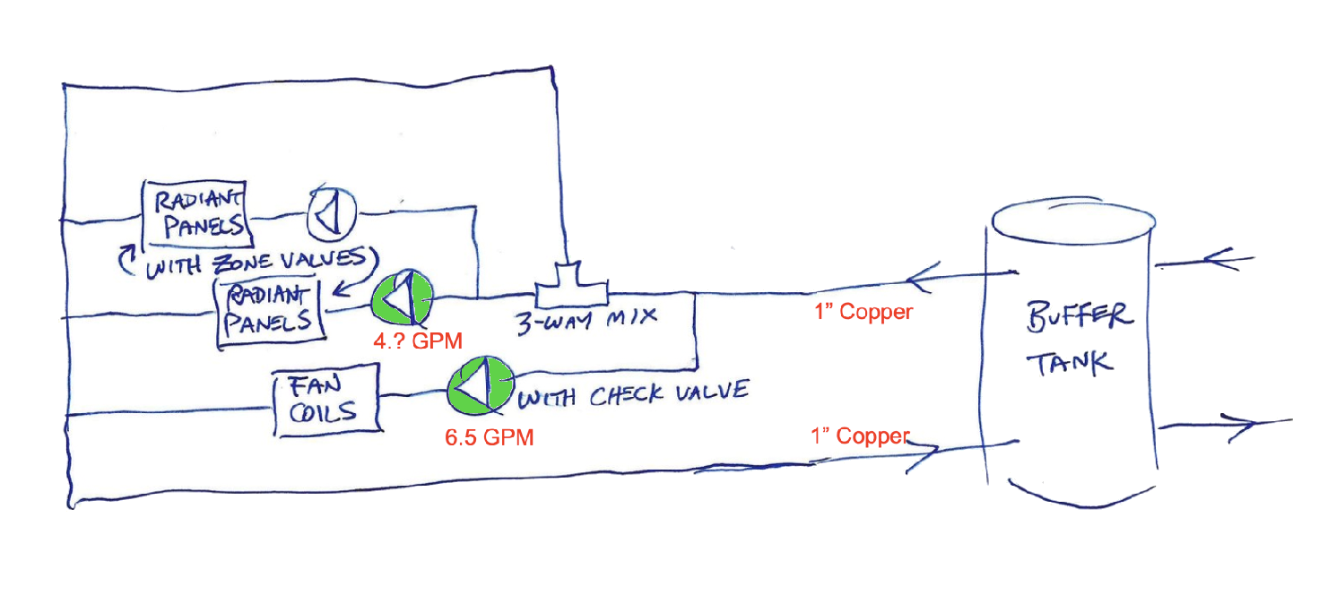

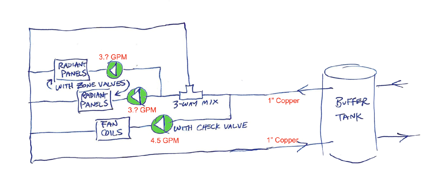

I recently installed 3 Grundfos Alpha pumps in parallel. I noticed upon commissioning, that when 1 pump is running, it's pumping at 9 GPM. When the other 2 pumps come on, it drops to 6.5 GPM. Likewise, the 1 pump will also interfere with the other two. I'd like to keep all the pumps running at the higher GPM's. Have all my ECM pumps piped in parallel been acting that way and I just didn't notice? Is there a way to deal with this?
    mattmia2 Member Posts: 15,961
    what do you mean by "in parallel"? are they actually in parallel or are they on a manifold feeding different zones?

    To put in picture form, you can get 9 GPM from all three pumps if you have the correct piping sizes.

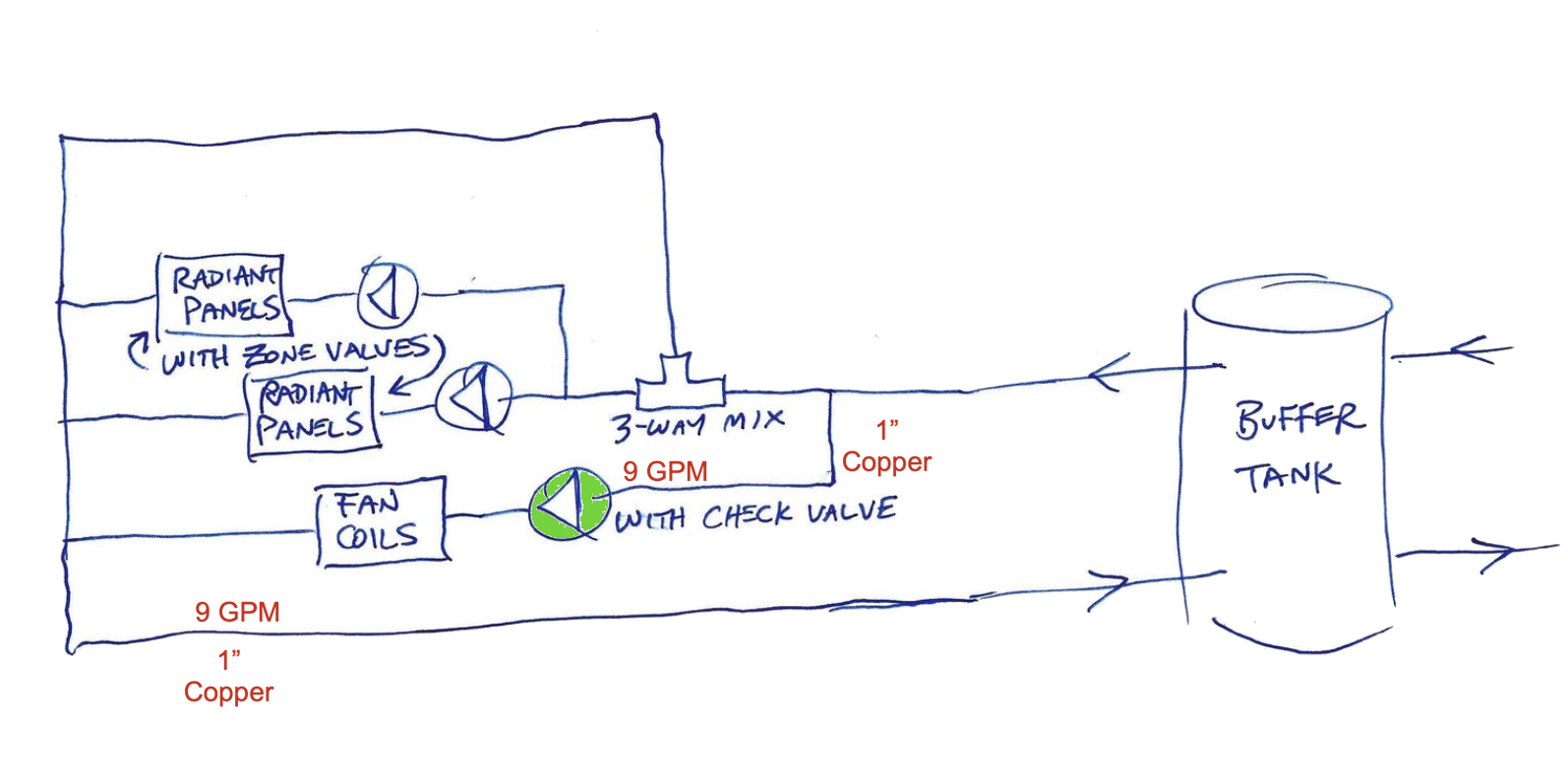

    With only one pump operating at 9 GPM you can use 1" copper and get all the flow you need. That is because 9 GPM can move freely and relatively noise free thru 1" copper. But 9 GPM is about the maximum you can fit in a 1" Copper pipe. more than that and the system will get noisy. (8 GPM is the recommended max flow for 1" Copper)

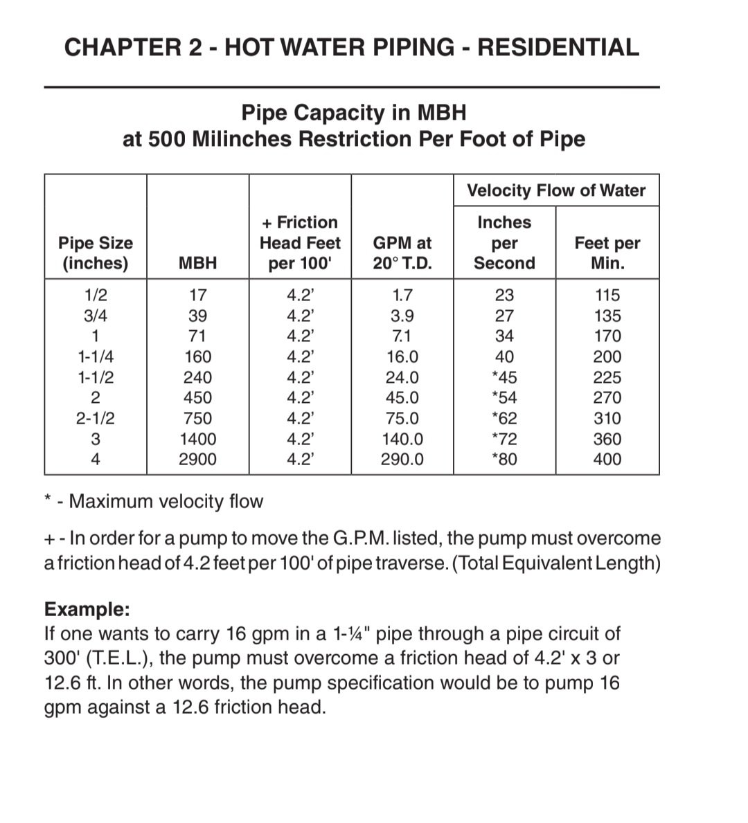

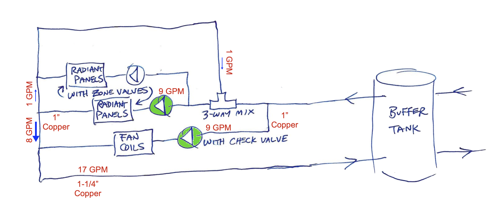

    The problem happens when you try to move 18 GPM thru 1" copper. There is not enough room. So your original design needs to have 1-1/4" copper in order to accommodate the flow from 2 pumps. Even if some of the return water from the radiant loop goes back to the mixing valve there is still the chance that the return to the boiler will
    overwhelm the 1" return to the boiler or buffer tank.

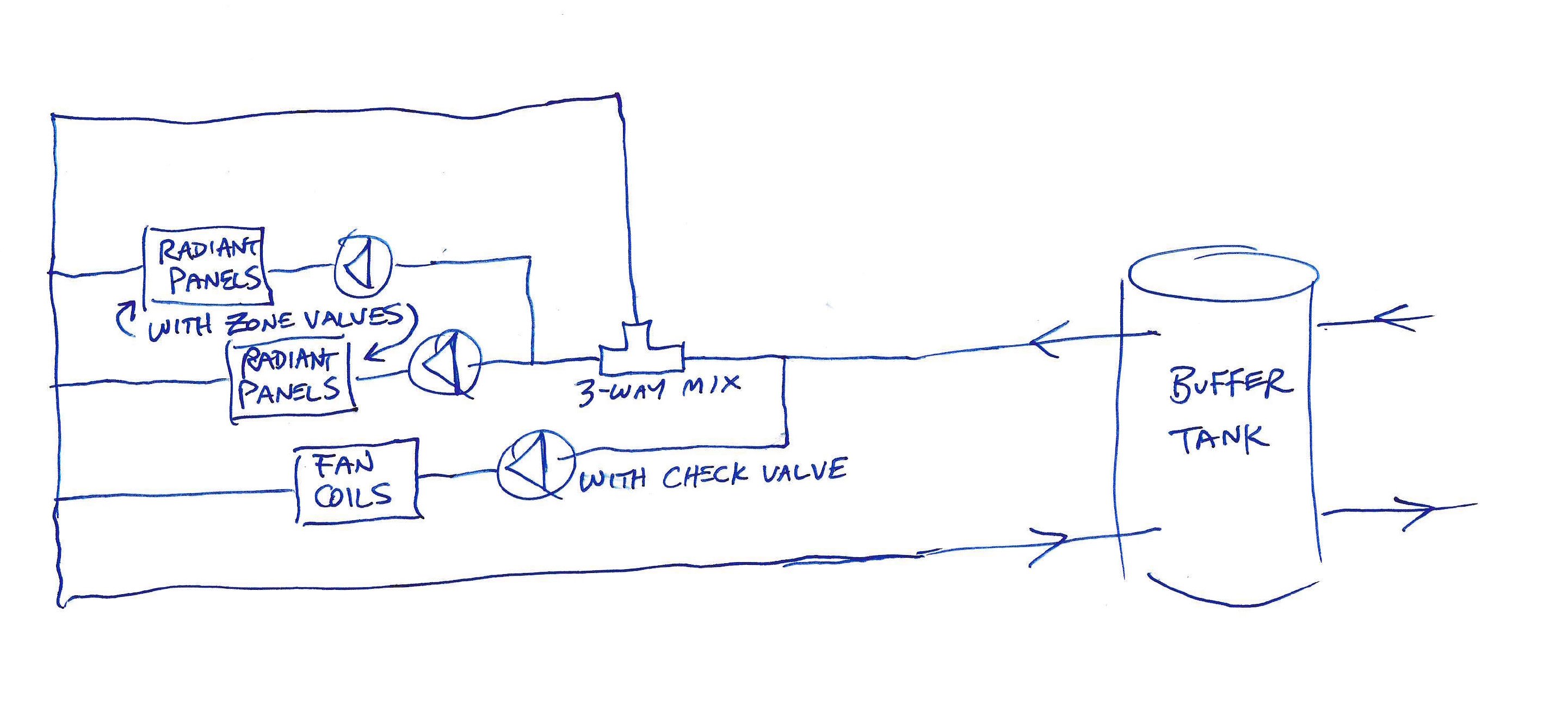

    When you add a third pump, now you need to increase to 1-1/2" copper to accommodate 27 GPM in the shared piping.
    With 1" Copper shared piping, when more than one circulator pump is operating the pumps need to operate against a greater pressure drop or Pump Head as more water needs to move thru. the same space. So the pump curve will move from 9 GPM each, down to something lower, like 6.5 GPM as the other pump fights more friction from the mixing valve, radiant floor tubing, manifolds and the like. So pumps of equal capacity will move different GPM based on the friction loss of the zone it is operating.

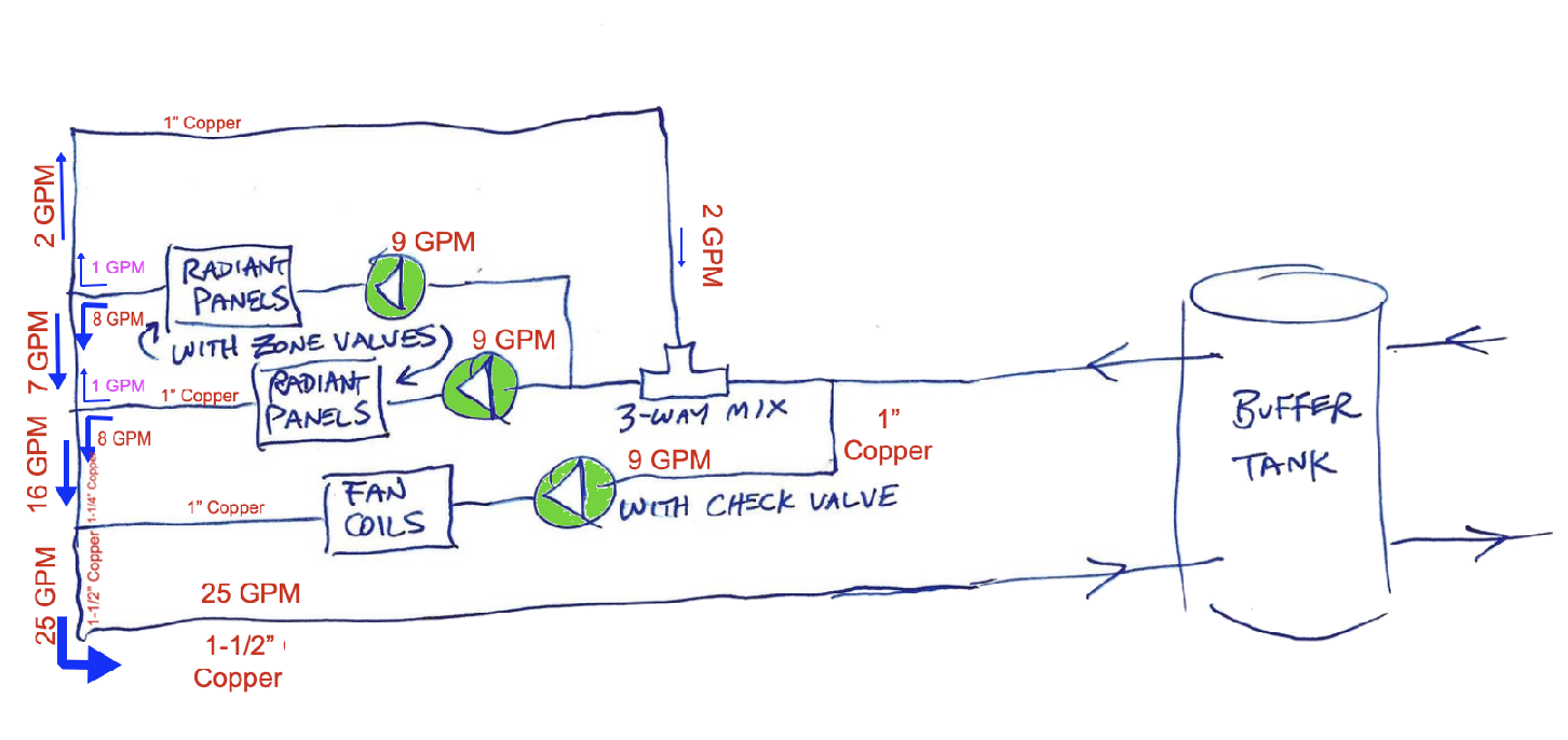

    With all three pumps operating on smaller common piping, you will get even lower GPM from each pump. Designing piping systems you need to take into account the sahred piping and the flow rate under the worst case. All pumps operating at full capacity at the same time. If you don't take that into consideration, then you will end up with performance issues, short cycling, noise and many other. problems.
    These diagrams should make things clear as mud for you

    Follow up to my shared piping diagrams above. The numbers for GPM flow are estimated for discussion purposes only. The actual numbers may vary.

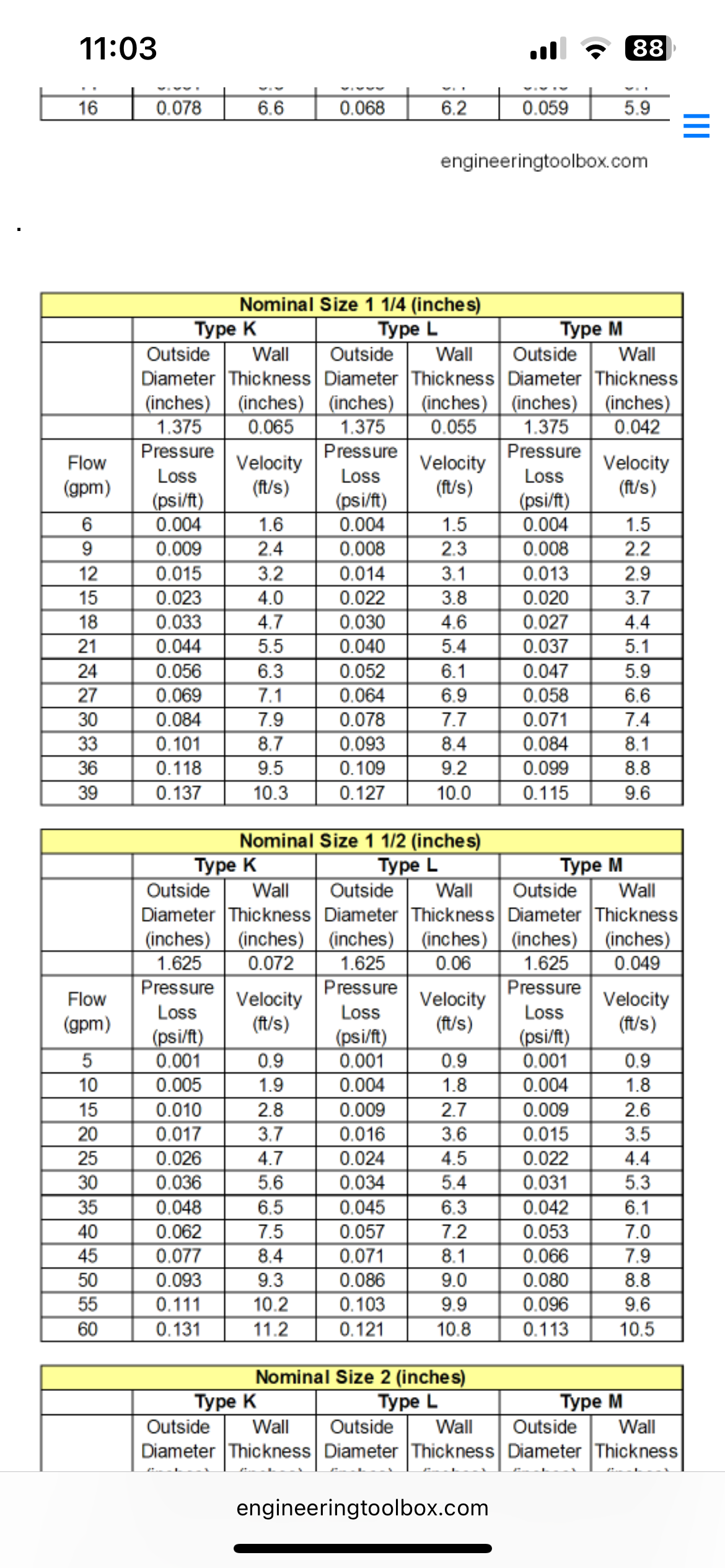

    That makes sense. I installed 1-1/4" copper pipe from the buffer tank through the 3-way to the tee before the radiant pumps. The fan coils circuit is piped 1". I'm looking for about 7.5 GPM through the fancoils and about 6.5 GPM through each of the rad panel pumps. If I understand correctly, the pumps aren't interfering with each other as much as the piping from the buffer tank is undersized. If I had piped that in 1-1/2", then I wouldn't see the flow through one pump drop when another pump came on. Yes?

    The piping from the buffer is your low liss header. It should be sized for 2-4 fps with all pumps running. So add all the gpm and size accordingly 1-1/4” should handle 16 gpm
    type M copper? Here is 1-1/4 and 1-1/2”
