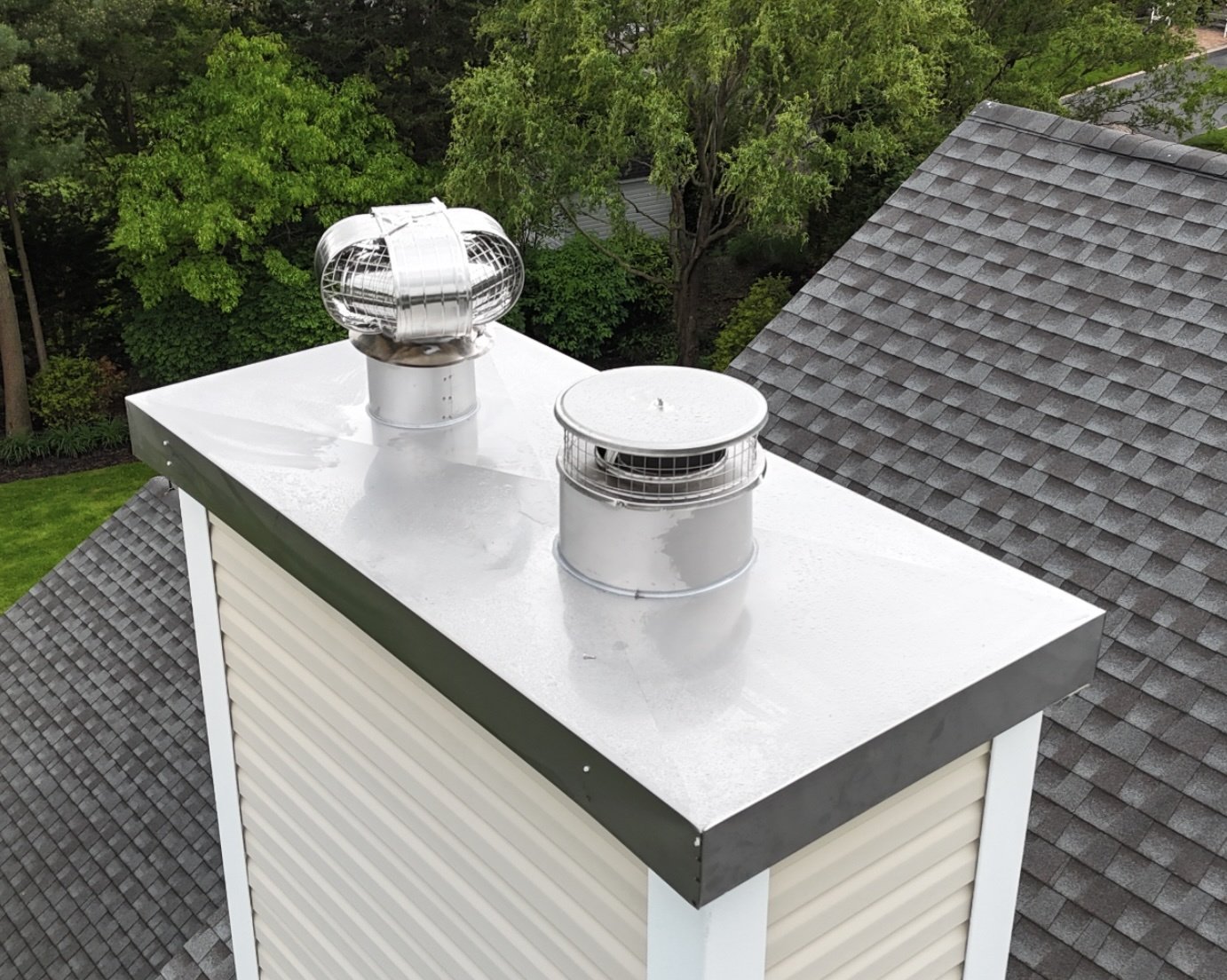

    Ed the basement is unfinished with 9ft ceilings and approx 1500 sq feet. Its one large room no walls. Boiler is Burnham ES2 - ES27 - 210MBH IN 178MBH OUT 85% efficient. Water heater is indirect just swapped that its a HTP stainless. Heating here is hydronic forced hot air. Home is just under 5000 sq ft. Gas dryer is on the first floor.

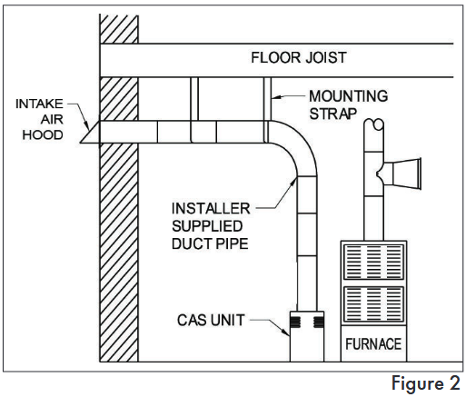

    I also just ordered one of these, have you guys ever used one? Figured this would put the combustion air needs to bed.
    https://www.fieldcontrols.com/fan-in-a-can-cas-34u-combustion-air-system/
    My original thoughts were, chimney or cap was allowing down draft this is the chimney which was recently all redone and all stainless steel. Boiler is on the left 7" Pipe right is a gas fireplace
    109A_5 Member Posts: 2,473
    To me if a draft is letting the air out an equal amount of air has to come back in, if not, the draft will stop or be insufficient. I am not a draft expert, just seems logical.
    I'm wondering if all you need is an air input means without the fan.
    https://www.fieldcontrols.com/wp-content/uploads/2023/06/780107600-CAS-34U-Inst-Sheet-RevB-05-23.pdf
