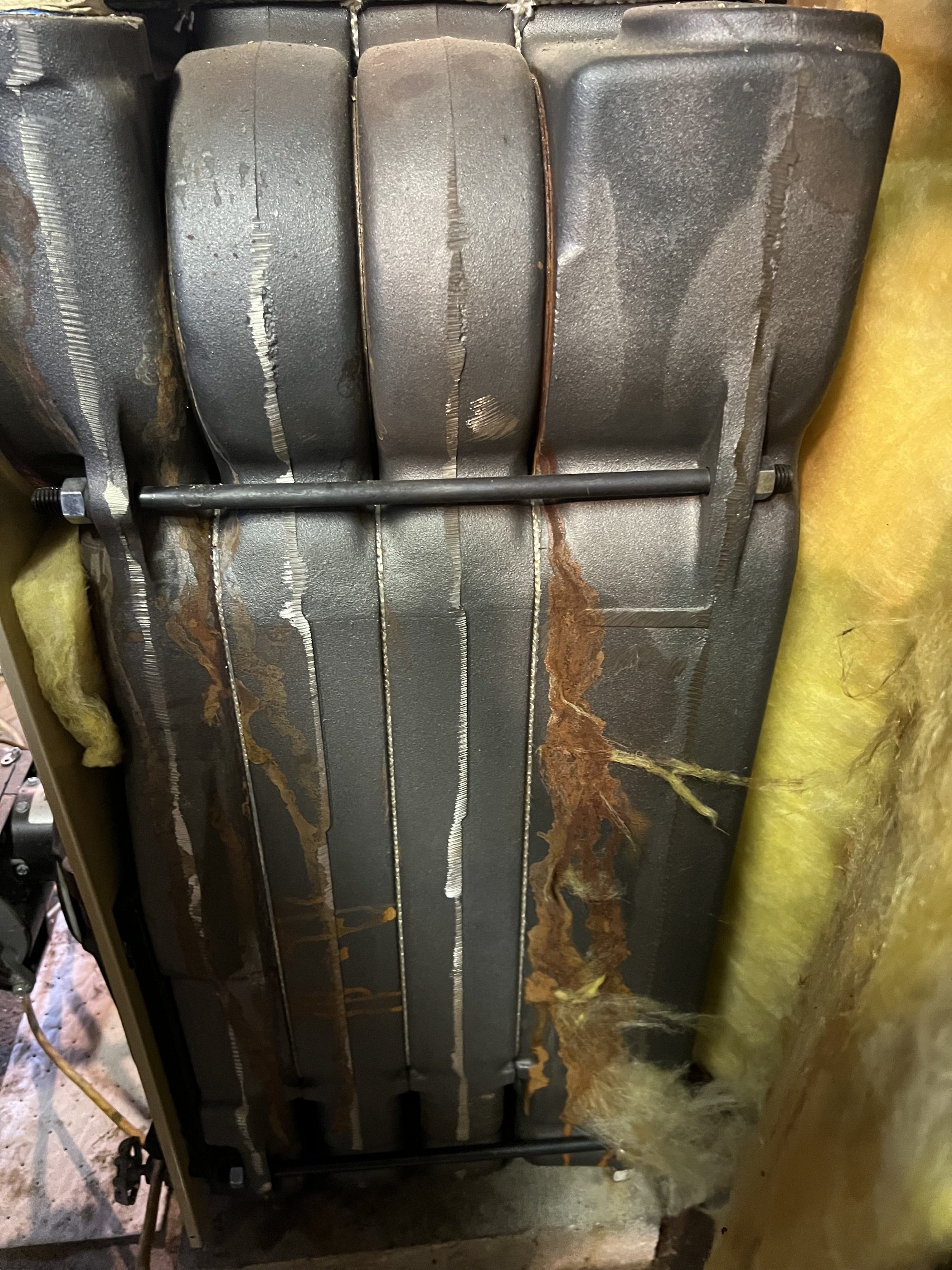

Boiler ran all winter but in March or April I noticed the floor behind the boiler looked wet/boiler was leaking - just when the boiler wasn’t running as often. Pulled the jacket off to see where it was coming from (attached picture) and appears to be in between one of the sections.
I also checked the low limit set point and it was down to 90 - I turned it back up to about 130 and the boiler hasn’t leaked since. crossed fingers
Is this boiler toast even though the leak has stopped the last 3/4 months? It’s not even 10years old yet - Weil McLain Gold forced hot water system.

  • Sounds like a leak at a mating surface; not enough gasket material or an imperfection in the cast iron.
    I’d keep the temperature at 130F and cross your fingers.

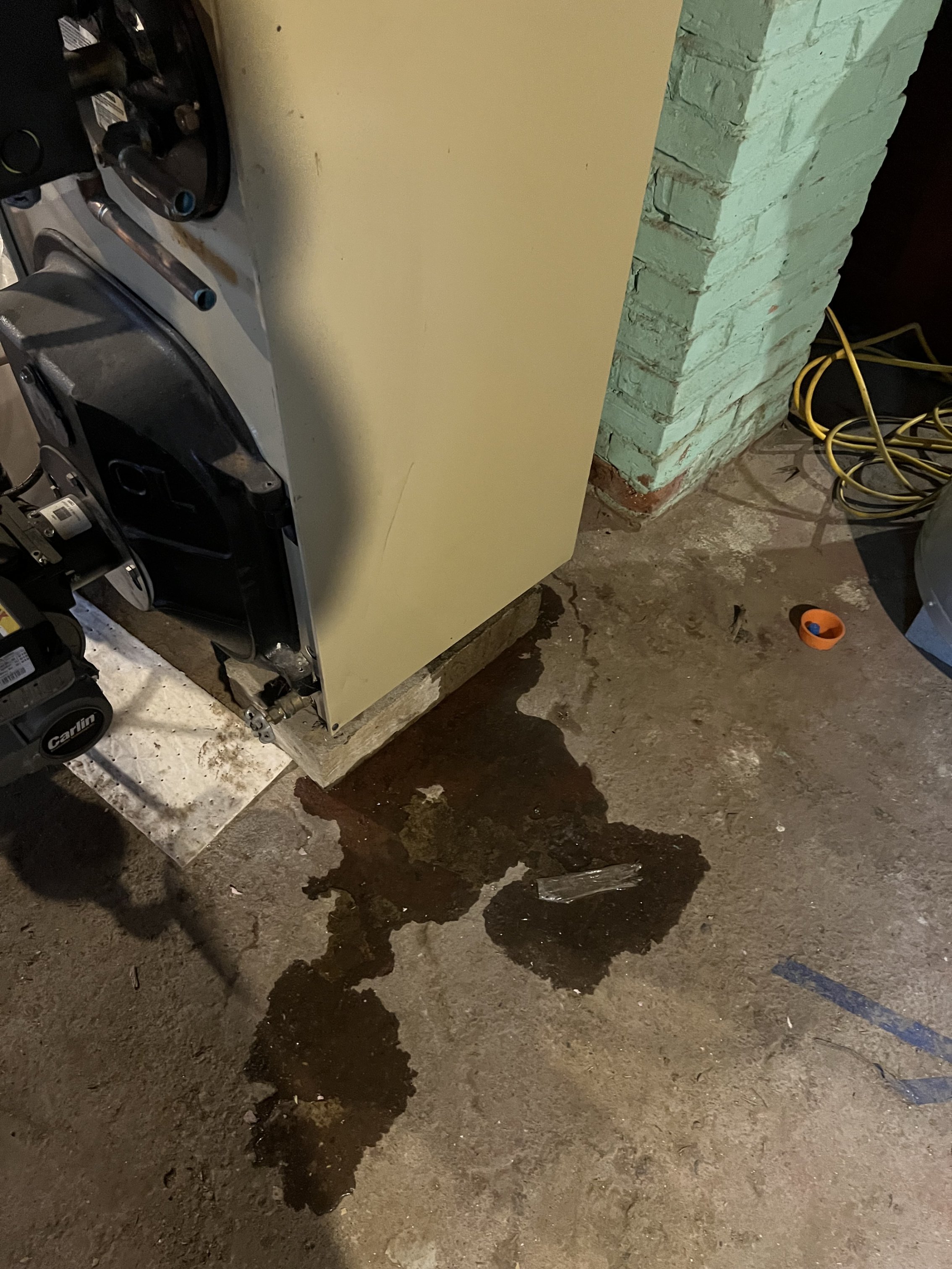

    Yes it fires - it’s ran in short spurts when I was testing it a bit and has been maintaining around 130degrees the last 3 or 4 months since I set it there. No water on the ground since knock on wood
    Picture of found puddle when it was still set at 90

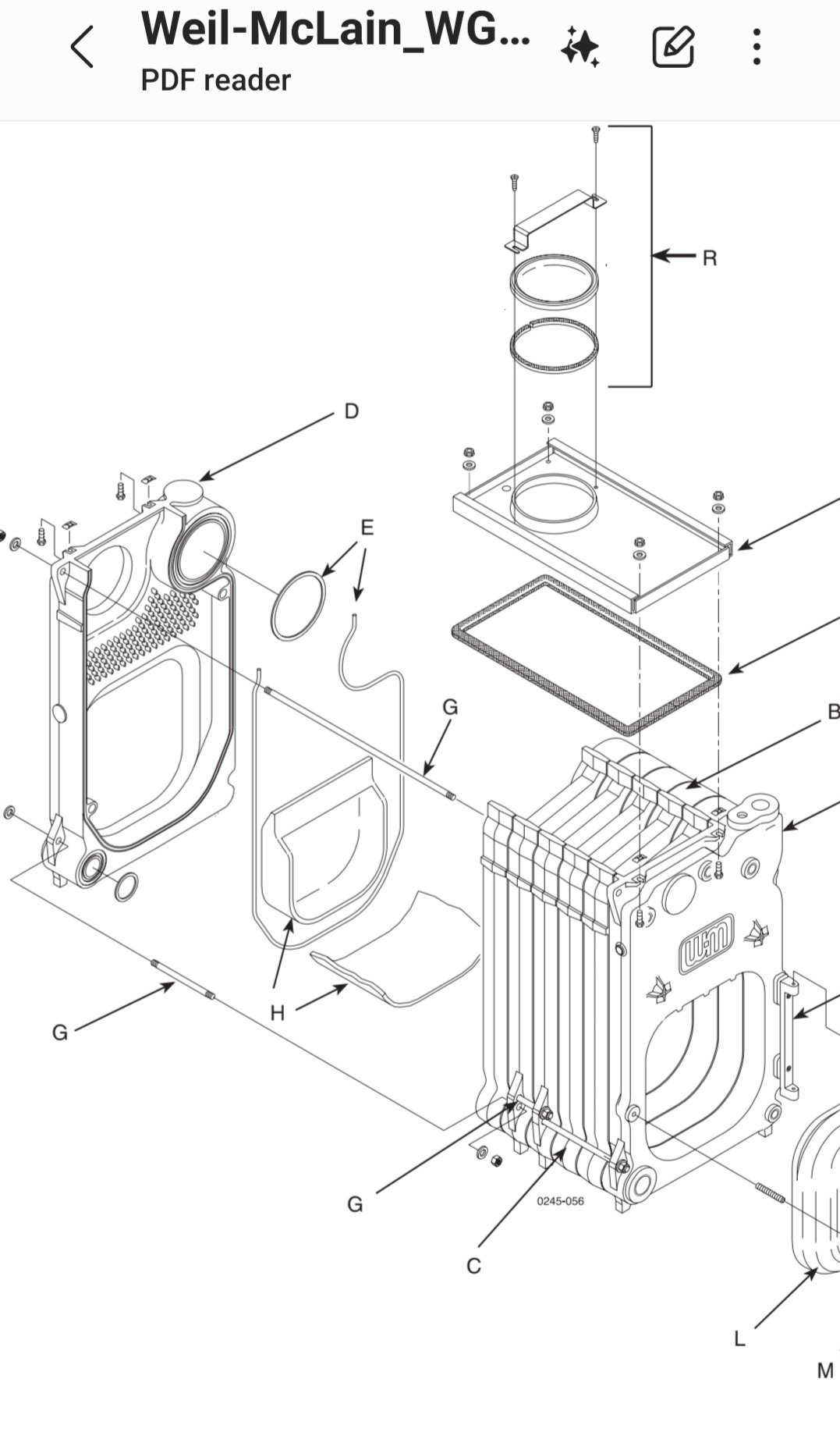

    Gaskets for the coil section are the culprit.
    There might be a prorated warranty, but the labor is out of pocket.

    The photo of the rest on the side of the block and the photo of the water under the boiler are sufficient for the warranty claim

    Based on the pictures I doubt it is cracked. My guess is the upper port gasket is where the leak is and it is running down.
    EdTheHeaterMan Member Posts: 12,448
    Still the upper port gasket leak qualifies as a leaking boiler and Weil McLain will usually honor that when it is brought to their attention via a warranty claim. The worst that can happen is the warranty folks at WM say no. Then you appeal and they say no again. But I remember when I did WM warranty claims, I could talk them into covering that exact situation. The warranty coverage uses the term "heat exchanger" not "boiler section" on the WGO, WTGO and SGO warranty form. See copy of warranty form here Weil McLain WTGO 20 Year Warranty
