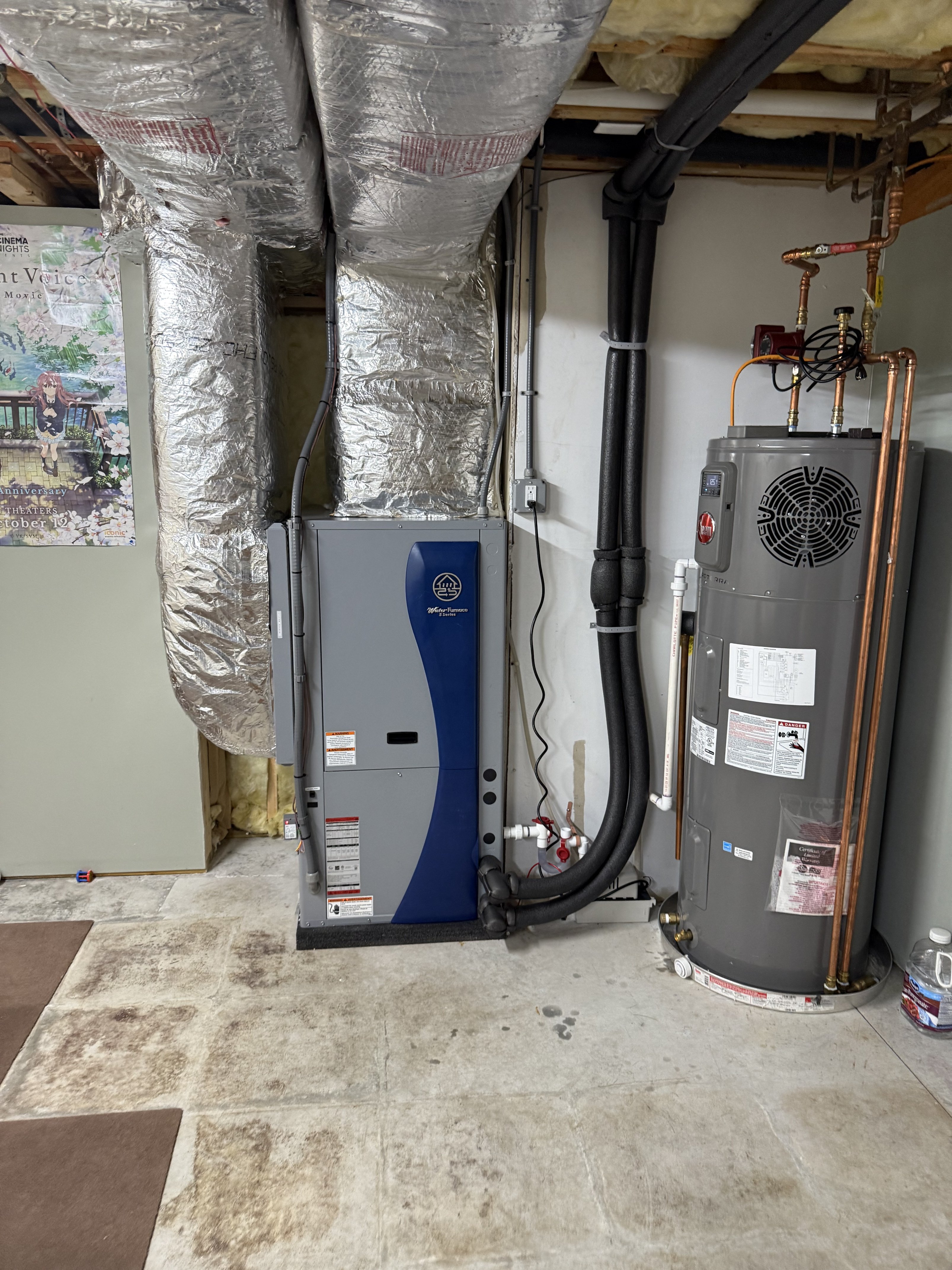

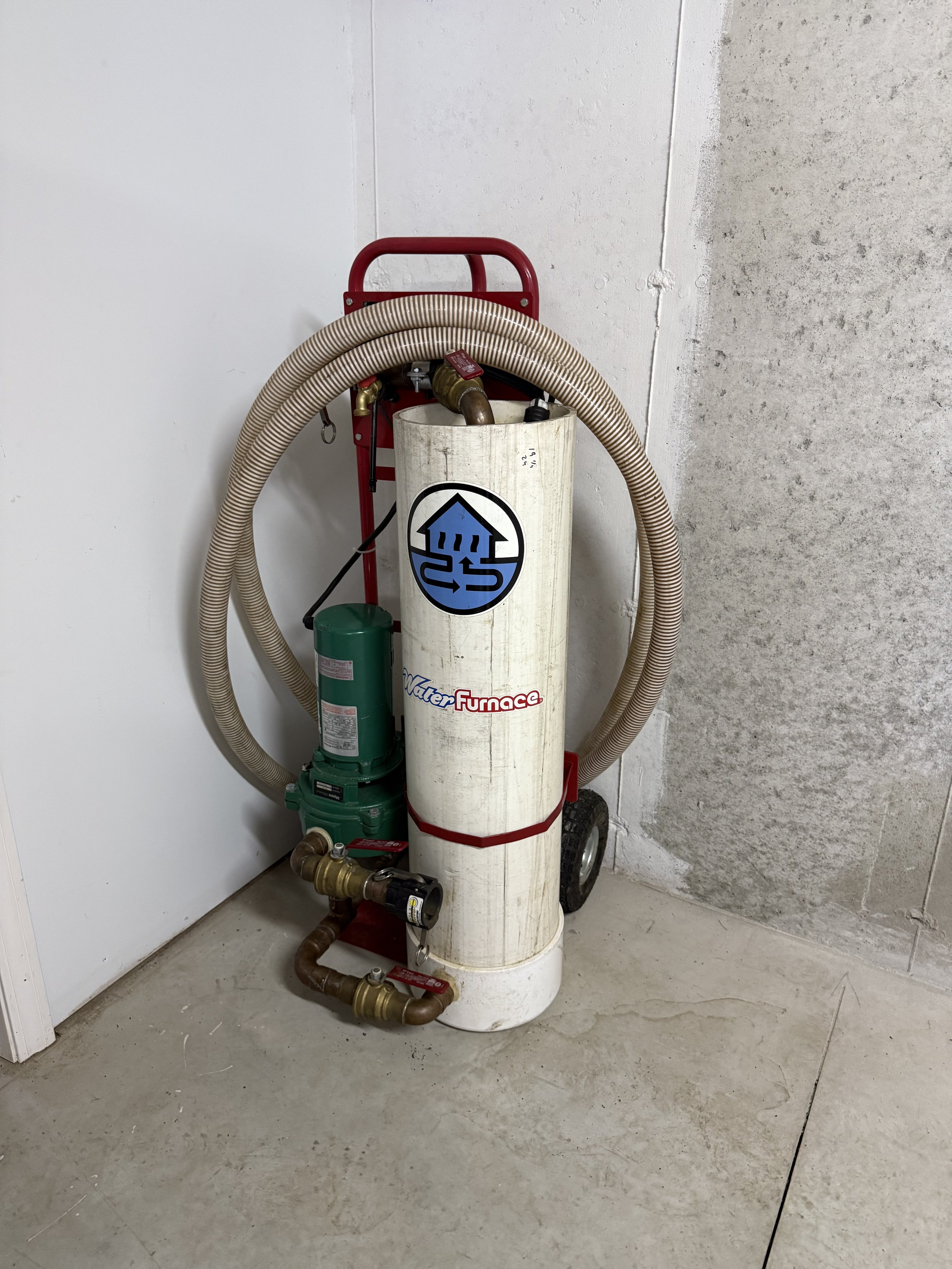

it always amazes me how much time these Geothermal jobs soak up. Anyways, we put the button on this one today.
we mixed some hard stuff, 15%. I felt like I was in a Breaking Bad skit for a moment. I filled the little 1 gallon jug 20 times. 1 gallon per 5 1/2 gallons of water.
till next time 😀

    i’m waiting for some eagle eye to point something out,
    OK maybe several things out, but one thing just caught my attention
    the homeowner will be able to take care of it in about 1.5 seconds flat

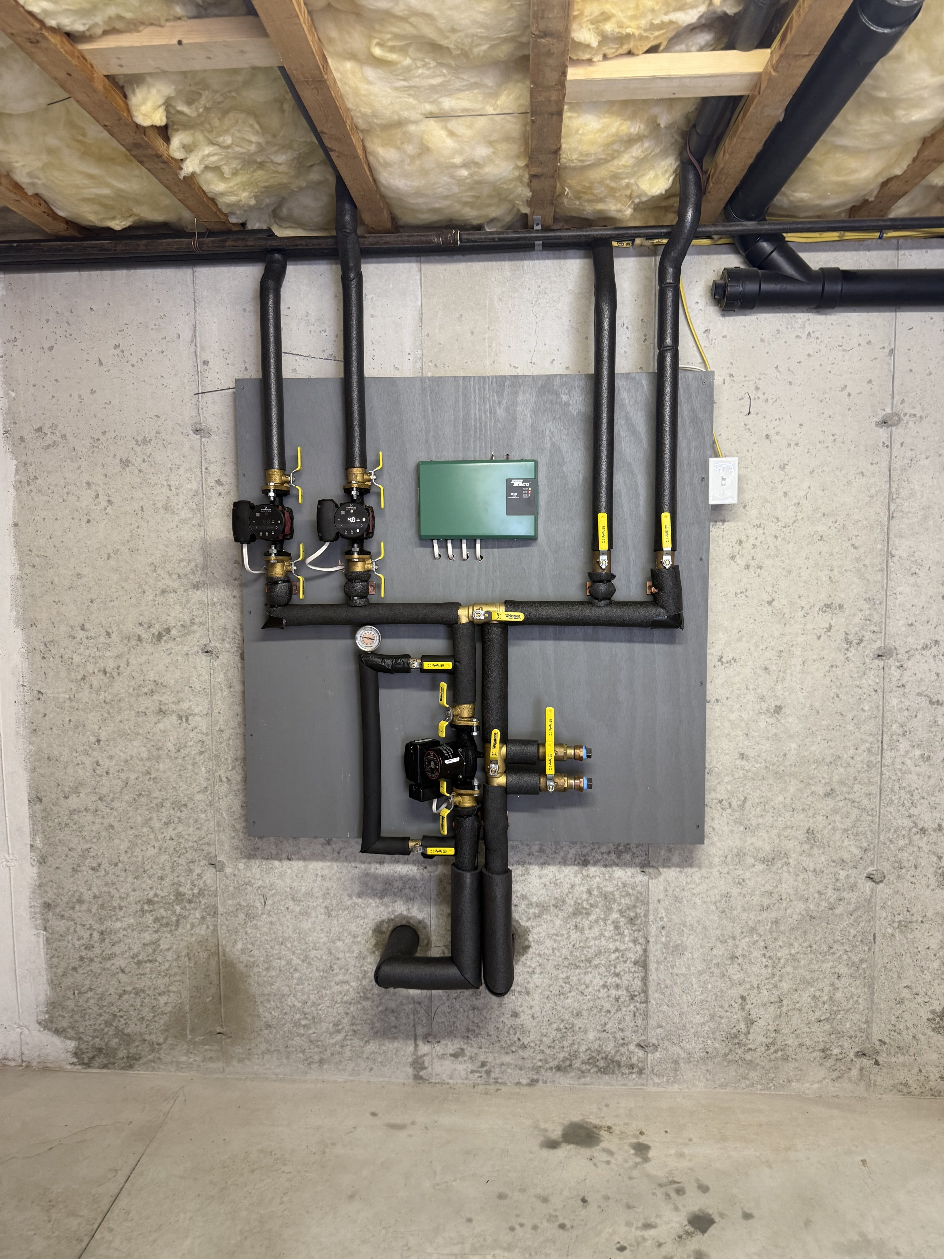

    Is the ground loop primary secondary?
    EBEBRATT-Ed Member Posts: 20,044
    Did you take a boiler out I see piping in the corner?
  • GW
    GW Member Posts: 5,177
    edited July 2025
    it’s the one bigger circulator , I guess I would call that primary

    Ed yes we yanked the old propane boiler, the Scrap guy did his thing with it

    Took out hydro aire and boiler and went geo. I didn't notice anything in the pics.
    How do you like the Waterfurnace? I did 3 or 4 of them in a college in Leicester back in the 90s thought they were pretty good.. That was my first geo job. There is a story that goes with that job four another time.
    The last geo job was Daiken and we had issues with them.
    mattmia2 Member Posts: 16,357
    Whoever did the old stuff looks like they di d a good job too. Maybe a little incident with the old condensate piping.
    hot_rod Member Posts: 27,259
    looks nice! They have a boiler HP and heat pump water heater?
    Or did the boiler go away?

    Propane boiler got yanked, we patched the foundation, made it look good.
    I paid a VideoGuy, he’s been out four times. I’m going to have a two minute video made. I’ll paste it when it’s done in a few weeks.

    small thing, we just need to shut off one of those 1/2” ball valves heading to that pressure gauge. It’s pretty minor.

  • GW

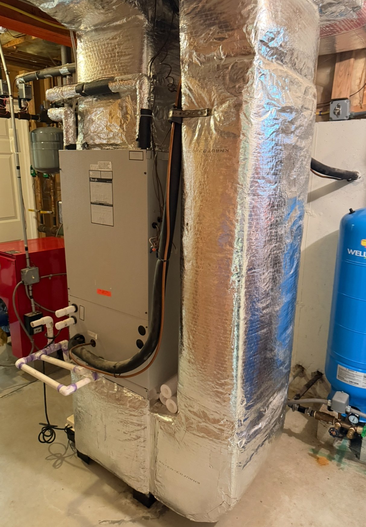

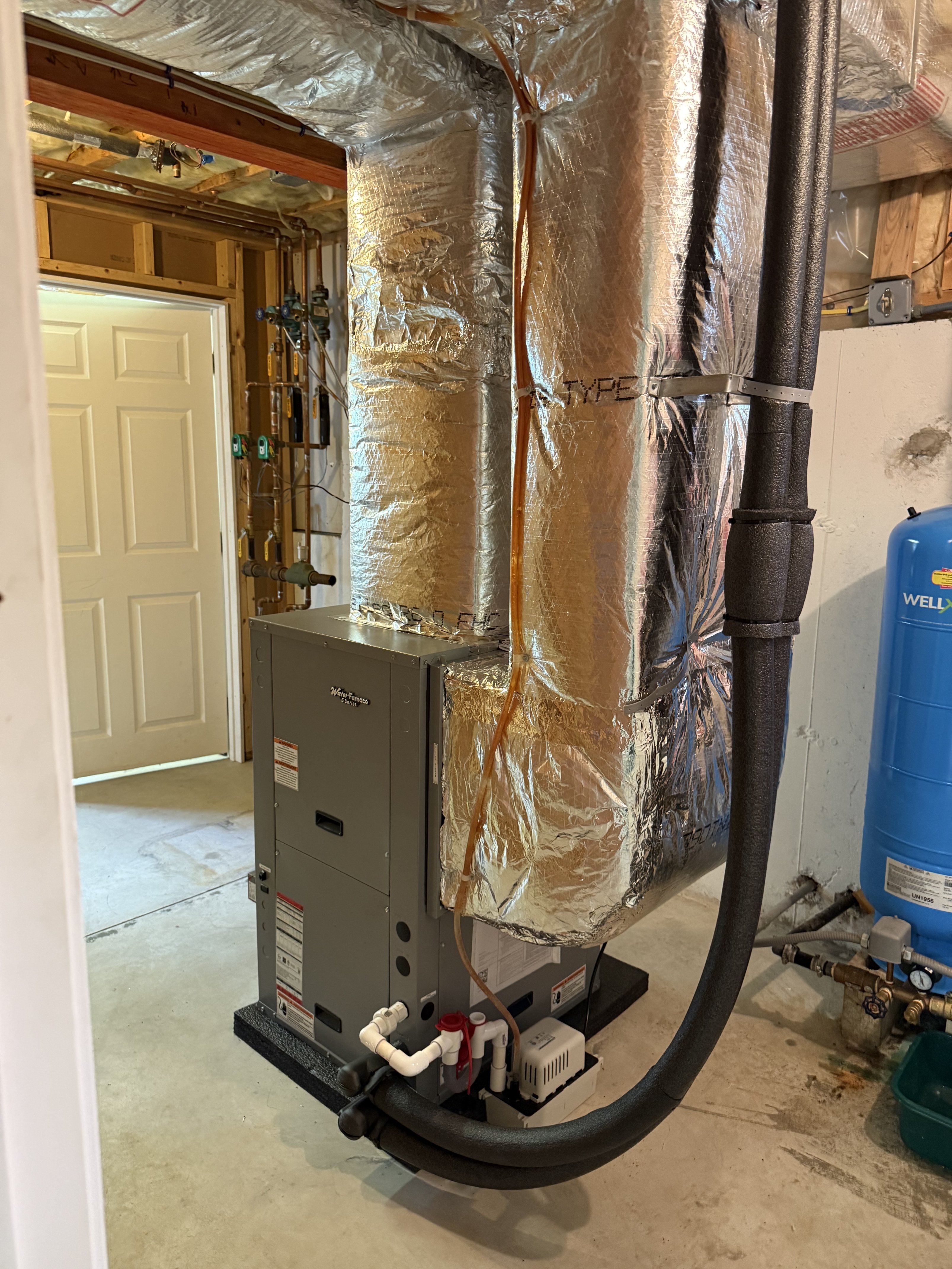

    @mattmia2 yes that needs to be trapped, no 'vent', I see some odd stuff in my travels

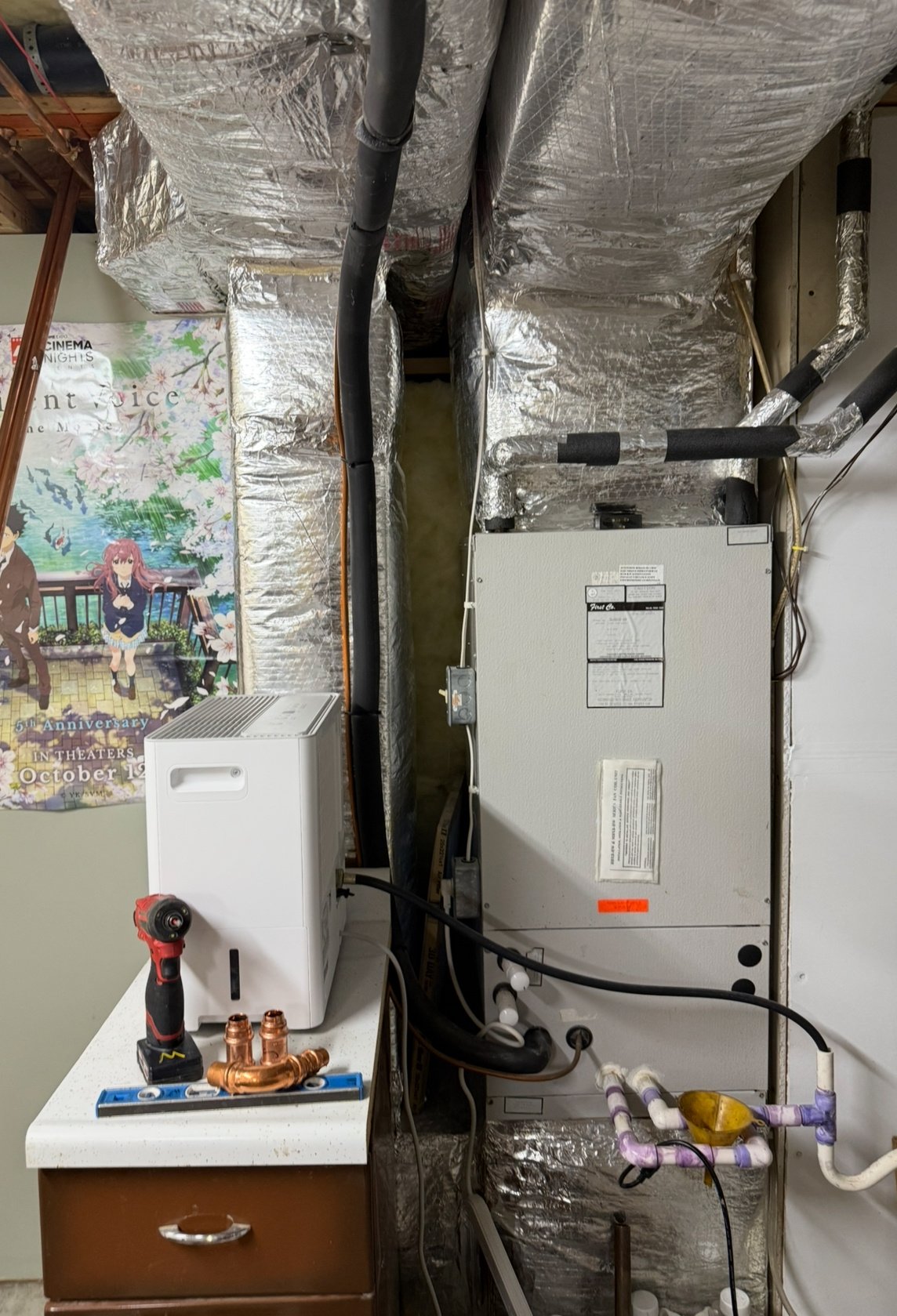

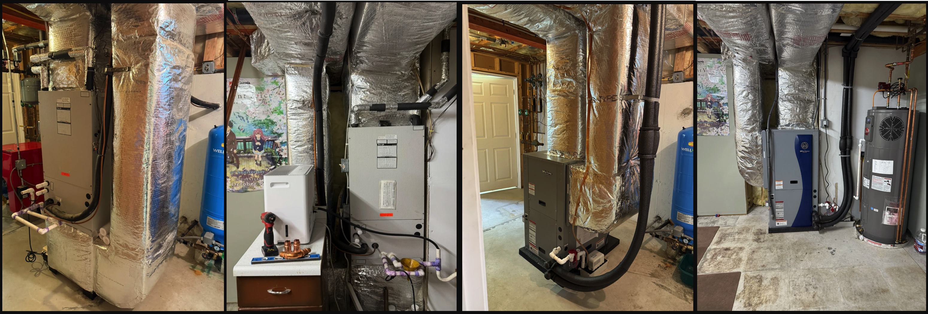

    EdTheHeaterMan Member Posts: 11,982
    Am I looking at 4 different systems here?
    Th original post seems like you are talking about one system. ?!? I'm confused ?!?
    But all 4 look great! Nice Work Gary
    Took out 2 hydro air systems and replaced them with GEO heat pumps and removed boiler if I understand correctly.
    Usually the removed equipment is trashed. This removed equipment could go in a new house!!!
    Thanks @EBEBRATT-Ed for that comment. At a closer look, I see that First Co. air handlers were replaced by the Water Furnace air handlers. Now I get it.

    I swear I wasn't TRYING to look for something to rag on. I was just looking where to put a probe thermometer to take in and out water temperatures.
    Anyhooo, 1.5 seconds for the homeowner to put the cap on. One hand as counterforce under the trap because those caps sometimes need a little persuasion.
    And beautiful work.

    @HVACNUT no that’s on purpose😀
    It’s the 1/2” ball valves on the loop pump- I should have closed one of them
    Just a tiny bypass going on- nothing to get excited about
    homeowner closed of of them for me (40 min drive)

    Why is that on purpose? I know the pump is right there, so its not a concern here, but a vent should rise at least a few inches above the trap inlet. Is there a benefit to keeping the cap off? Does Water Furnace have a display that shows temperatures and pressures, or are the ports hidden?
  • GW
    I always thought it was like holding your finger on the straw. The cap is the finger. I know it works with the cap on, I see it all the time in my travels.
    i thought it was an overflow in case the piping got clogged but now that i think about it, the height thing means it will spill inside before it overflows
  • PC7060
    PC7060 Member Posts: 1,775
    I thought it was so you can clean out the trap with the included brush
    on the trap the caps are but decades before that the installation manual required an open stub on the condensate line and had some spec about minimum height.

    I can't wrap my head around the min height thing. We do it on gas furnaces just to follow the written word.
    AC—-can't see how that can possibly matter
