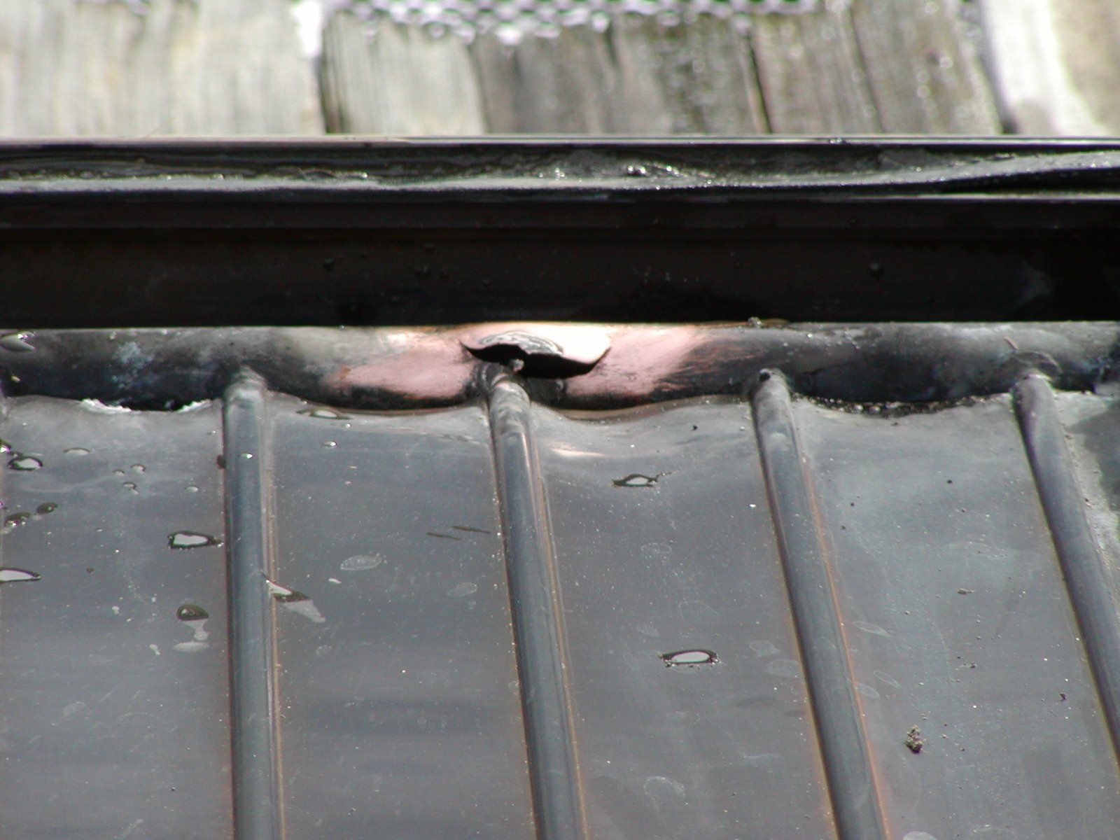

    Hi, Sometimes silver solder is the simplest approach to burst tubing. I've repaired many frozen solar collectors this way.
    Yours, Larry

    Silver braze the split closed. Simplest fix. Mad Dog
    SuperTechpecmsg

    Hi, I'll just throw it out there that some freezing in copper tube can expand the tube a little, so it is no longer the size of either plumbing or refrigeration tubing. So the choices are to either cut a bit more tubing out, back to where it didn't freeze, or silver braze/solder the leak. Finding a way to keep it from freezing in the first place would be nice, as soft copper can only be expanded so much… or maybe this is a good place for PEX. 🤔
    Yours, Larry
