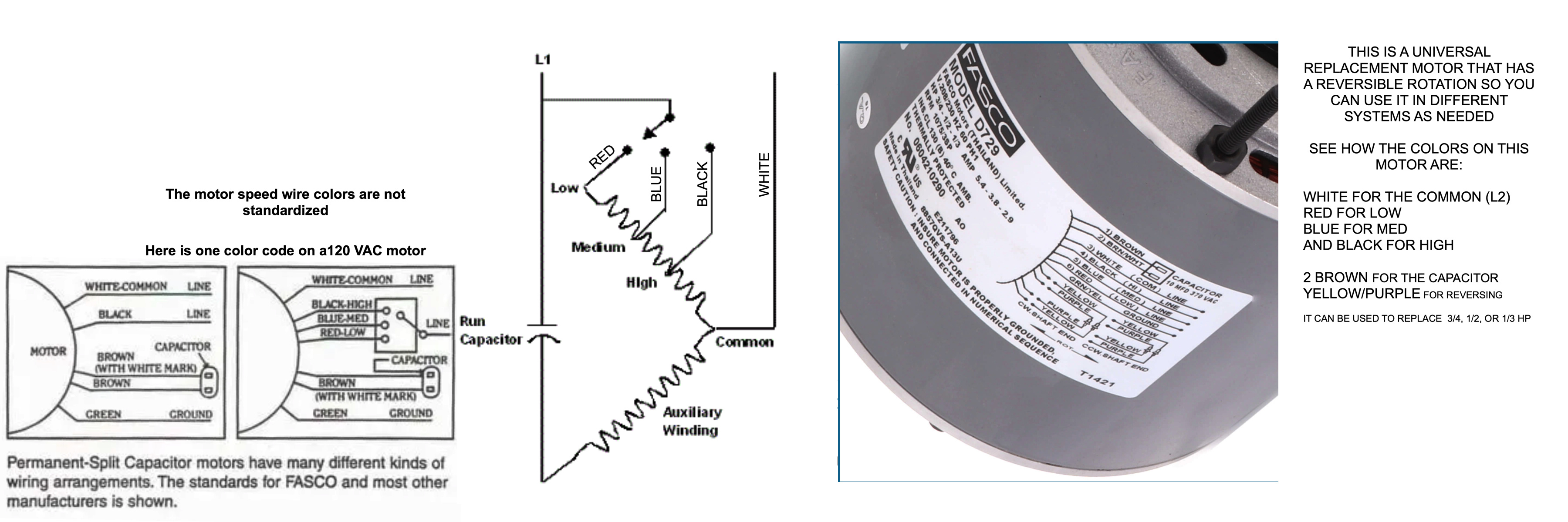

    You guys were exactly right and it seems as if the motor is not original and was replaced at some point. Seems to be a Century PSC motor model # F48SQ, RPM 1075/3, 3/4 HP, 5.5 amps
    I connected it to the medium speed for now (was going to look into the cooling capacity/cfm speeds to see if I could optimize it later).
    Based on the wiring diagram on the motor, that is the White and Blue wires (which were the 2 wires that someone previously connected to power.
    I'll go turn the fan on and see what direction it's turning. I could also connect it to White and Black which is supposed to be high speed and see if that helps too.
    Dampers are completely manually opened right now.
    Is the arrow in the last picture the capacitor for the fan?
    mattmia2 Member Posts: 17,207
    yes, that is the capacitor. i couldn't see it in the rat's nest of wires.
    try it on high and make sure it is the right direction.

    Ok so blades seems to be spinning in the right direction. Just by looking at the blades, it seems to be "scooping" the air from underneath and sending it upwards which is what I would assume based on the layout of the ducts. In addition, the blades match the large yellow sticker on the blower that says rotation.
    I'll try switching it to the high speed. Where should I be looking first for signs of freezing?
    just look at it from time to time while it is running. you will first see patches of frost then they will get bigger as the frost restricts the airflow and the load on the coil falls further and the temp on the coil drops. not a terrible idea to check the current on the compressor and make sure it is at or below the nameplate rating too if you have a clamp on ammeter.
    Typically the ac runs the blower at high speed. To some extent it will run correctly at whatever airflow the system was charged with.
