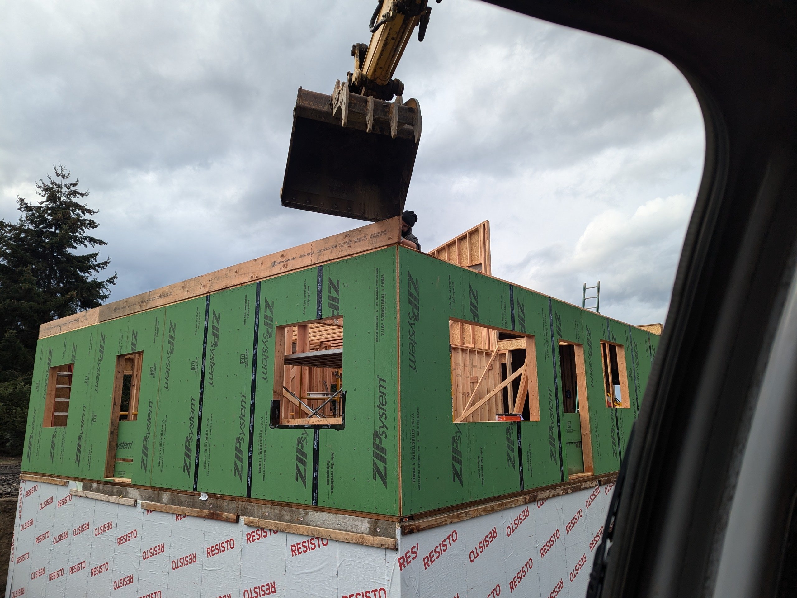

    We have 3 loops up today. We may not be good, but we're slow.
    I created a route by cutting a notch in the end of this beam. Most people would have kittens over that, but when I ran the beam calculations in BCCalc, I only specified 3.5" of bearing and the framer put it all on there because he's a framer. One of those arses also test fired few bullets into the end of it just to test the shooty thing. I ran the whole scenario past the AHJ before notching.
    I get to comb out 5 tubes in there and protect it all from the sheet rock guys. What will really happen is I will put that rock up myself.
    This is the landing on the way to the basement with convenient stand up manifold. I will bring 6 or 7 from floor 1 and another little manifold with 4 from floor 2. That wall is a filler to fix a bust when I designed and layed out the elevator pit. The bearing wall is beyond it. I did have a chase beyond that but I quickly took that candy wall over as my playground. Waste not want not.
    when looping through, I have a few tubing crosses where it will touch and make sounds. What is the strategy there? I was thinking a figure 8 zip tie standoff, like we do in aviation.
    The 3/8" has been a dream to work with. First two runs were about 210' to make it work.
    We are using the uncoiler from work.

    In the first floor I was able to contain all the ducting in the joists and have a flat lid down there, by using the software. It is simpler to punch the holes on the computer and model them in the software, than it is to chase around the hole rules charts.
    This hole is at 88% of the allowable shear value. I made templates and cut holes with a plunge router.
    It took time to load ducts as we went and it drove the framer nuts, but I was paying the bills.
    The results are worth it to me, to not have a trunk dangling down the whole length of the lid.
    Not to have any flex in my house, anywhere. Not for dryer ducts or fart fans either. I pre-loaded all that too as we went.
    We got 7 loops and 1370' loaded by end of day. The main bathroom I ran it short at 165' to allow for the towel rack(s).
    I have no idea if that was sufficient, I have not picked out any yet but my gut said lighten up on that loop.
