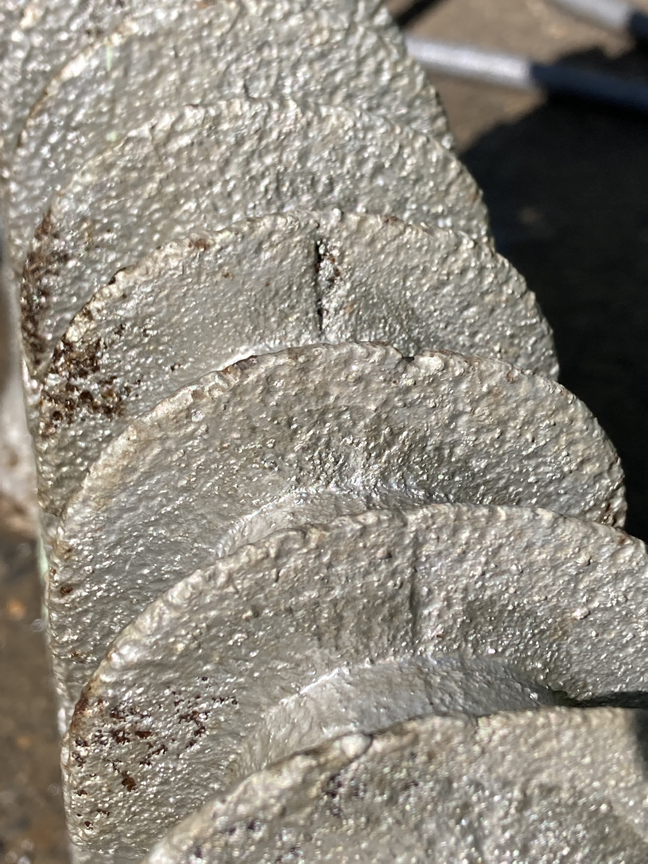

Well I found this radiator and couldn’t pass it up! It appears sound but I did not test it yet.
There aren’t any manufacturer’s marks anywhere that I can see. There are small stars on the columns. The casting appears very rough in texture. It’s as heavy as it looks haha! I couldn’t find any similar radiators in Dan’s EDR book.
This came from Williamsport PA. A town that likely had a half dozen foundries back in the cast iron heydays of PA. It is possible it was made locally and there weren’t many produced.
Anybody have any info? Seen one before?

    EBEBRATT-Ed Member Posts: 18,815
    Wow!
    What a beast! Is that a 4' level on it?
    Looks like it would heat a whole house

    Yes I meant to say that it is a 4 foot level for reference. It’s so tough looking! It’s like if Charles Bronson was a radiator!

    that looks like the type that’s buried in wall behind vented wood panels. Relies on airflow to produce head by conduction.
    Similar to those use in the historic Whalehead estate in Corolla NC. You can see the airflow holes in the paneling head this old desk.

    It looks like maybe that middle section was meant to be covered. The middle section looks like an indirect radiator but there would be no reason for the end sections to be so ornate or to have feet on indirect radiators.

    yes I agree about the feet and ornamentation! I suppose the center could have had some type of cabinet originally. You would NOT want to bump your knee on this!

    I hope so! I will try to remove some paint and see if any markings appear.
    Is that inefficient design?
    Radiator blocked behind a wall and a desk
    All my radiators are exposed now
    Jamie Hall Member Posts: 26,509
    Depends on what you mean by "inefficient", @CoachBoilermaker .. Does it put out less heat than it would if it were free standing?. Yes. Does it use more energy from the boiler in relation to the heat output? No. Any more than a smaller radiator is "inefficient" in relation to a large one.
    So — no inefficient, just lower output.
    ttekushan_3EdTheHeaterMan
    mattmia2 Member Posts: 14,585
    It acts like a convector cabinet, it drafts air in the bottom grill and out the top. It outputs more heat than it would if it were out in the open.

    @ayetchvacker , where in Williamsport did that rad come from?

    I saw one for sale in Connecticut several years ago. It was exposed in a hallway and painted red. It was about 40” wide and 40” tall.

    I found it thru fb marketplace. I picked it up in an old empty house on the west end not far from third street. I asked if there were other rads like it in the house and the gentleman told me this was the only one that he remembered in the house.
