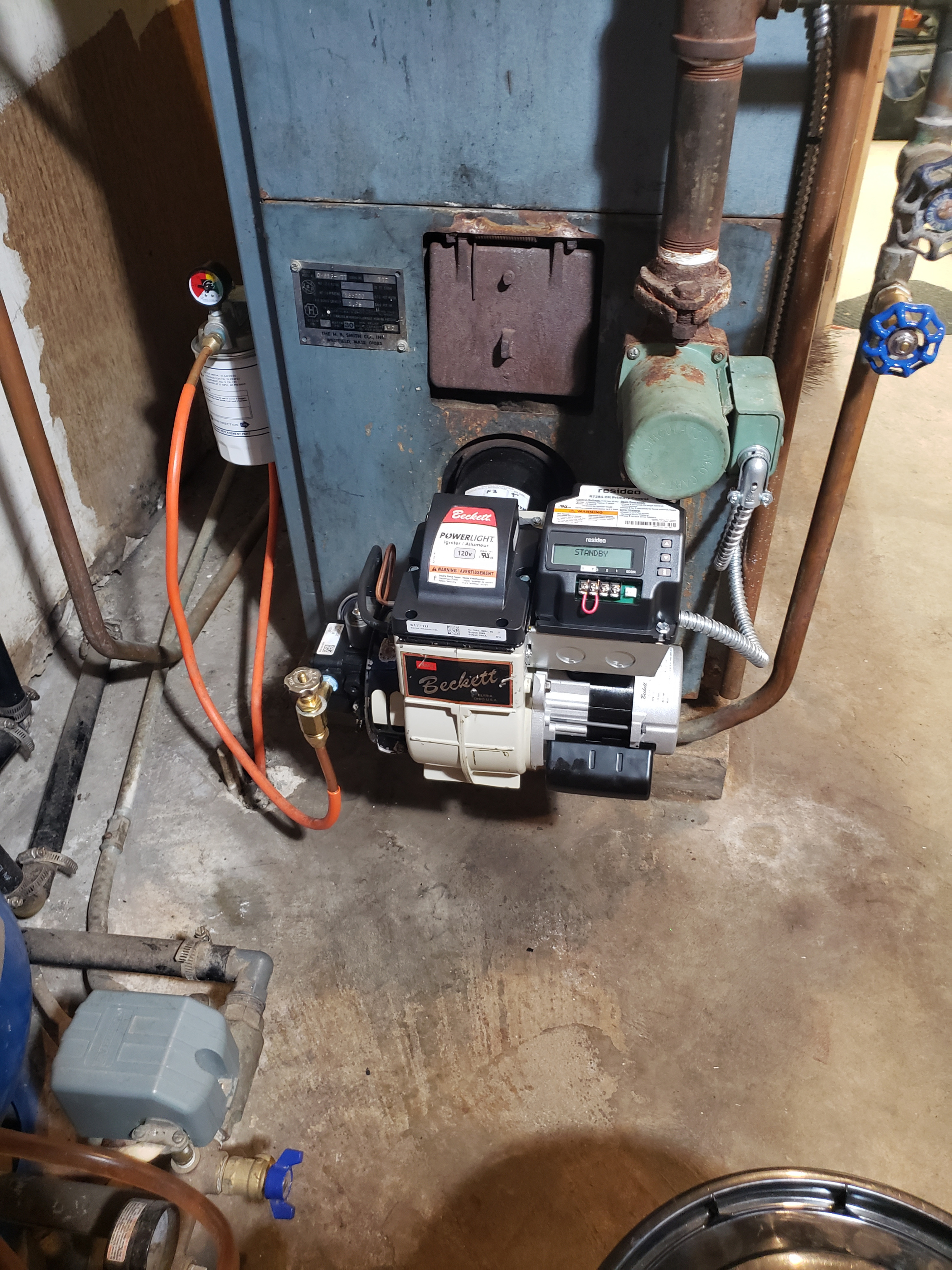

Hey everyone. I wanted to get some opinions on combustion chamber sizing recommendations.
I have a 1972 HB Smith 7 section boiler. (Model OHB13W-7T) Its rated at a maximum firing rate of 1.95 GPH. However its current firing rate is set to about 1.25 GPH (1.00 GPH nozzle at 160psi)
The current combustion chamber is on its last leg and is falling apart so I am going to be replacing it soon. Because I can not find any OEM parts or direct replacement parts for this boiler I am forced to use a Lynn Quickie 200 or 300. I cant decide on what one is best. I already purchased the Quicky 200 however im second guessing my choice. Here is why…
The Quicky 200 is rated for a firing rate of 1.35-1.75 GPH and the Quicky 300 is rated at 1.75-2.25 GPH. As far as actual dimensions go, both should fit inside the boiler. But here is the thing. This is a wet base boiler and as far as I know the combustion chambers are really only in there to aid in proper combustion vs protect the boiler interior like on a dry base boiler. My thought is that because the Quicky 200 is even oversized for my firing rate, I would only hurt combustion further going with the Quicky 300. The only thing I like about the 300 over the 200 is that It would "fill" the boiler more. But proper combustion is probably more important.
Note: The current combustion chamber that is falling apart is about the same size as the Quicky 200. (I am not sure if the current chamber is the original or not but it appears to be if I were to bet on it). Based on the OEM cutsheet of the boiler the 7 section boiler I have as well as the 6 section model both share the same combustion chamber size theirfore there is a 3-4" gap behind my current combustion chamber to the back wall (Boiler back section).
Do you think my Quicky 200 is the correct choice or not?

    EBEBRATT-Ed Member Posts: 19,386
    Either one is fine use the 200 you have.
    With old non wet based boilers and non retention burners the combustion chamber was required to allow the old burners to burn clean and the chamber protected the non water backed surfaces in the boiler.
    With a wet based boiler and a flame retention burner (I assume you have a Carlin 100crd or a Becket model AF) the burner will burn clean without a chamber but better with it.
    Also the boiler doesnt require a chamber to protect the boiler.
    Use the 200 and you will be fine.

    Yes, the current burner is a Becket and says Model "A", AF" (May be suffixed). The original burner is long gone.
    Do you think I should cut the hole in the combustion chamber slightly larger, or even U shape the top of it, and set it back further to the center of the boiler to concentrate the heat in the center more? Currently there is that 4" ish gap behind the combustion chamber to the back of the boiler so in my theory the back of the boiler is not getting as much heat from the combustion chamber.
    If you were to chose the 200 or 300 for my situation what would you pick and why?
    Either one is fine. With 4" behind the 200 the heat will get back their with no problem. It will be fine.
    You should combustion test the burner when complete.

    The above post shows some pictures of the boiler. Of course when installed the plumber didn't leave much room for access to the chamber. I basically have to carefully pry the fire inspecton door over the taco pump just to get a good look inside. I'm also not sure what's hanging off the one side of the burner tube but thats probably a piece of the old chamber. Hard to tell.... Either way the end of the burner looks OK to me even without it being "protected" by the current combustion chamber. I've also attached the full manual on this post
    for more info if you want to take a look.
    HVACNUT Member Posts: 7,185
    That looks like the same boiler as the Dunkirk 1352. The Quickie 2 will work fine.

    I hooked up the direct domestic heating coil with a tempering valve. I actually have an electric hot water heater / solar heater combo tempering the water before it enters the coil with the electric element currently off. (I'll shut boiler off when not in heating season and use only the electric hot water heater) I have everything set up with valves to isolate ext. I'm also feeding my combo electric water heater from a wastewater energy recovery drain. So there is a lot going on in there to save energy.
    I'll attach a picture of the boiler plate and pump at the end of this post. I may update the pump to a clean cut one with a new burner control at some point to. Anyways the boiler is rated at 1.95 GPH. I'm running about 1.25 GPH with my 1.0 GPH nozzles and 160psi pressure. I think I'm going to kick that down to 140PSI which is about 1.1 GPH and run the F3 head. There is no issues with domestic hot water as of now.
    The aquasmart is set up with a high / low. It's set to 140 low with 15 deg diff. (Kick on 140, kick off 155). 175 high with a 15 deg diff (on at 160 off at 175) It's also on an outside reset that lowers the high limit down to 160 @ 40 degrees outside and raises to 175 @ 0 deg outside.
    The "scorch marks" on the head you see may have been from the recent cleaning. My buddy ran an angled brush in there. The flue, front plate, top, and all 6 section plates were removed for the cleaning and vac. Only thing that wasn't off was the large plate that holds the burner. I'm going to hold off on pulling that untill I'm ready to the the chamber. I may have clearance issues with piping but I won't know until I try. But the top 2/3 of the unit is clean for now.
    The draft control is in properly. (Unless all letters and stampings were done upside down) It looks like the newer ones are slightly different than some of the older ones. Almost like they flipped the setup in some way for some reason.
    As I said before we did run an old school combustion analysis test with his acid filled gauge and pump and the best we could get was 7% CO2 before smoke got past a #1.
    As far as my understanding goes, basically as you take away more air your CO2 goes up but the smoke goes out of range. (To dirty) The C02 is nice to know but you can only get so much out of it. Maybe the new head and combustion chamber will help a bit. It shouldn't hurt!
    What is really the point of the CO2 analysis on the flue if it seems like you can only get it so high before smoke gets bad. Why not just set the smoke around 1, back off a hair towards 0 and call it a day?

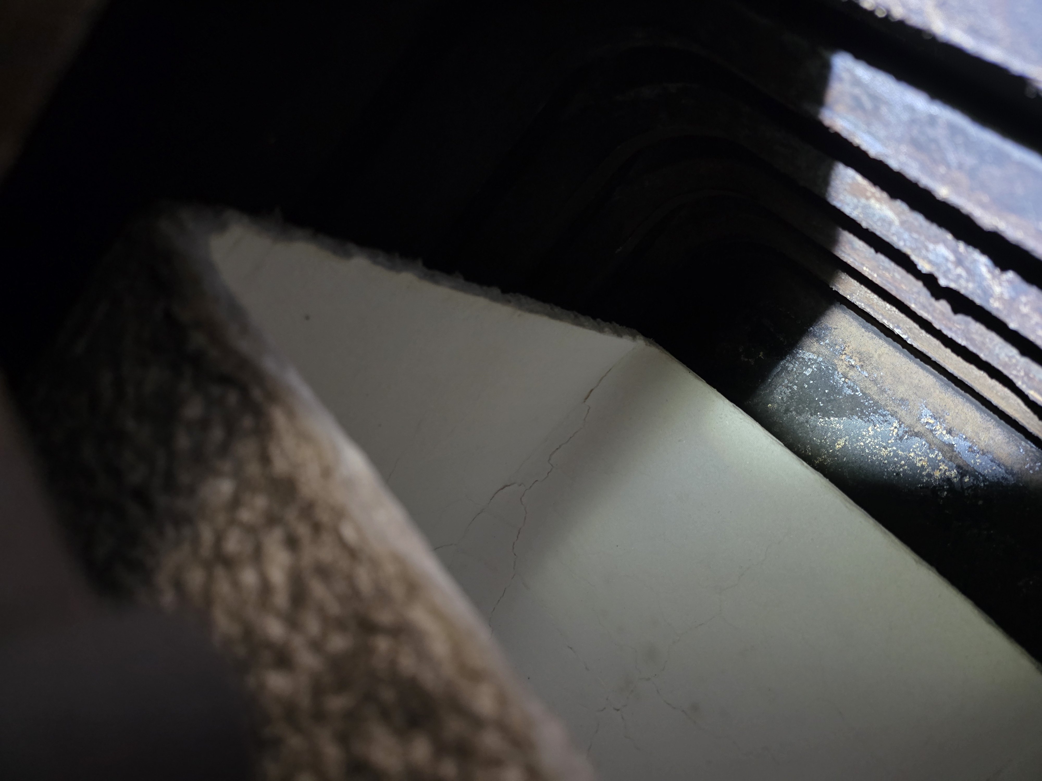

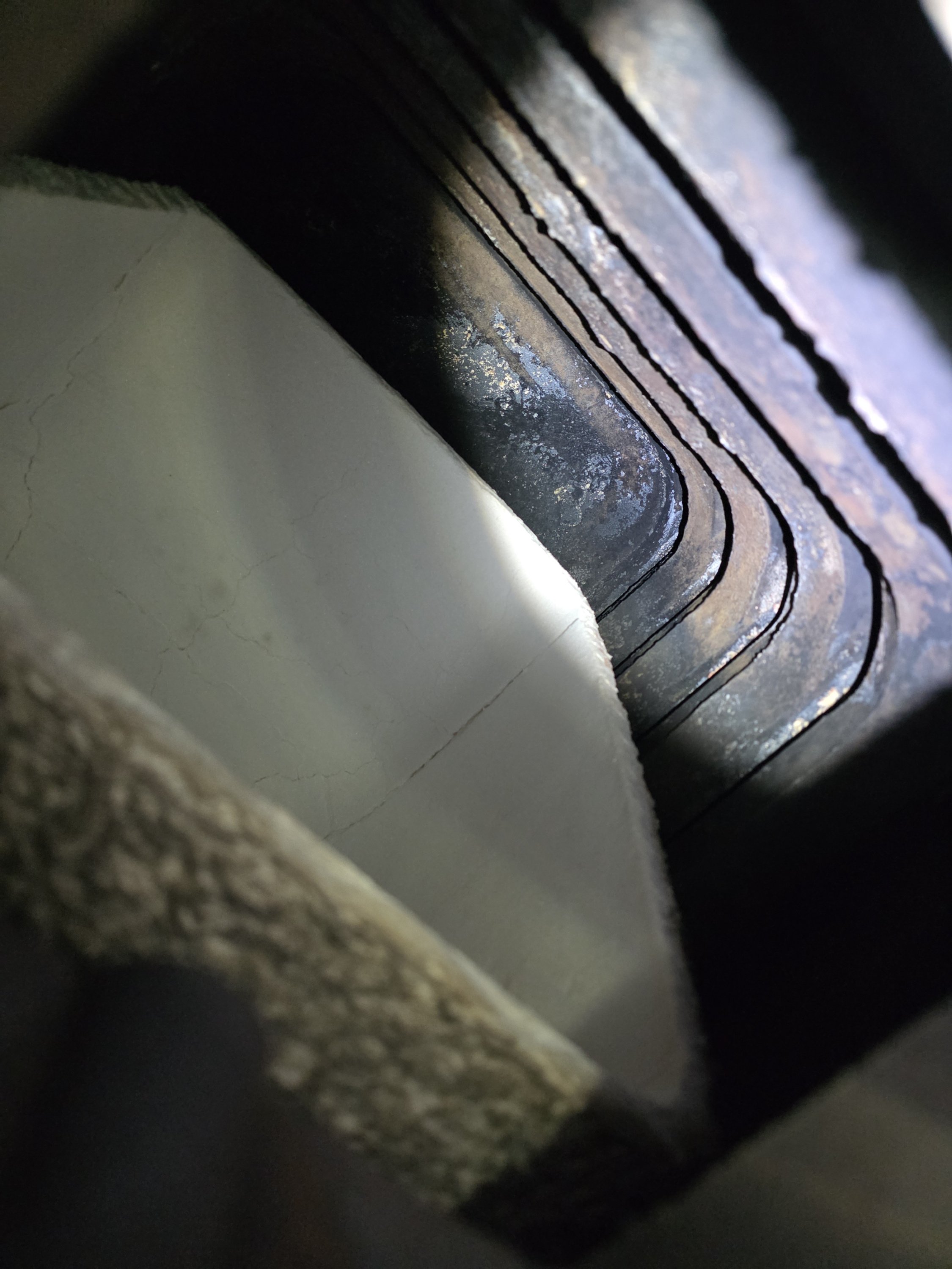

    Okay I got everything installed and the boiler has been back in operation now for about 5 weeks since it got colder outside. I noticed today that the new combination chamber has cracks already. Is this normal?
    Your going to get some cracks.
    @EdTheHeaterMan if there is a space between the front plate/burner flange and the chamber what will keep the air tube from burning up?
    EdTheHeaterMan Member Posts: 11,525
    edited December 10
    I suggest that the opening in the Quickie be made by using the actual Air Tube as a cookie cutter to get a Snug Fit into the chamber. When you add the F Head to that hole in the chamber the fit is very snug. That combustion chamber fiber will have a little give to let the end of the air tube fit in the opening made with the air tube.
    As far as the temperature of the flame spilling over the the top of the Quickie and dropping down to the air tube in the space between the burner chamber and the flange/plate: that can get hot but there is cold air from the basement air intake blowing through the inside of the air tube the entire time the flame is on. If the burner motor stops when the flame stops there is a chance of over-heating since the combustion air is no longer cooling off the air tube, you may want to add a valve and post purge to keep the cold basement air blowing thru the tube for at least 90 seconds after the flame goes out.
    I have not experienced that problem with this Smith boiler and ARCO wet base boilers using the quickie chamber, unless there is a partially blocked chimney base.

    The air tube / quickie chamber fitment isnt quite a press fit but it's pretty good. There would be no reasonable way to assemble this with a "press fit" especially now with the chamber broken in from heat and becoming fragile. While looking at the flame burning there is no flame going by the burner tube at all. The tube and head are slightly inside the chamber with little gap between them. In fact even with the old tube and broken chamber the tube was fine. Keep in mind this boiler is deep and under fired so the flame doesn't "bounce back" as much as some shallow boilers. I do have a pre and post purge control with a clean cut pump. My only concern was the cracks in the new quickie combustion chamber. But I guess this is normal… Seems strange but as long as the pieces stay in place I guess it's nothing to worry about.
    Since you have a wet based boiler some wet based boilers now don't even have a combustion chamber. The chamber is not needed to protect the boiler from the flame. It is only there to help the burner combustion and with modern burners it may not be needed but combustion will probably be better with it.
    I think that boiler was made by Dunkirk for H B Smith. Those were good boilers. Probably early 70s.
