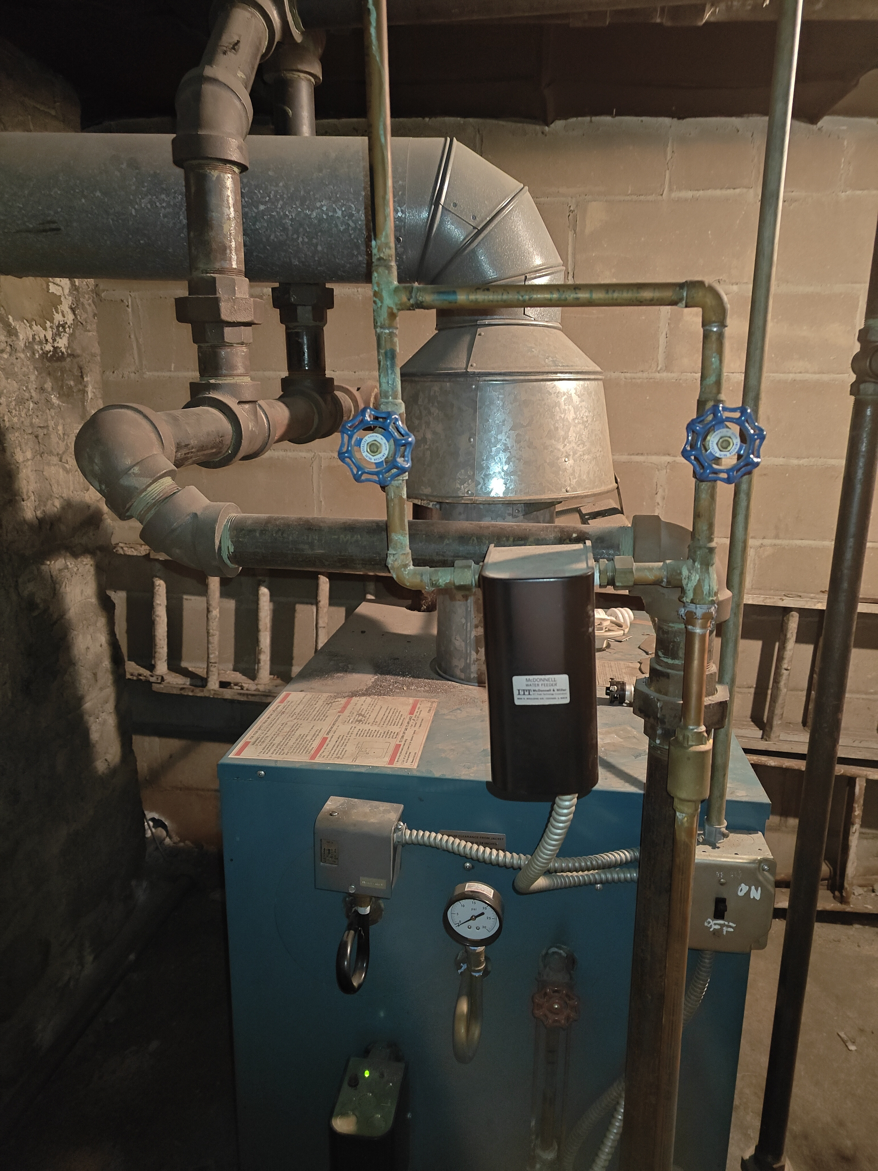

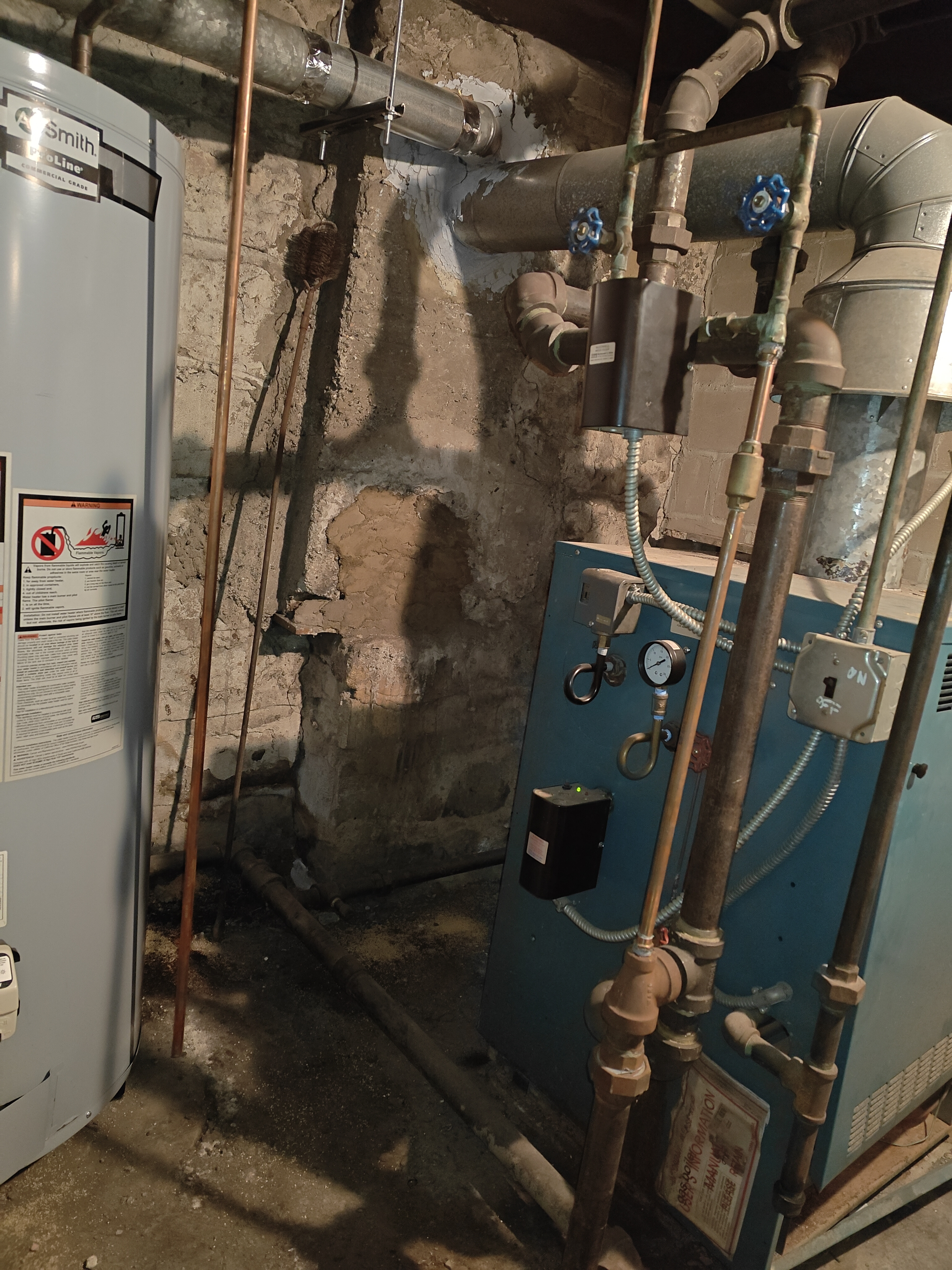

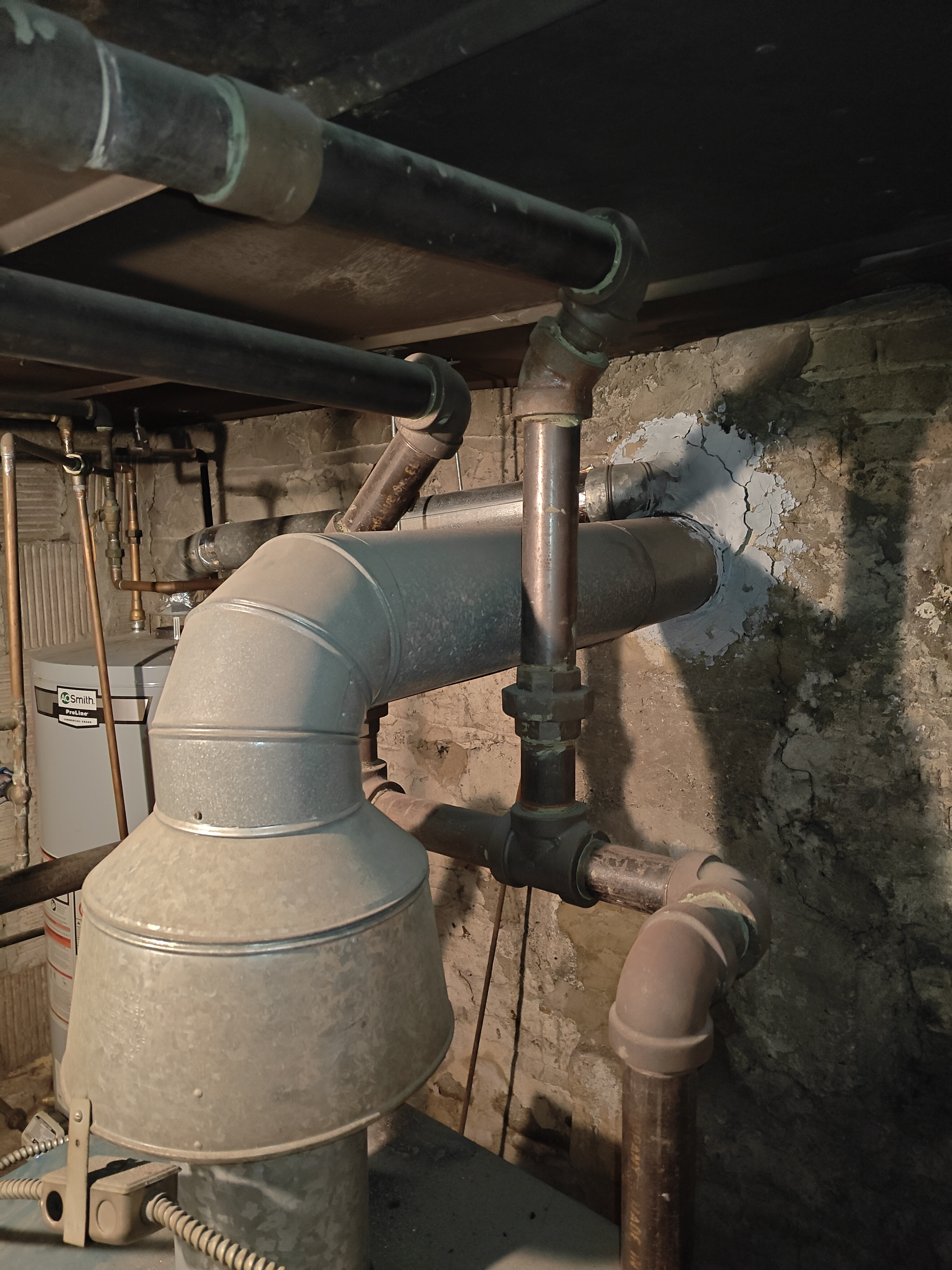

Did you ever post pictures of the old boiler?
I posted a few in my original post, I can post better ones now
Front view:

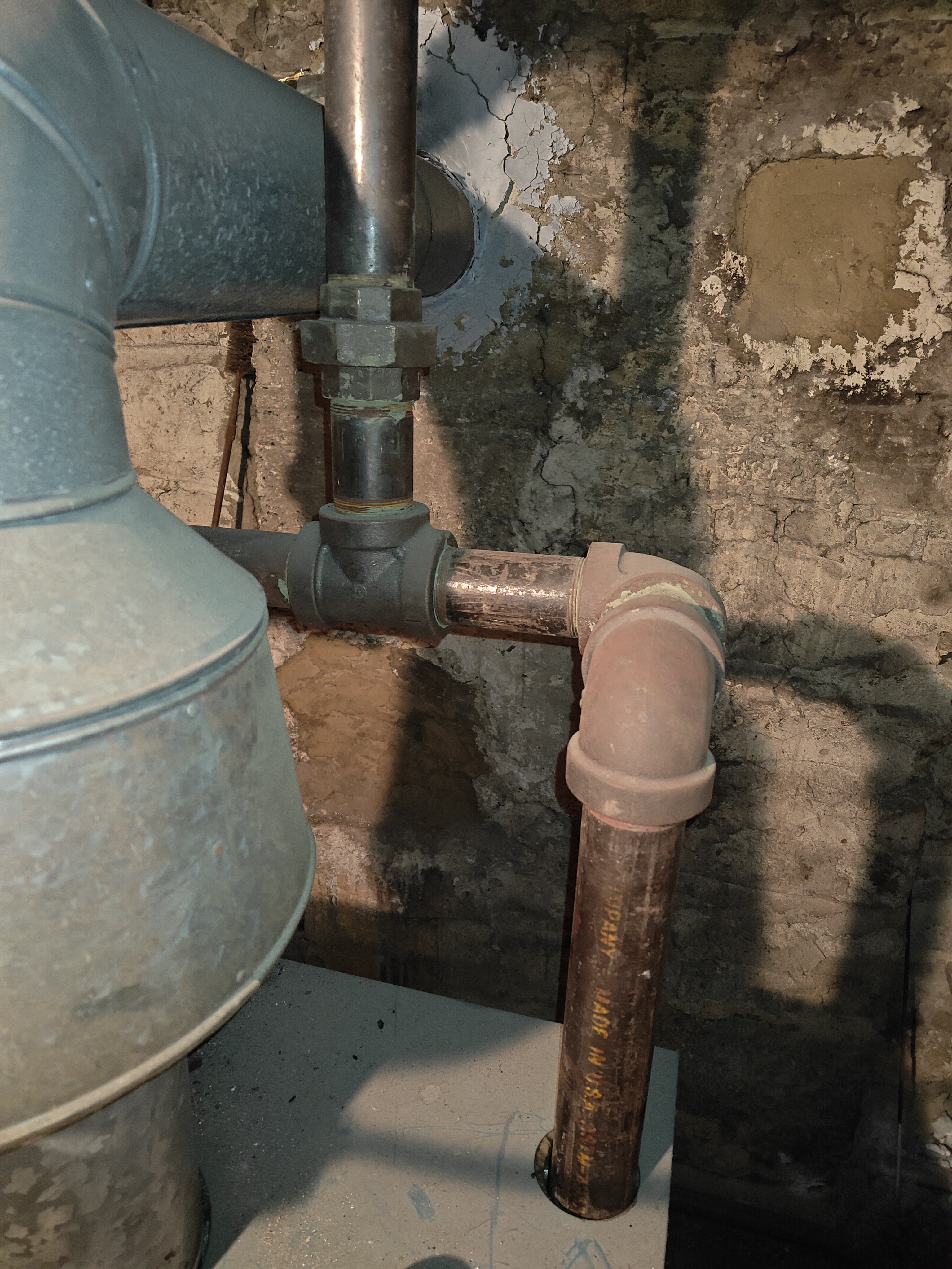

Riser and Header:
Side view + Controls:

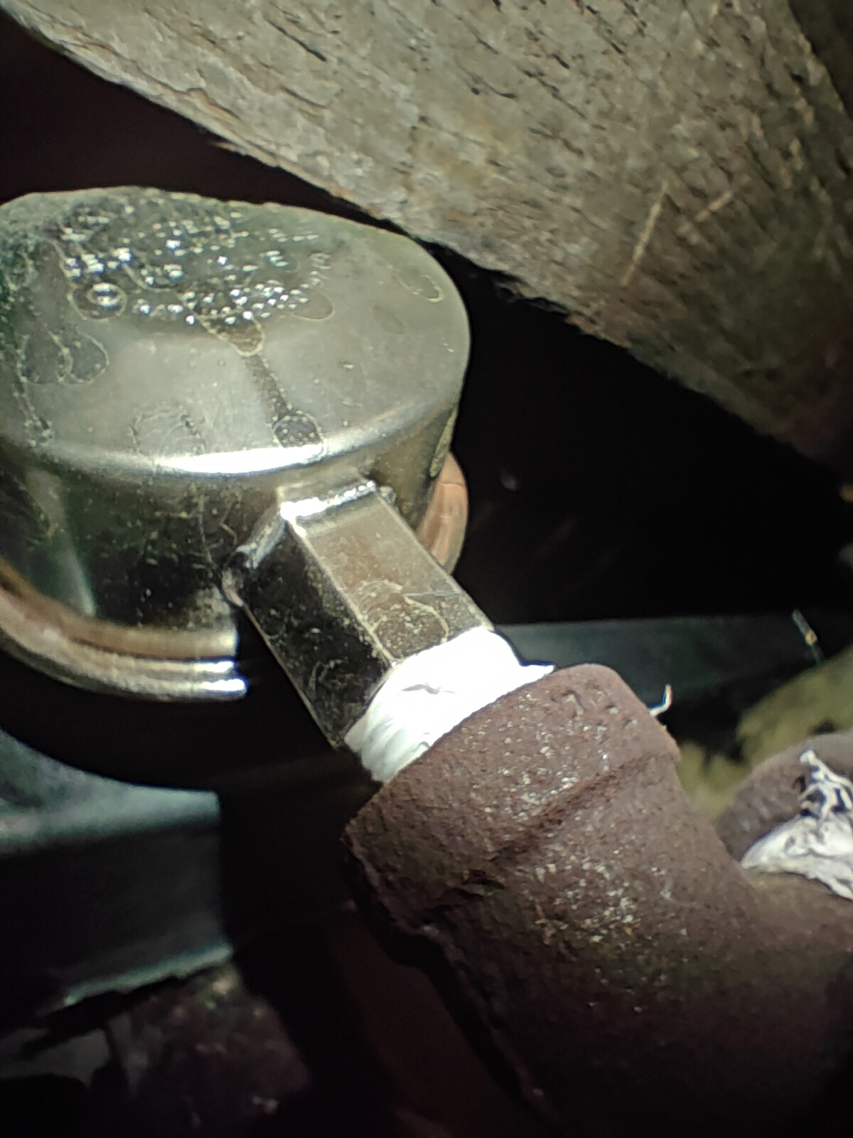

Main vent - front of building (it's a MoM #D):
Main vent - Rear (it's tucked in to a hole in the wall)
