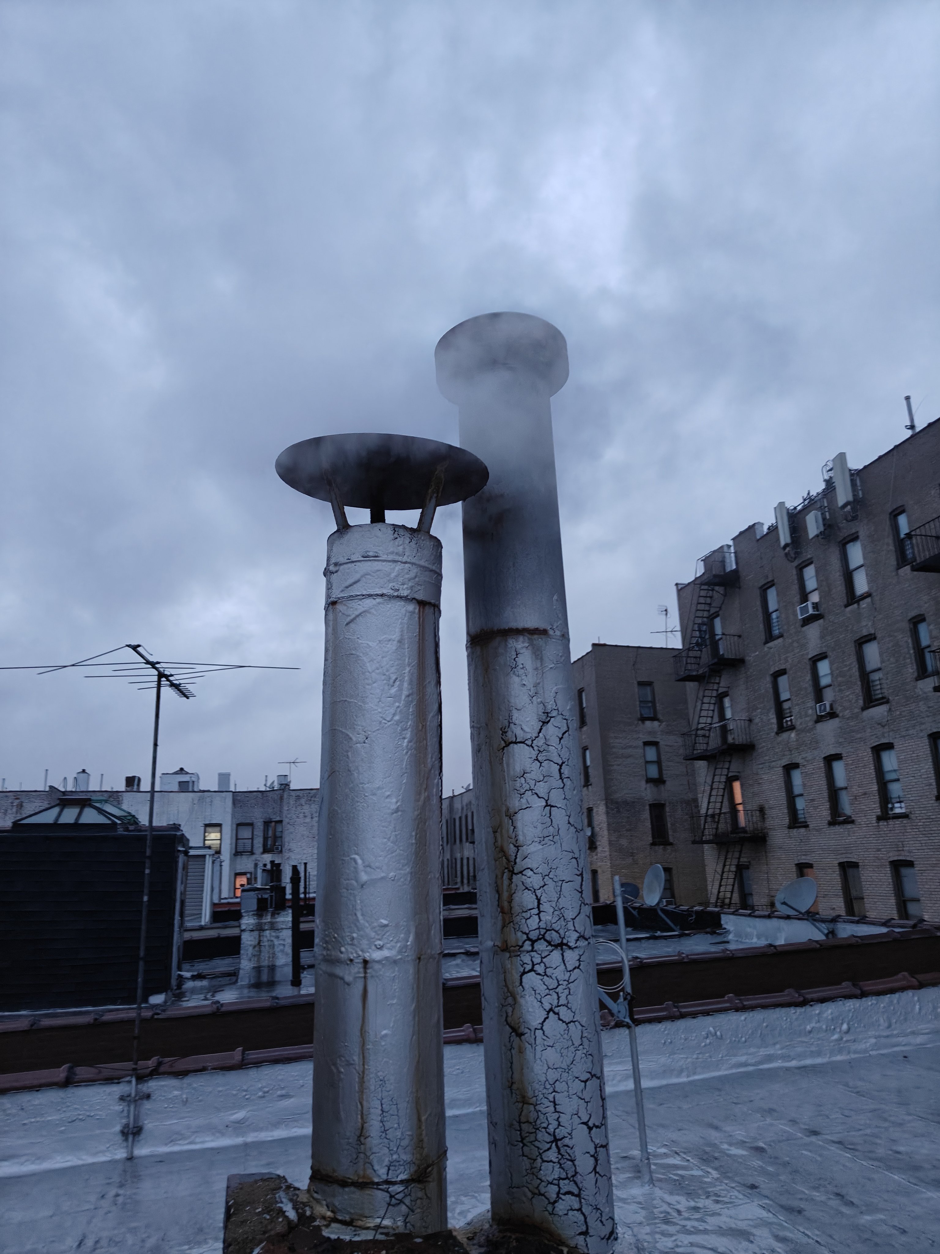

  4. Chimney - the quote says that it doesn’t include Chimney lining or cap. I’m not quiet sure what that is or if I need it.

    Definitely a good idea to have the chimney inspected and lined if necessary. And to have a chimney Cap added if necessary. But typically that's not the job of the boiler company. Will typically be done as a separate job by a chimney company

    If you have concerns about the chimney, contact a chimney company and have it inspected and see if they recommend having it lined. If I was guessing, they will suggest it needs lined.

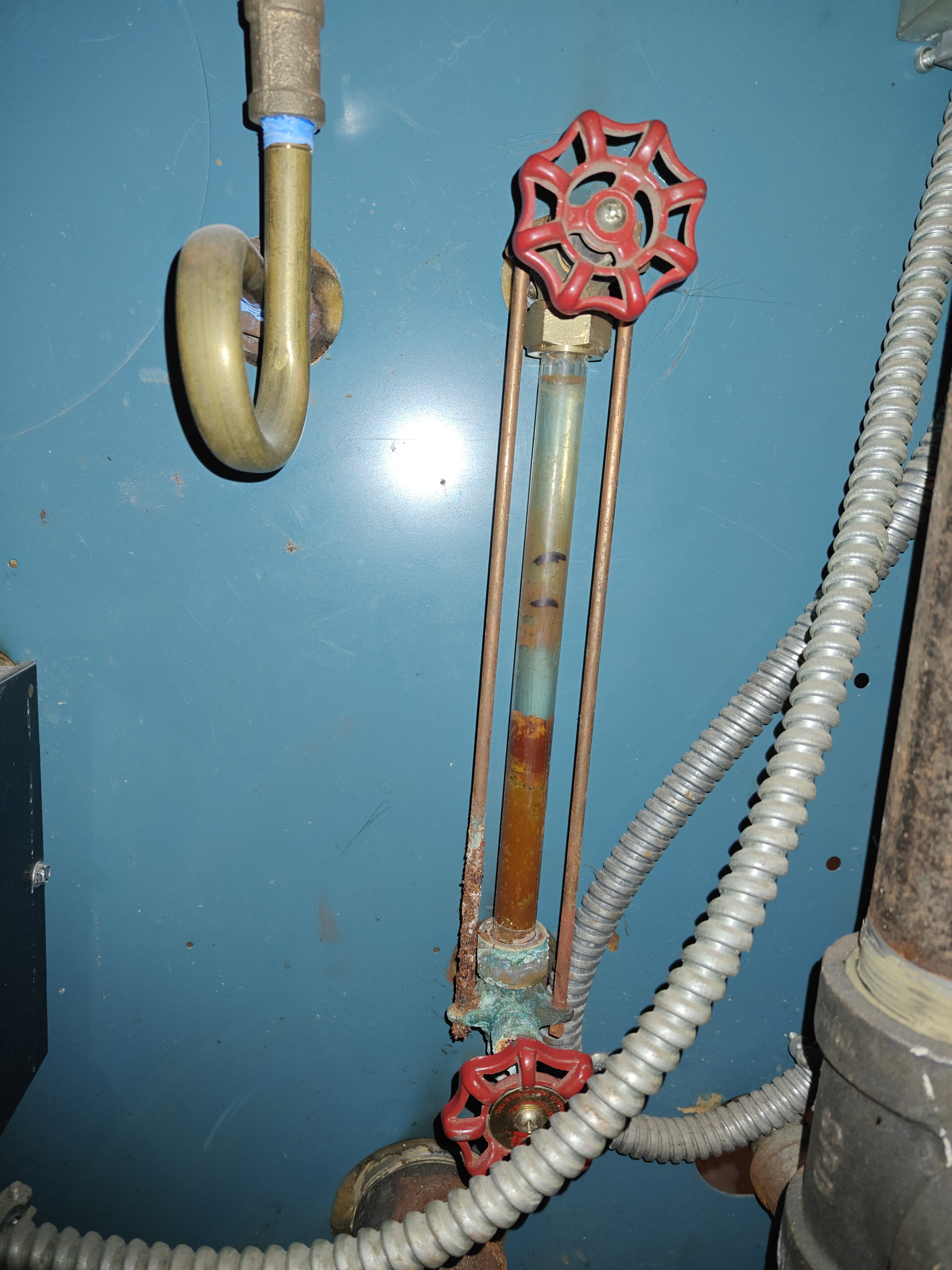

  • Itzyklein
    Itzyklein Member Posts: 16
    I dont have a clear amount but the low water cutoff is kicking in and turning off the boiler, then the automatic feeder kicks and the boiler comes back on a short while later. When I add a few inches of water in the sight glass within a few days its back to the low water cutoff kicking in

    mattmia2 Member Posts: 16,670
    I would start with the symptoms and that someone told you it needed to replaced when you call one of the NYC contractors, have them diagnose it first rather than asking for a replacement. It could be a return leaking somewhere where you can't see it or condensate that is delayed in returning to the boiler or water getting thrown in to the mains from the boiler and tripping the lwco.
    There can be other places besides the boiler for leaks and there can be system issues that cause the water to leave the boiler and trip the lwco.
    If you fill the boiler to the mark on the sight glass while it is off, if you check it over a couple days(or hours if it is leaking a lot) during the off cycle, does the water level fall?
    CLamb
  • Itzyklein
    Hi
    I did the test and got confirmation
    I opened the water supply to the boiler and watched the level rise in the sight glass. As the level reach the top of the sight glass I heard water dripping and saw it pouring out over the burners
    I lowered the water level to the higher black line on the sight glass and fired up the boiler. I went to the roof and saw clouds of steam coming out of the chimney. Within an hour the water level was so low that the LWCO turn off the boiler until the feeder topped it up
    Looks like it's time to replace?
    yes, new boiler time.

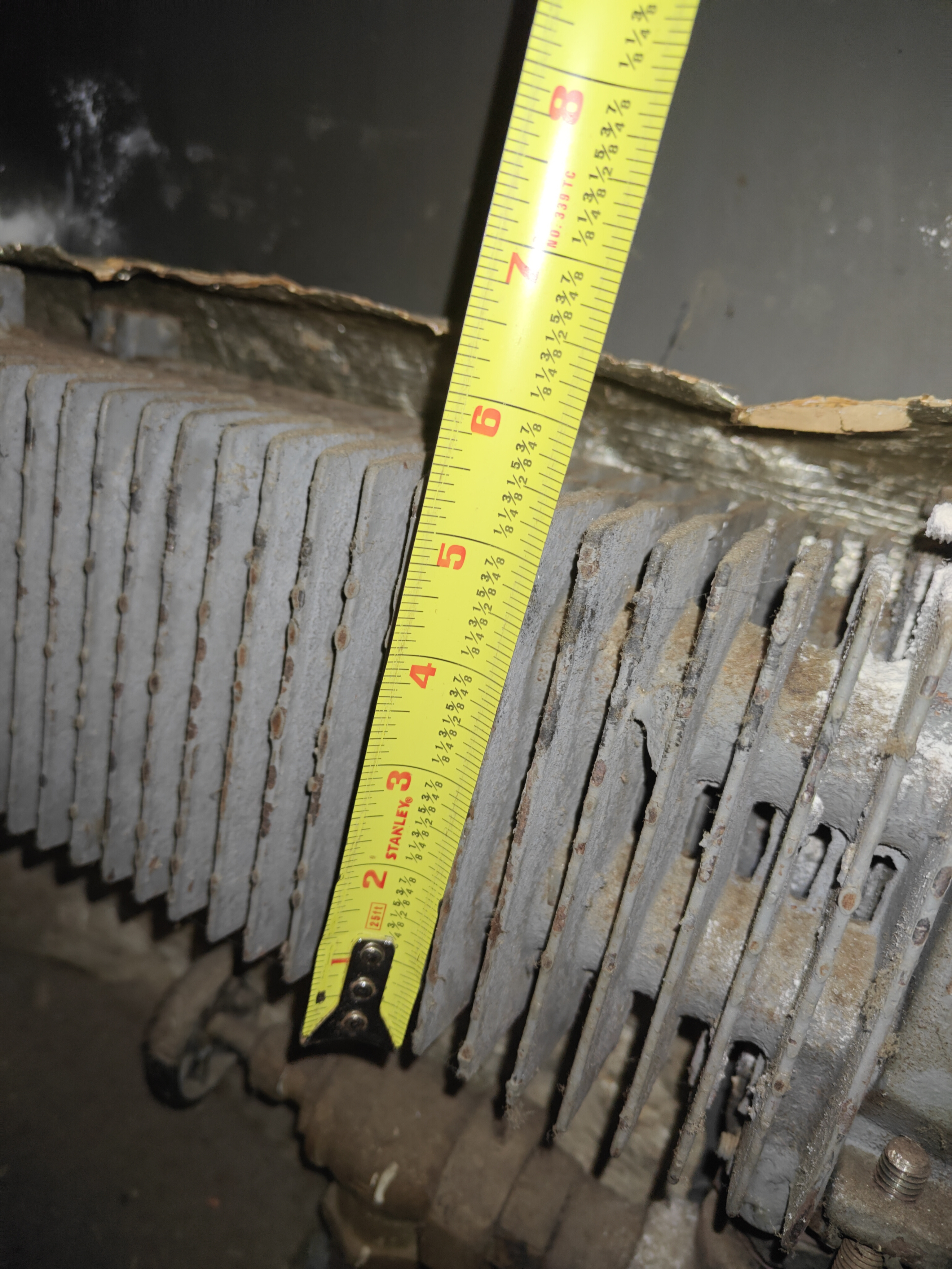

    Hi all,
    Thanks so much for your advice so far, I've learned so much from this chat and from browsing around other chats and articles
    I measured all my radiators in the building, we have a total of 16. Most are the same type, and then a few odd ones as follows:
    12 radiators are the old style column radiators, all are the same depth and height (3 columns = 9 inch deep, and 38 inch high) They vary between 4-7 sections per radiator to a total of 69 sections between all the radiators. The charts say 5 EDR per column. That comes to 345 EDR so far
    IMG20250216171017.jpg IMG20250216171116.jpg IMG20250216171059.jpg IMG20250216171059.jpg
  • Itzyklein
    edited February 2025

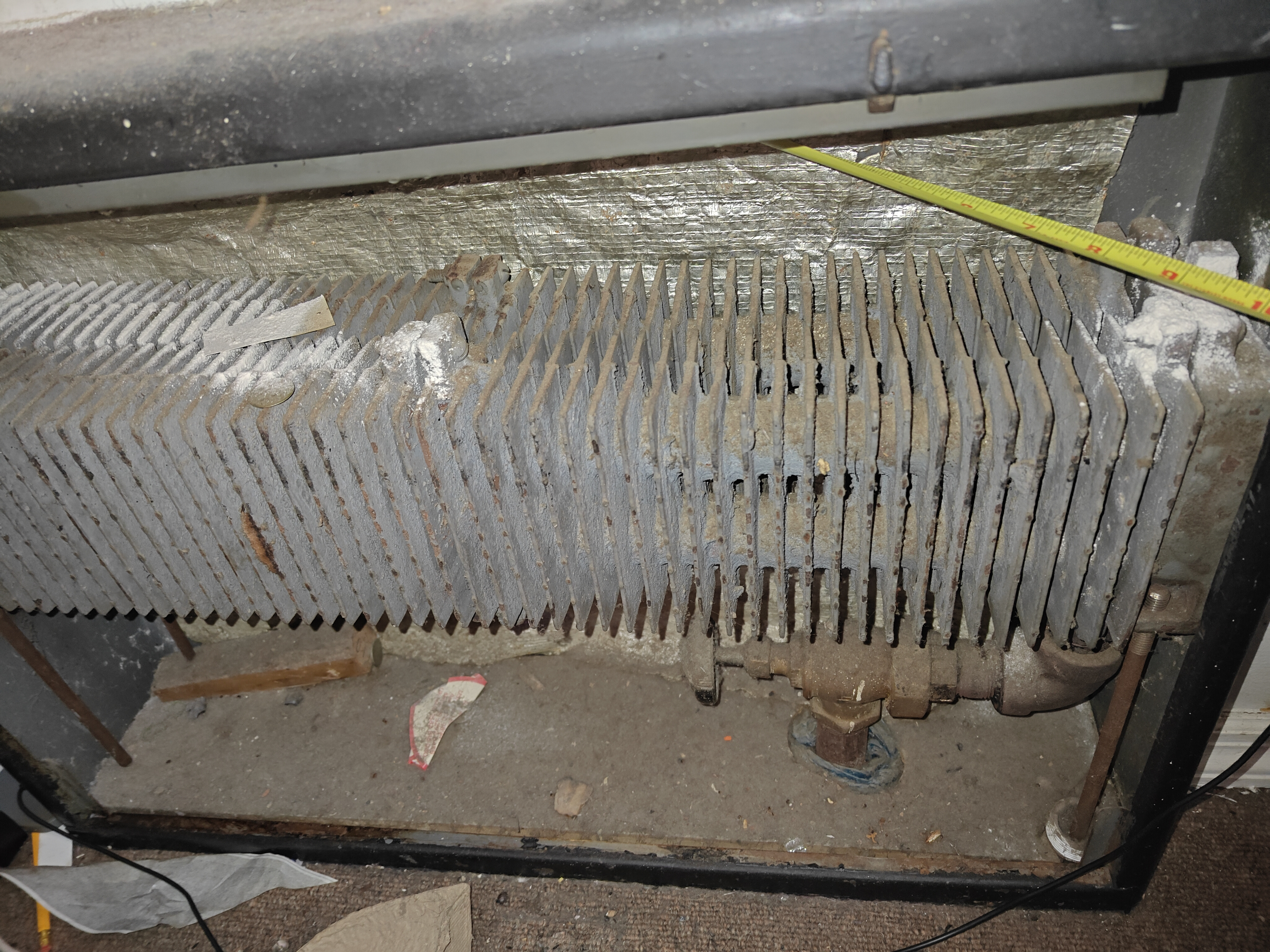

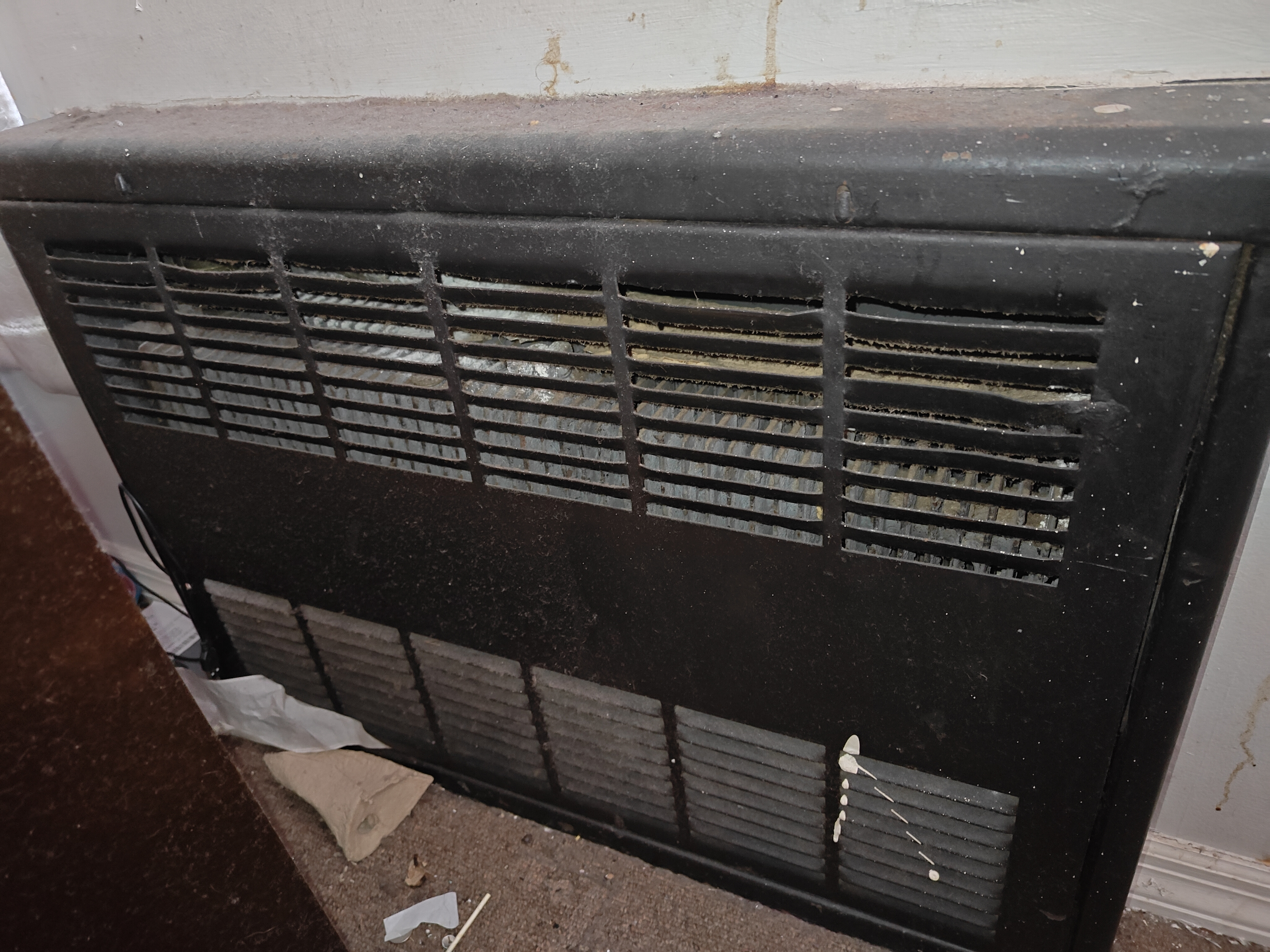

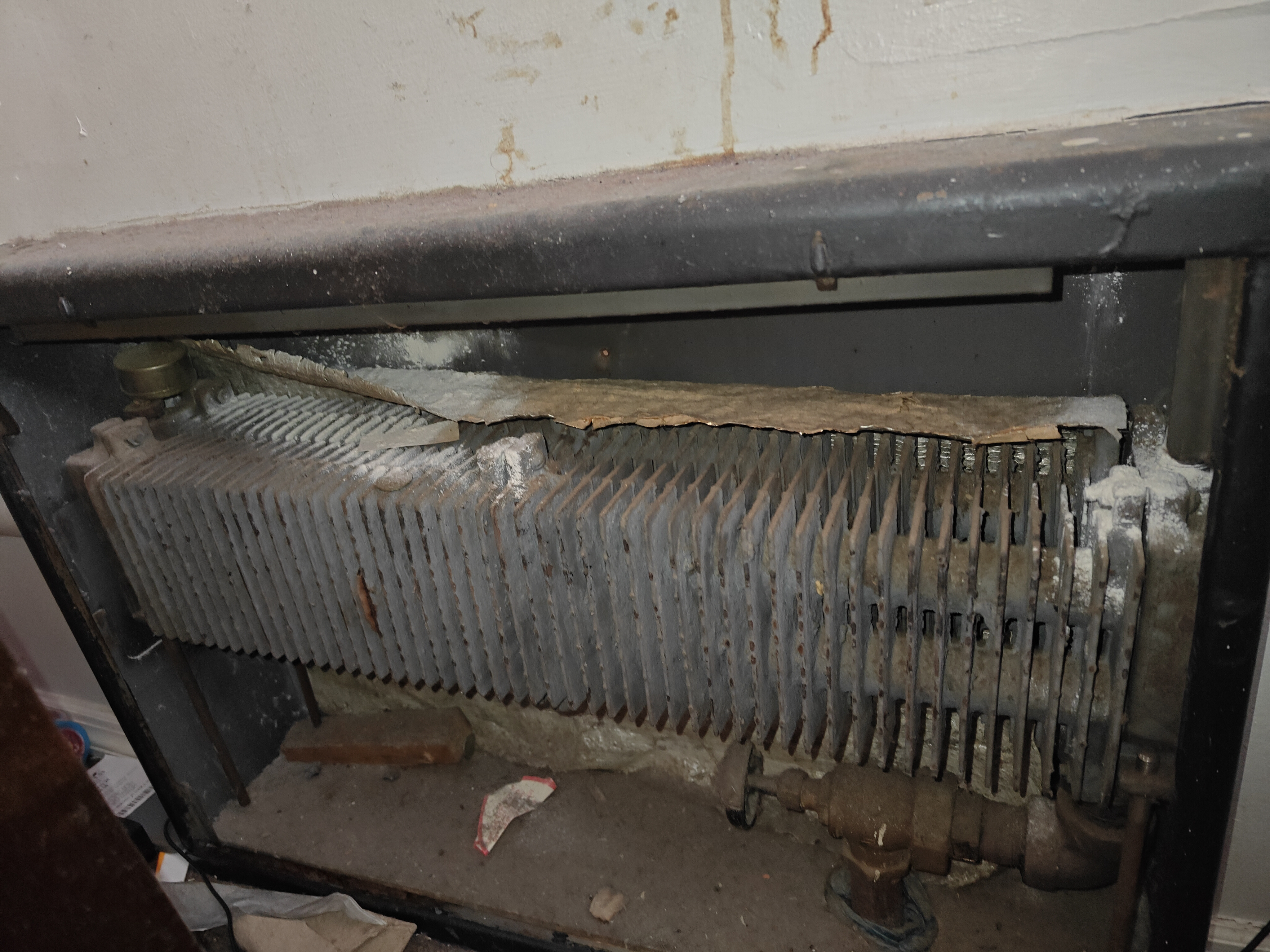

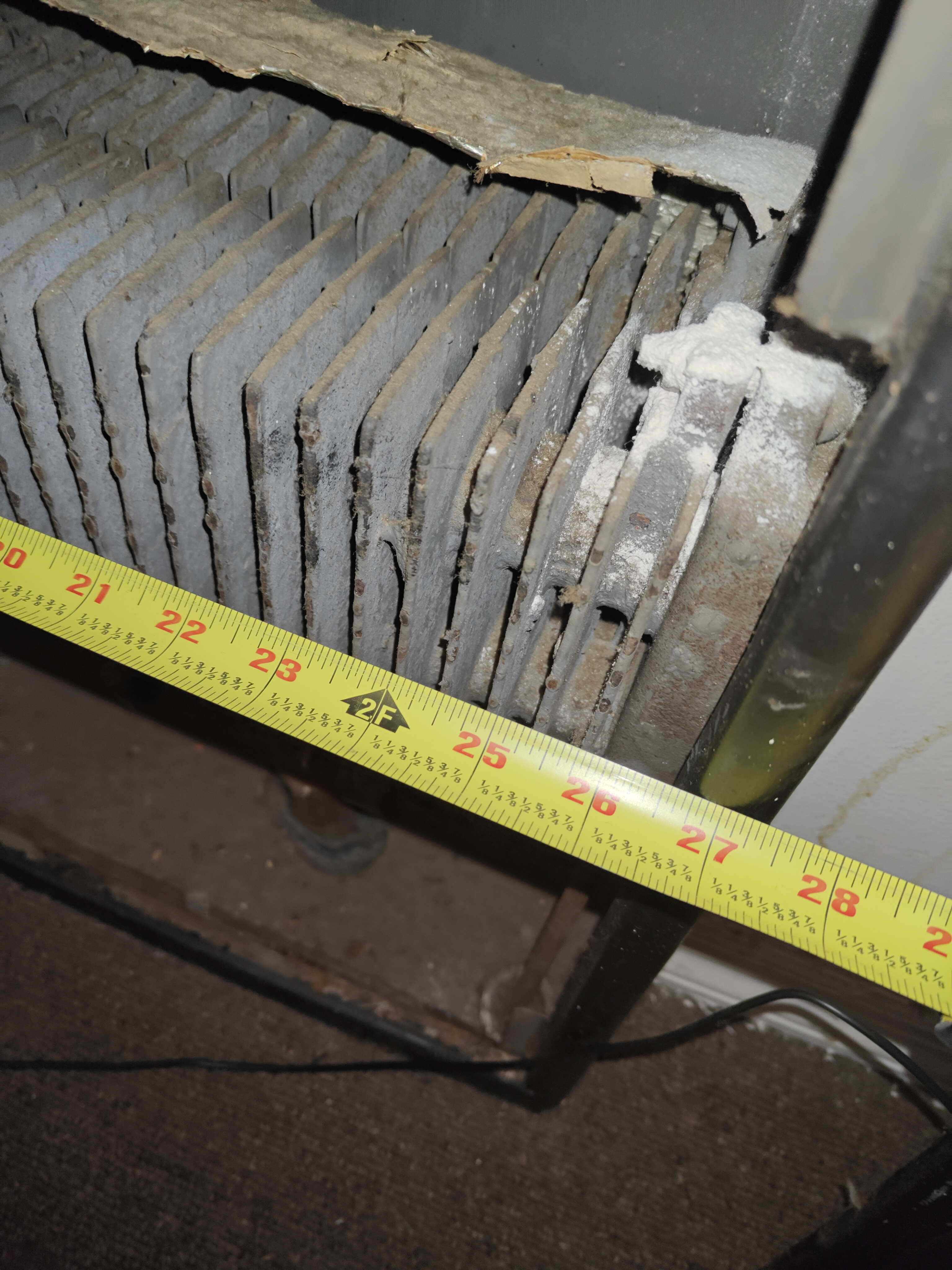

    Then we have 3 recessed / enclosed radiators. Inside they seem to have 4 tubes with fins. I need help to identify them and figure out their EDR. They are all 6 inches deep and 5.5 tall (measured from the bottom of the radiator, not from the floor) they are about 28 wide
    I don't know what this type of radiator is called or what its EDR ratings are
  • Itzyklein

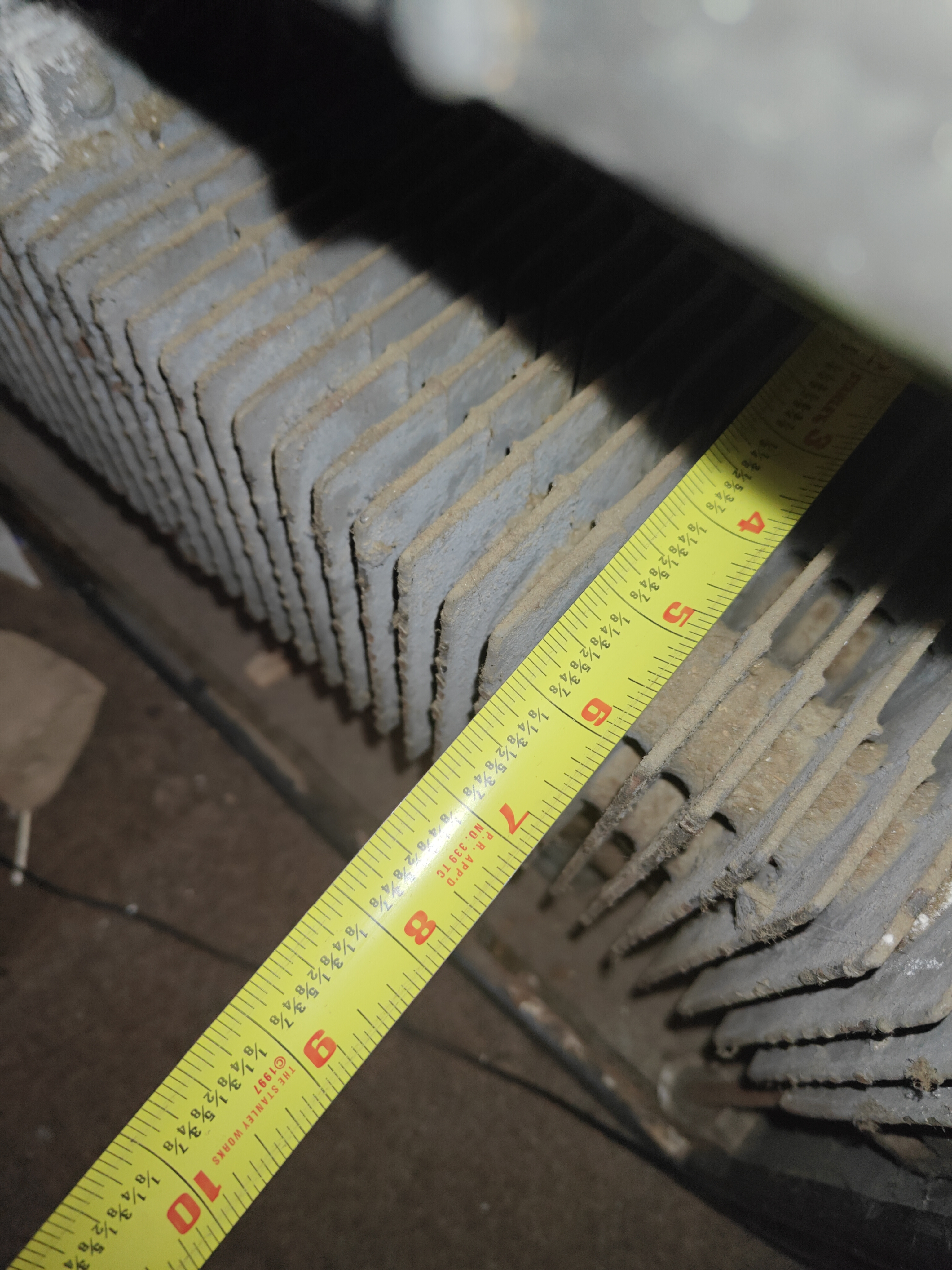

    The last radiator is the odd one out, it has 4 tubes, is 6 inches deep and 30 inches high with 10 sections, the height doesn't match up with the charts and I can't make out any of the markings on it
    IMG20250221152333.jpg IMG20250221152224.jpg IMG20250221152231.jpg IMG20250221152234.jpg IMG20250221152239.jpg IMG20250221152325.jpg
  • Long Beach Ed
    Long Beach Ed Member Posts: 1,833
    The cast iron convector elements are similar to the ones I linked below sold today by OCS.
    https://ocsind.com/wp-content/uploads/2016/05/15981-OCS-Catalog.Updated15-11.pdf
    Your 28" ones are about 26 sq. ft. of EDR each.
    Maybe someone can offer a more precise rating, but this should be a close estimate.
    ethicalpaulItzykleinLRCCBJ
  • KC_Jones
    KC_Jones Member Posts: 5,933
    I can't find that exact one in the charts either, but based on ones that are close I'd go 3 per section, so 30 for that one. If the entire house was filled with them I'd advocate for digging deeper, but one radiator isn't going to throw things off that much. Add that 30 to the 26 per recessed convector and I get 453 total.
    In the Williamson line that would put you exactly at the GSA-175, you got quoted the GSA-238 which is 2 sizes bigger, do not let them install this, it's far too big. They sized off the old one, which is totally wrong.
    2014 Weil Mclain EG-40
    ethicalpaulItzykleinSTEAM DOCTORbburd
  • Itzyklein
    Whoa! 2 sizes too big!!
    My estimated calculation also came to about 450.
    The mains in the basement are about 80 feet long and are not insulated, neither are any of the risers or returns. Do we need account any additional EDR for those?

    Steamhead Member Posts: 18,465
    All Steamed Up, Inc.
    Towson, MD, USA
    Oil & Gas Burner Service
    Consulting
    I looked here and found one that was very close:
    https://www.heatinghelp.com/assets/documents/American-Radiators.pdf
    Use the 4-tube Corto chart. Their version is 32 inches tall and 35 square feet. ISTR that the National Aero rads that were 30 inches tall had the same EDR as the 32-inch Cortos.

  • random12345
    random12345 Member Posts: 504
    The 4 tube rad is 3.5 sq. ft./section x 10 sections = 35 sq ft.
    https://babel.hathitrust.org/cgi/pt?id=mdp.39015035429805&view=2up&seq=1713&size=175&q1=r174-40
    It was a standardized size. It's too bad the writing around the top plug is hard to make out. I would have liked to have been able to identify it. There were a couple of manufacturers that made 30" tall rads. National Radiator made the Aero, and Columbia made the McKeesport. I thought it looked very similar to a Thatcher Gothic, but the legs aren't consistent with that and height is too short…mystery. Maybe if you took a picture of the other side, the writing would be clearer? Won't change the EDR though.
    I agree with you about the column rads. If they are all 3 column, 38" tall, then it's 5 sq. ft/section. If you can take a pic of the clearest writing around the bottom you can find, that would help identify if you're curious. See below.
    As for the convectors, if you want the most exact ratings, I would need to know the manufacturer. Otherwise it's just an approximation, which might be good enough. Take a look underneath, top and sides of each convector with your phone camera for any writing. The cabinet may also have writing/identifying marks. Possibly behind the grille too. If you come up empty, I'll have to guesstimate.
    I think those column rads were made by Republic Radiator Co., but they are standard units so any standard 3-column chart will do.
