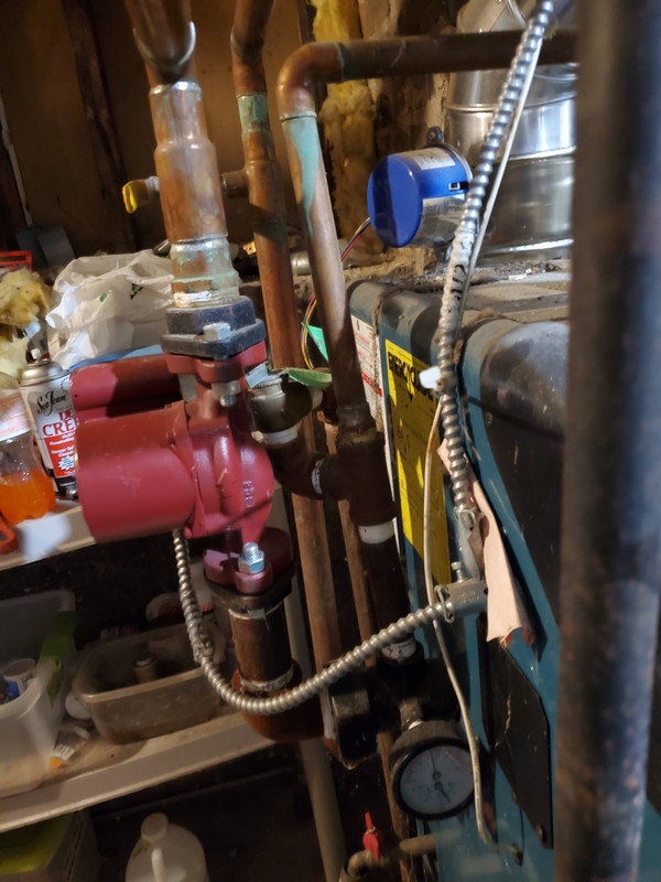

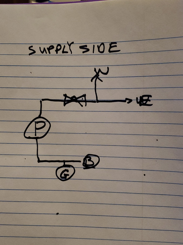

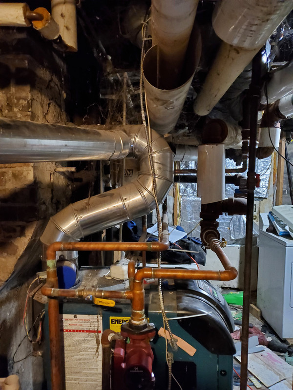

    Here are photos. I split the diagram into 2 parts. Any comments appreciated. I did not solder anything. The boiler was installed like that. I had to try 3 photo sharing programs so I hope these work. Also I do not have the burnham IQ feature.
    Boiler photos
    Untitled Image Untitled Image Untitled Image Untitled Image Untitled Image Untitled Image Untitled Image Untitled Image Untitled Image Untitled Image Untitled Image Untitled Image Untitled Image
    Home owner near Minneapolis with cast iron radiators, one non working slant fin now ripped out, and hot water heat.
    EdTheHeaterMan Member Posts: 10,587
    edited February 25
    Can you get a photo from farther back? Trying to put the pieces together like a puzzle is difficult. even with the diagrams I can get that you are having 2 problems.
    1. Not enough heat
    2. Relief valve releasing water/Pressure in boiler too high
    Number 2 may be causing the other problem.
    you need to be sure that the expansion tank has enough air in it. Air in the expansion tank is the cushion for when the water expands as it gets hotter. If there is not enough air in the tank to compress, as the water in the system expands, the pressure will get too high and the relief valve will release water on the the floor.
    To get air in the expansion tank you can open a boiler drain in the system somewhere (you already have a hose on it) and let water out of the boiler. This will lower the boiler pressure to zero on the gauge. When that happens you can open the drain valve on the expansion tank just a little and you will hear Air gurgle into the tank.   Open it just enough to get the air to go in as the water leaves the boiler at the bottom drain valve.

    I'm not a heating pro, just a homeowner/mechanical engineer with a similar expansion tank setup that had air management problems that I was able to fix after learning a lot from the helpful heating pros here.
    No doubt they will have good advice for you. Meanwhile, I see a few obvious things:
    1. Boiler pressure gauge reads 30 psi at 140 degrees. Most residential boiler pressure relief valves are set to relieve at 30 psi, so you are perilously close to popping the relief if that gauge is correct. If your system was set up correctly, it shouldn't be above 20 psi or so at that temperature.
    2. You expansion tank setup is going to allow dissolved air to migrate from the tank back into the circulating water, where it will end up in your radiators and require regular bleeding. This can be fixed by replumbing the expansion tank with an Airtrol fitting, but that may not be your priority right now.
    3. If the 30 psi gauge is correct, it also means that your tank is probably waterlogged, ie too much water and not enough free volume left for the water to expand into. This can be remedied by draining some water out of the tank to free up more volume for expansion, but it does take a few specific steps to do correctly.
    4. The ease with which air from the expansion tank can migrate back into the circulating water, plus the apparent water-logging of the tank, all suggest air management problems that may be interfering with circulation.
    Even if it turns out that the root cause of your problem is something else, your expansion tank/air management system could be improved if you want to not have to bleed your radiators regularly.
    HVACNUT Member Posts: 6,792
    If the gauge is right, the expansion tank needs to be drained.
    With that amount of water, it should've been piped P/S. I would try closing the bypass. What speed is the circulator on? Not sure if that's correct either.
    jesmed1
    @eclecticmn, I agree with @jesmed1 on the long term air control issue/fix. But I just edited the post just before his with what you can do NOW to get up and running.

    That's a good idea from @HVACNUT to close the bypass valve, at least for now. That should force more hot water into the supply mains and reduce the potential for short-cycling. The bypass valve is circled in red below. Right now it's fully open, meaning a good portion of your hot supply water is recycling directly back into the return instead of going out to your radiators.
    Good idea also to check circulator speed and make sure it's on max.
    What does that mean? The amount of water in the tank/ P/S?

    Don't worry about that. It's piped the way it's piped, and you can make it work the way it is.
    The bypass is there to prevent too-cold water from returning to the boiler, which could cause thermal shock to the cast iron and risk cracking it (which almost never happens anymore) or could cool the boiler's exhaust gas too much, causing water vapor to condense in the exhaust stream, which can corrode the inside of the boiler.
    So the mfr typically requires a bypass valve which returns some of the hot supply water back to the boiler, raising the temp of the return water.
    I have two boilers where the mfr also required a bypass, but none was installed, and 30 years later the boilers are still fine. So the necessity for a bypass in some situations is debatable. The good news is that your installer did what the mfr required and installed one.
    By closing the bypass valve, you force all the hot supply water to go out to your radiators, where you want it. And since your supply water is already getting fairly hot, it will still be fairly hot when it returns. I'm not an expert, but I think the rule of thumb is that as long as the return water temp gets up to 130 within 10 minutes of the boiler starting from cold, that's fine. My two boilers take even longer to reach 130 return (like 30 minutes) and as I said, they're still fine after 30 years.
    To answer your question about the 0 psi, when the boiler gauge shows 0 psi, the boiler and all your pipes and radiators will still be full of water. The only thing that will have lost water is the expansion tank, because as you drain the boiler down, water from the pressurized expansion tank will be forced into the boiler to replace the water you drain, so the boiler and all the pipes and radiators will remain full. So by opening the boiler drain valve, you're actually draining the expansion tank, which is the ultimate goal.
    Just follow Ed's instructions and all will be well. 😊
