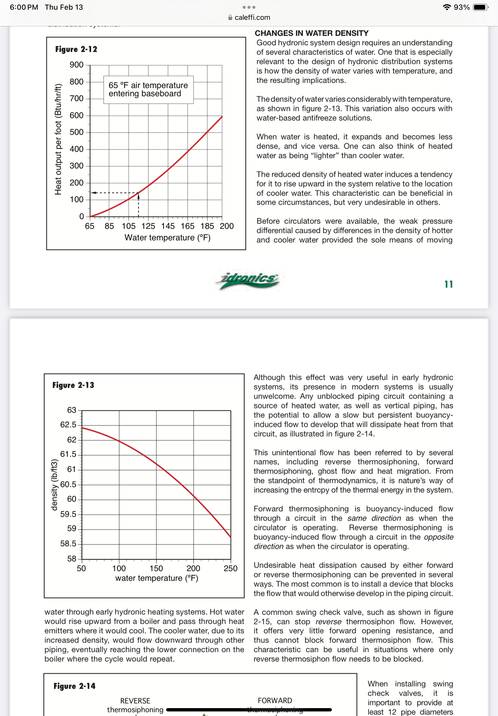

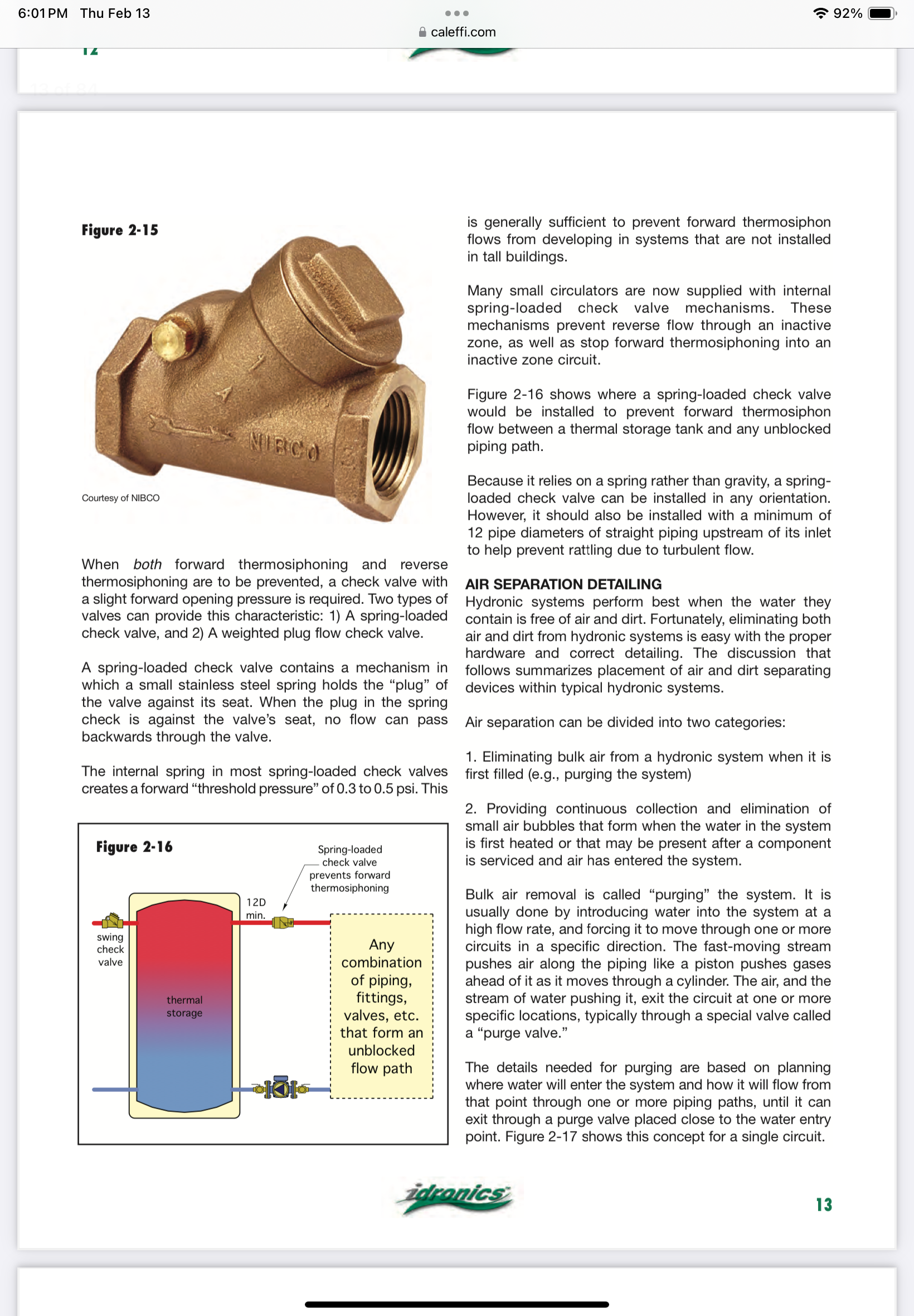

    hot_rod Member Posts: 27,308
    if it has worked in the past, look for something holding the flo check open a small amount.
    If it has always over-heated it could be a case of forward or reverse thermosiphoning. Driven by the buoyancy of the hotter water.
    The concept behind gravity distribution systems.
    From Idronics 19
