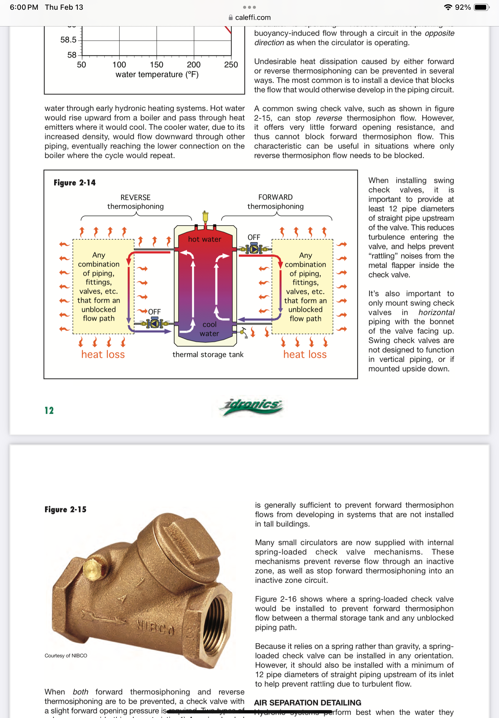

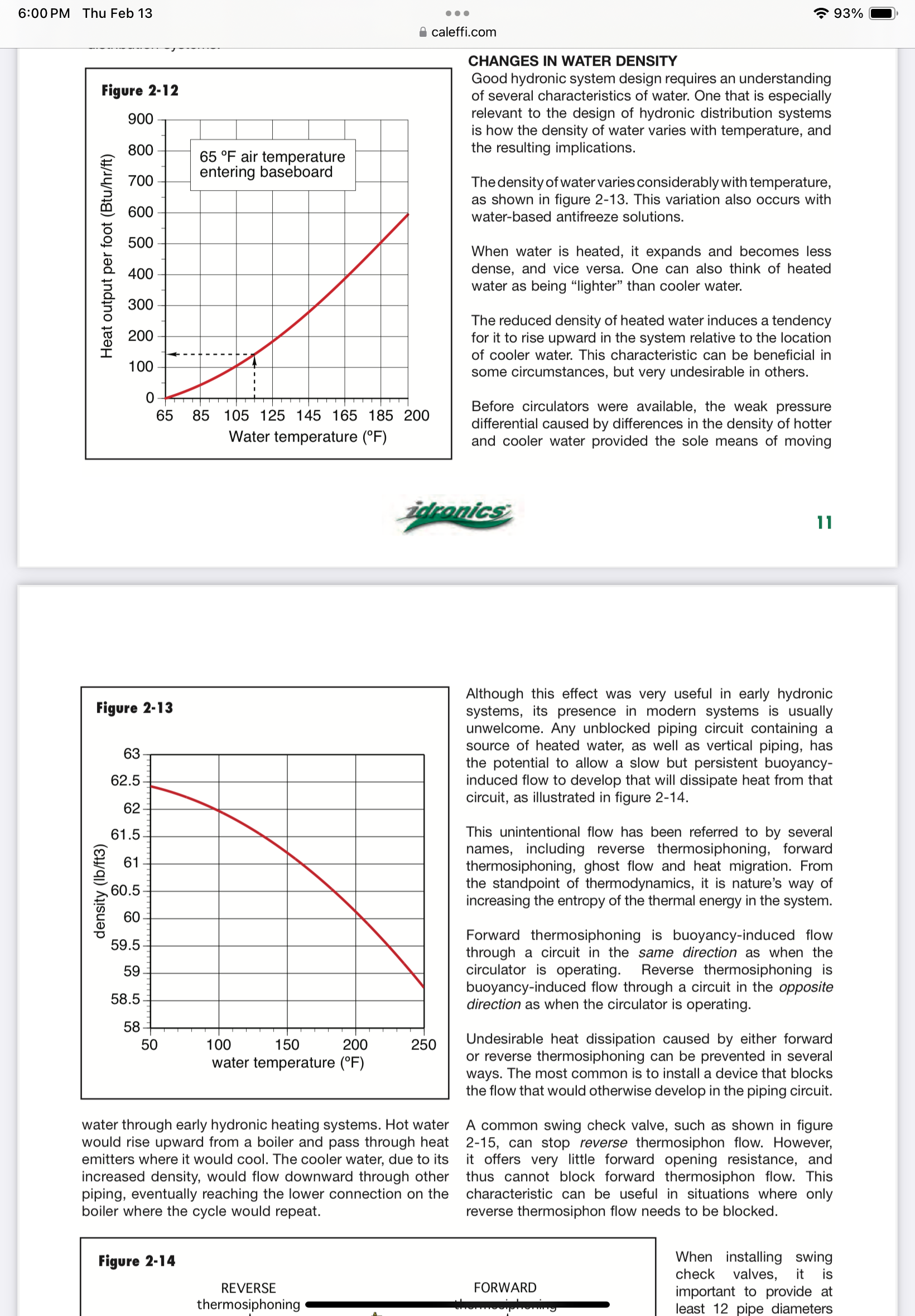

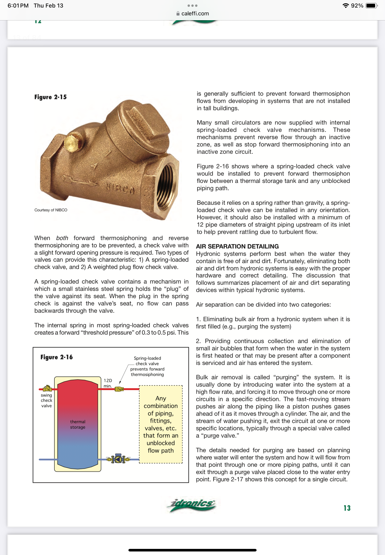

    hot_rod Posts: 28,699
    if it has worked in the past, look for something holding the flo check open a small amount.
    If it has always over-heated it could be a case of forward or reverse thermosiphoning. Driven by the buoyancy of the hotter water.
    The concept behind gravity distribution systems.
    From Idronics 19
  • Stuck flow valve. Turn up the zone to run the circ. Tap on the flow valve to loosen up and move out whatever debris is holding it open. Then turn the zone back down and wait a day to see if the rads. cool off.
