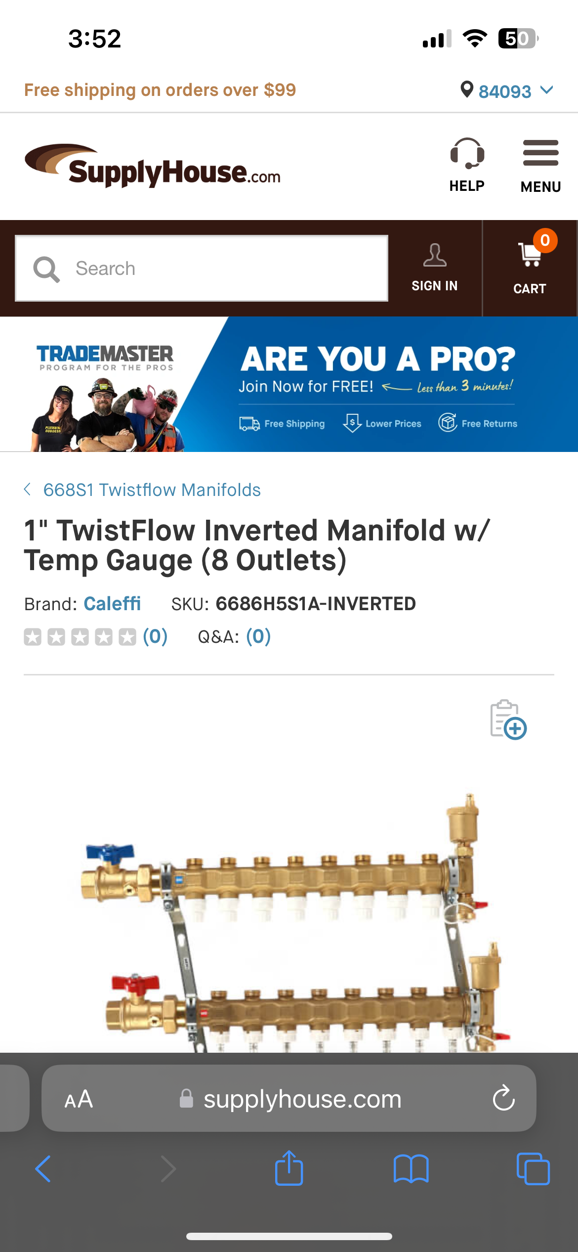

    Ok. Ready to purchase the manifold and have a few more questions:
    Thinking I will buy the 66851. Or does the Alpha pump function in place of the balancing feature of that manifold?
    Will be mounting it upside down. Can I purchase directly from Caleffi, or do dealers (like Supply House) order the units in upside down configuration?
    Do I need to use the hermetically sealed actuators for my application?
    I have three zones. Rather than building the two port manifold for M-2 (as described above), is there any reason to use a four port Caleffi and connect those two loops with a pair of actuators wired together?
    Thanks!
    hot_rod Member Posts: 26,518
    If you are zoning, I would go with the Alpha
    The circ is more efficient and it will vary flow as zones open and close
    The only balance would be different loop lengths on a zone.
    Yes you can wire two actuators together
    Adding the suffix IN gets you an inverted model
    The wholesaler you buy from may have a different part number, however. Here is the Caleffi numbers
    If it is heating only, go with TwisTop actuators. Sealed are more for chilled water where condensation is possible
    Thanks for shopping Caleffi

    Will the inverted unit have it's inlet and outlet ports on the right side? That would be a strong preference if possible.
