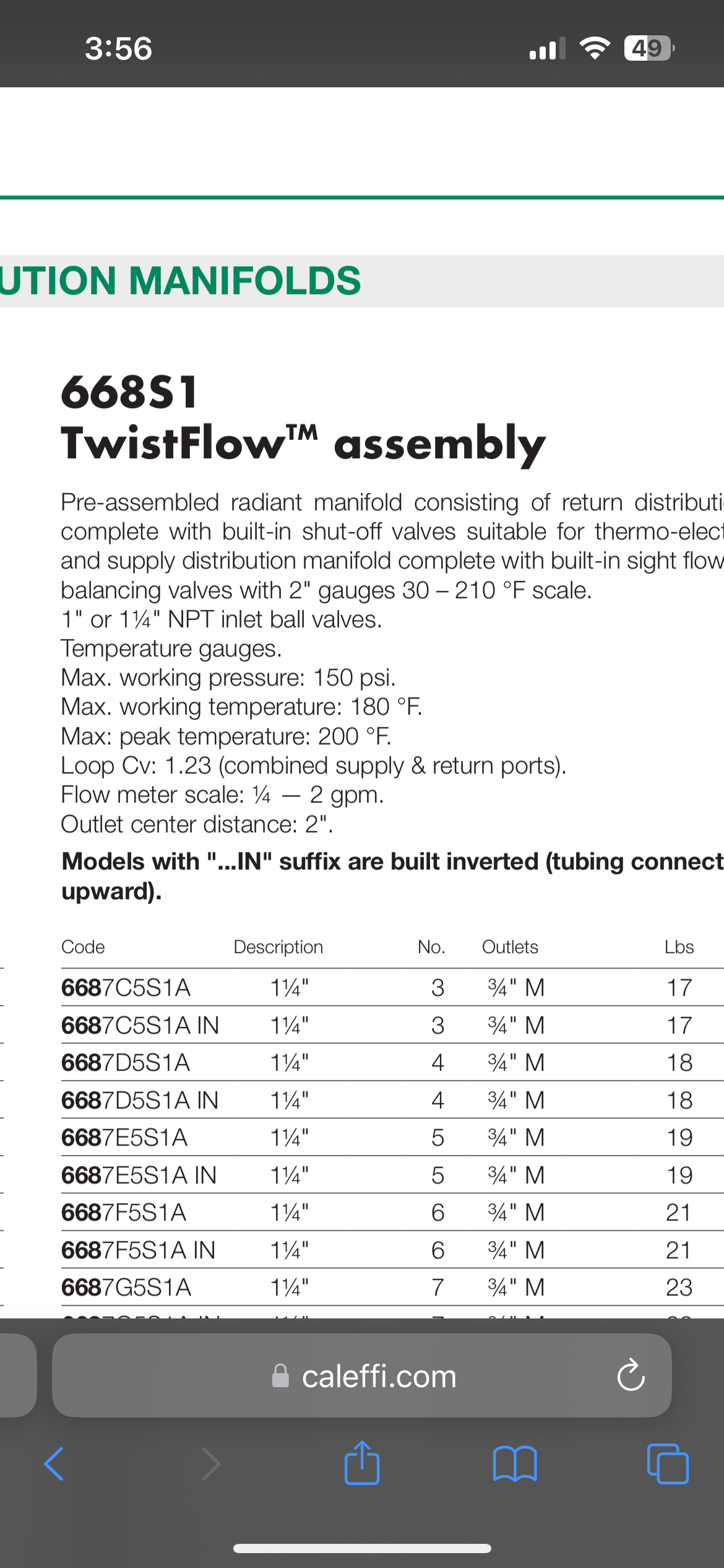

    Adding the suffix IN gets you an inverted model
    The wholesaler you buy from may have a different part number, however. Here is the Caleffi numbers
    If it is heating only, go with TwisTop actuators. Sealed are more for chilled water where condensation is possible

    Will the inverted unit have it's inlet and outlet ports on the right side? That would be a strong preference if possible.

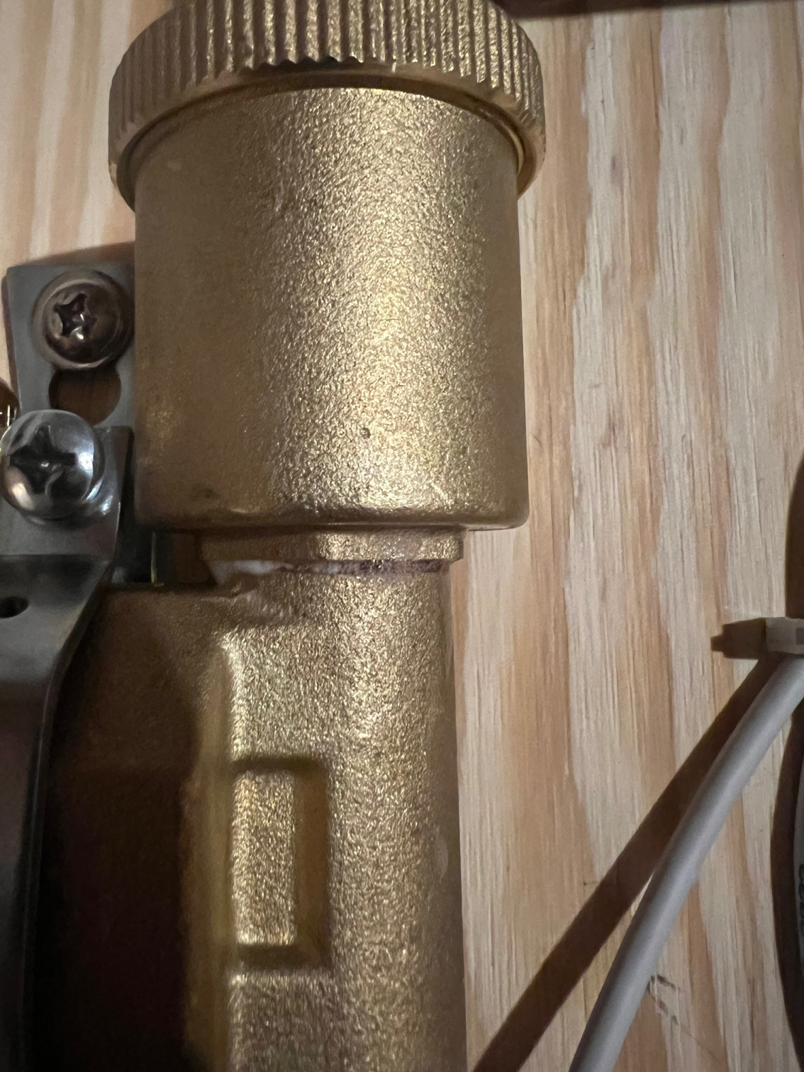

    There is a very slow leak on the
    feed side of my Caleffi manifold where the automatic air vent threads into the manifold body (pic). Can I simply unthread the air vent and apply pipe sealant? The part appears to need a specialized thin wrench. Thinking that I will have to remove the part by using a pipe wrench on the cylindrical body….Thanks!
    hot_rod Posts: 28,705
    I think it is a straight BSP thread with a fiber washer below. That is odd as they pressure test each manifold with air and a leak down gauge.
    Let me check with assemble as to how they wrench that in.

    Thanks, think I will cut a wrench out of 1/8" steel plate, and await word on the what seal was used.
    That vent is hand tightened in with Loctite 545. I've found you can heat that thread just a bit with a torch and it will screw out, so you can reseal it.
    Sorry about the seep

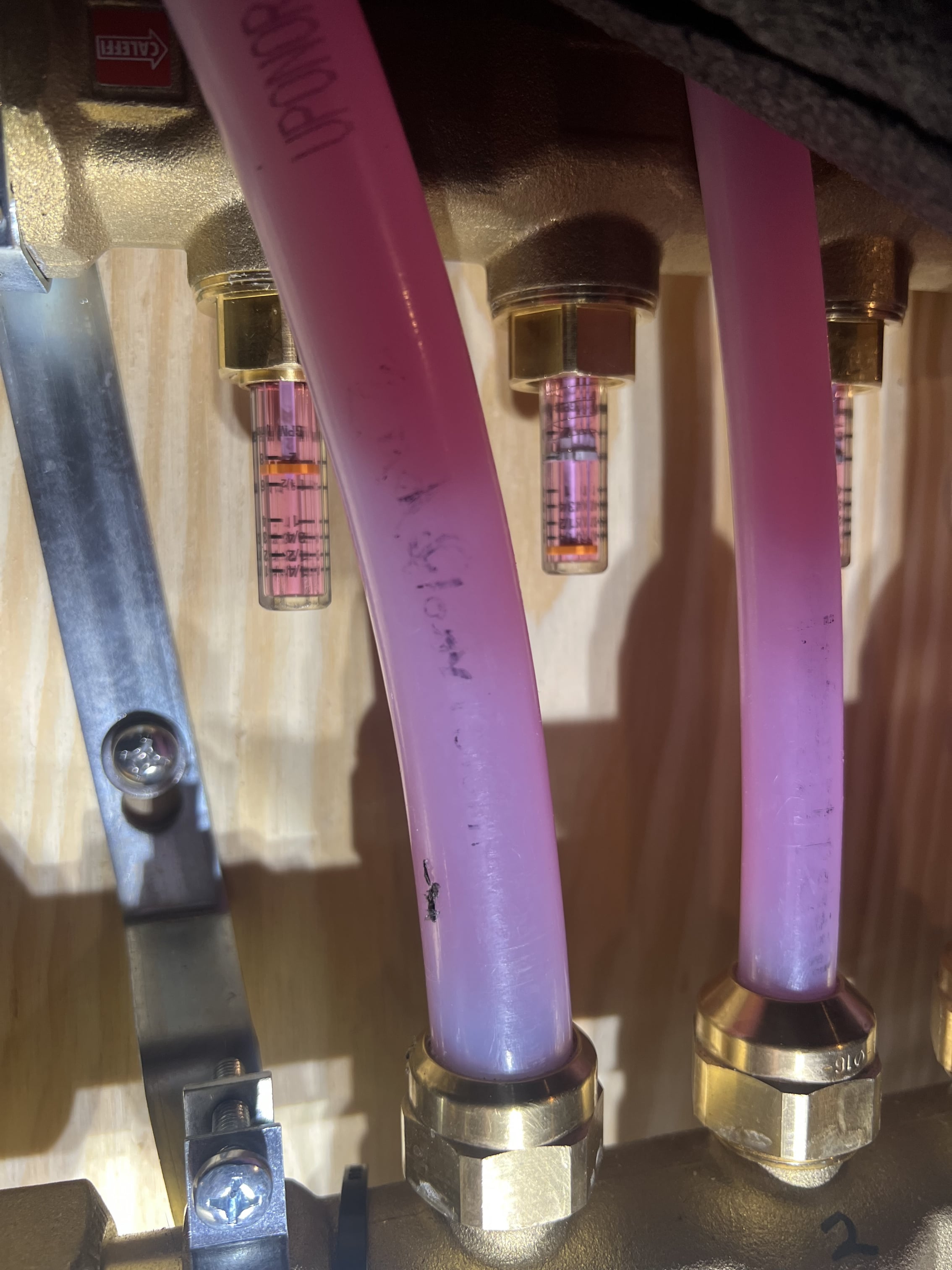

    System is up and running. All is well, except that I am not getting good readings on 3 out of 4 balance/flow meters. The one closest to the circulation pump (that has the most head) is functioning correctly. Opening and closing the others has no effect on their reading. Any thoughts?
    Is the loop purged completely? Does the tubing get warm on both supply and return, that would indicate if you have flow, or not.
    The fluid looks nice and clean.
  • CDHE
    CDHE Posts: 23
    Cranked the 15-58 pump from the second to third speed and now the flow meters seem to functioning fine!
