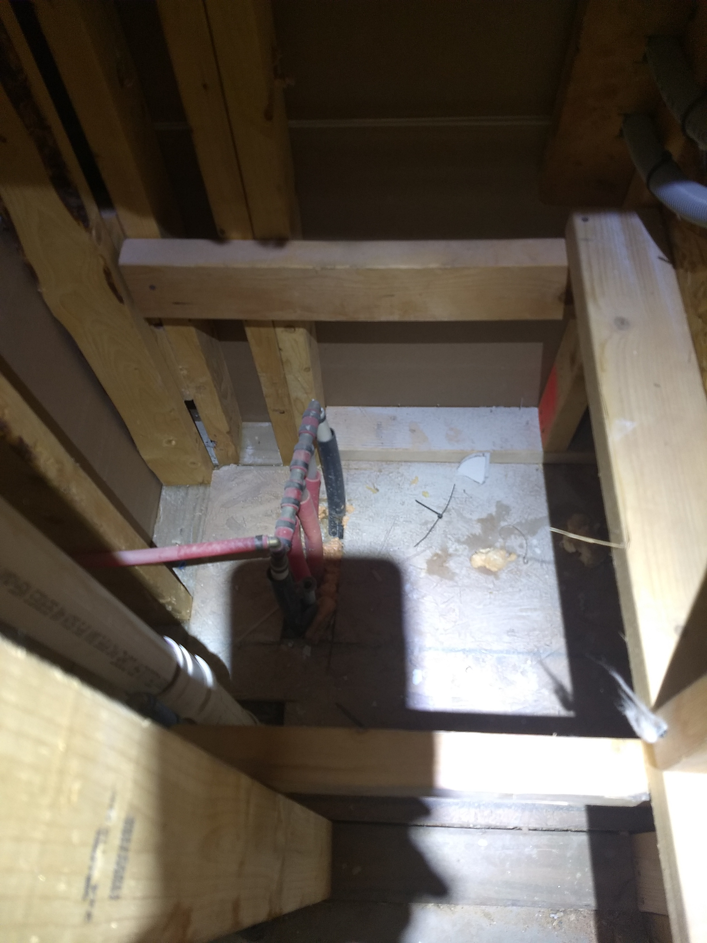

    I think I will have to get a plumber to run this test. It's weird how the kitchen sink and master bathroom are always pretty good. Every once in a while a long wait, a few times several minutes in the master shower. Both get very warm then hot and stay that way continuously. Only the 2nd & 3rd bathrooms get the cold water sandwich. And if I run the hot water at the sink for a couple minutes then the shower it's good enough, maybe 90% hot. The other thing is how both of these bathrooms during the cold water sandwich when you turn the valve off then back on you get a short blast of hot water turning cool in seconds. Like I said most times running the sink first minimizes or eliminates the cold water sandwich. The shower temperatures are never more than 90% hot usually they would be less.
    Both bathrooms get their water from the hoses stubbed up from the slab in this chase. I put an access panel in during construction. No other home has this.

    @Ghost_Rider357 Are you able to post a picture further back to allow for the near boiler piping to be seen? I'm hoping to see if you have a piping issue there or at least a valve in the wrong position.

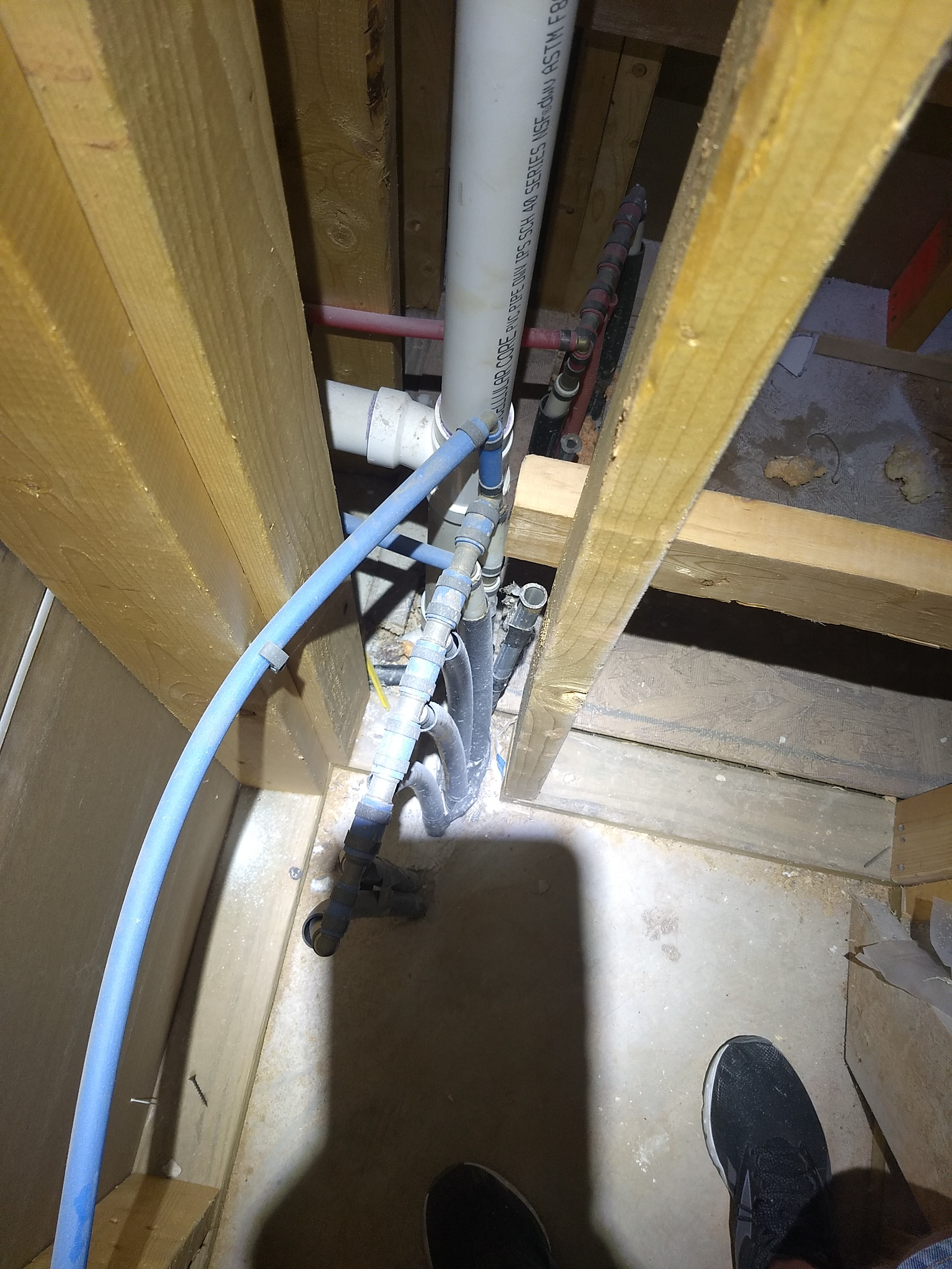

  • Ghost_Rider357
    Ghost_Rider357 Member Posts: 46
    There's not much more than is in the picture above. I had these from when the plumber I hired thought the intake PVC was part of the problem.
    Intplm.
  • Ghost_Rider357

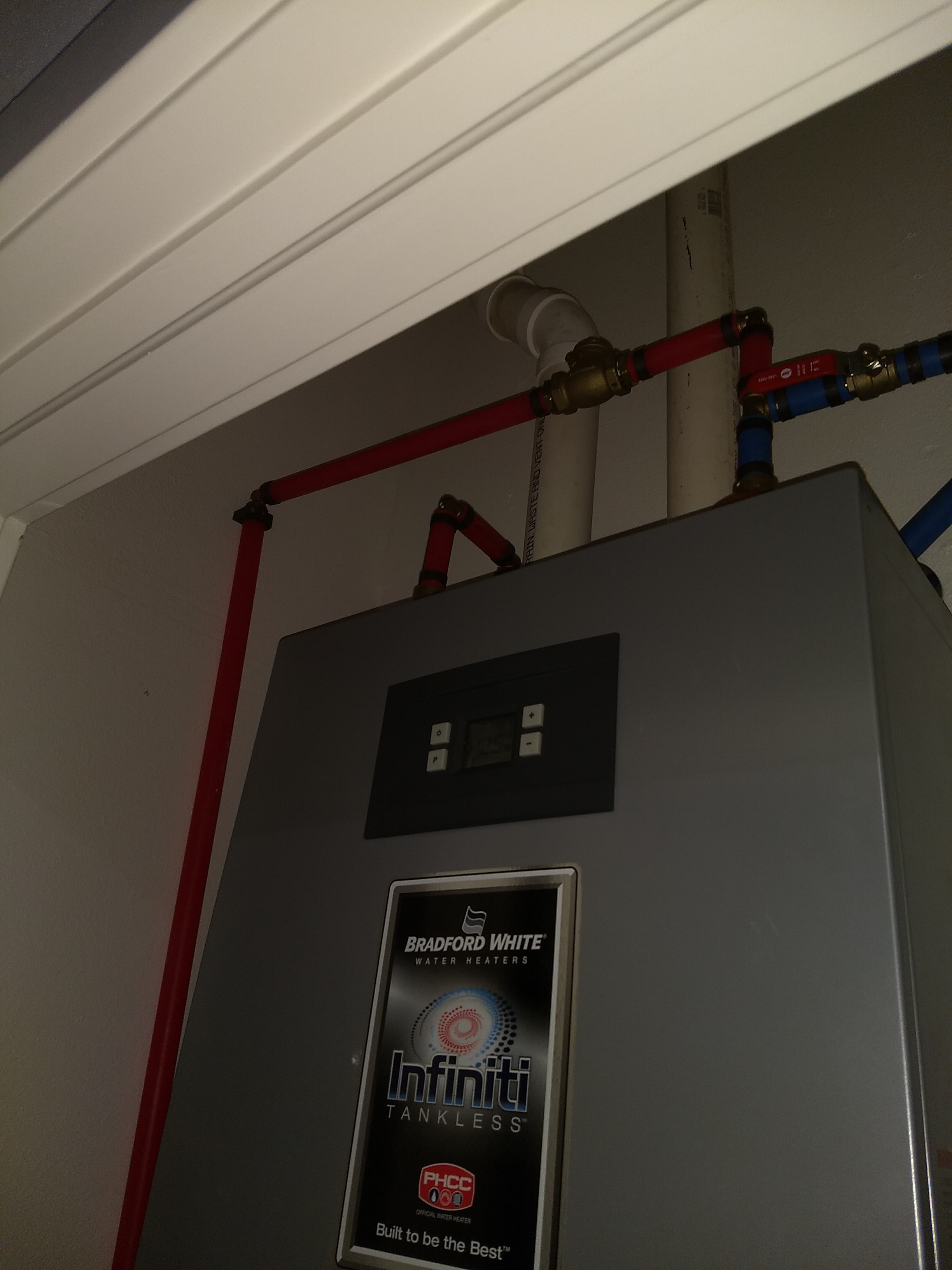

    Here's a better picture. I don't think it could be simpler than this.
  • Ghost_Rider357
    edited July 2024
    Back to theorizing again. Would appreciate any opinions if these thoughts are possible.
    Because of my experience messing with this. It seems that the kitchen, laundry sinks and master bathroom sinks and shower valves work pretty much as expected occasional longer wait times aside. It's only the two tubs that often have the cold water sandwich. Also my sandwich is more of an open face sandwich, meaning once it turns cold it doesn't get warm again.
    Is it possible that one of the hot water lines stubbed up in the chase area (picture above) intentionally has a cold water connected with the hot water stubs. The reason I ask this is when I open all the hot water valves or even multiple hot water in the same bathroom the pressure pretty much stays the same but the water at the tubs turns 100% cold. And the change in temperature at the faucets is to quick for it to be done at the water heater. It like this is done to maintain water pressure above temperature. The other reason I think this is, initially in the morning when the cold water sandwich is the worst. It seems to me that if I let the tub valve just run after the initial 60% hot it gets cool, 20% hot and stays that way. It's only when I repressurize the lines by turning on the hot water at the bathroom sink then giving the recirculation pump a chance to get all the lines warmed up that the hot water at the two tubs get warm enough to shower???

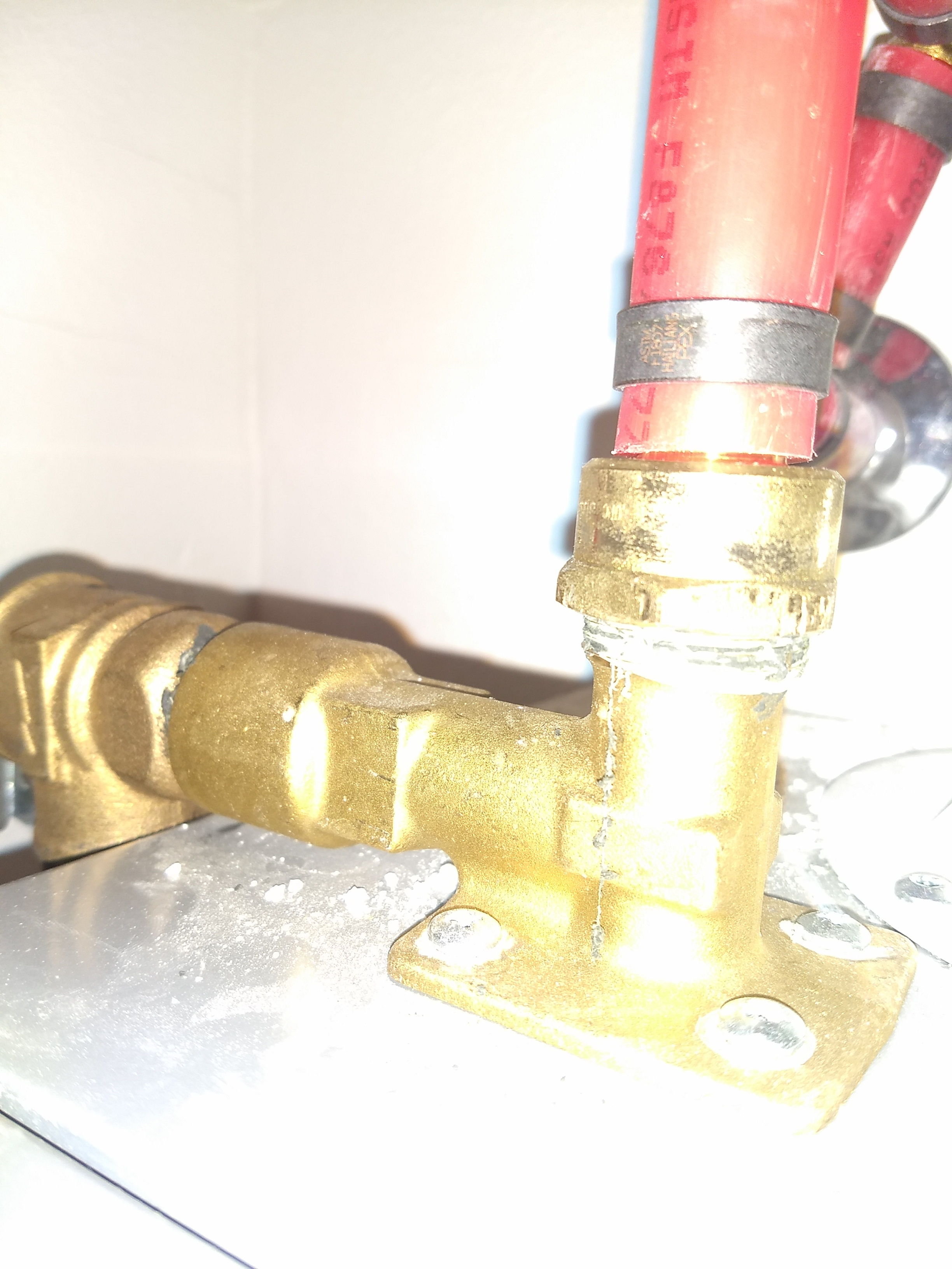

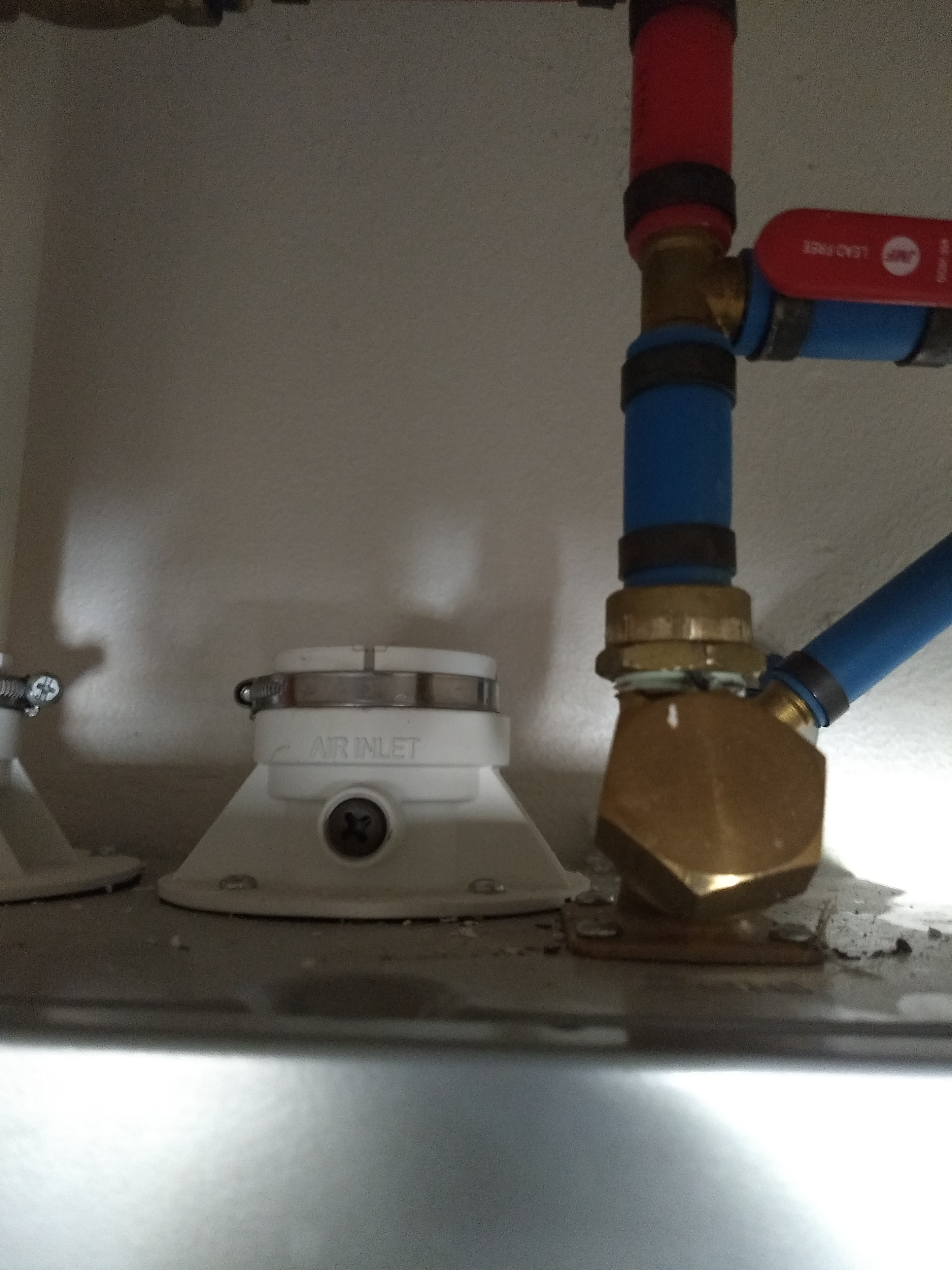

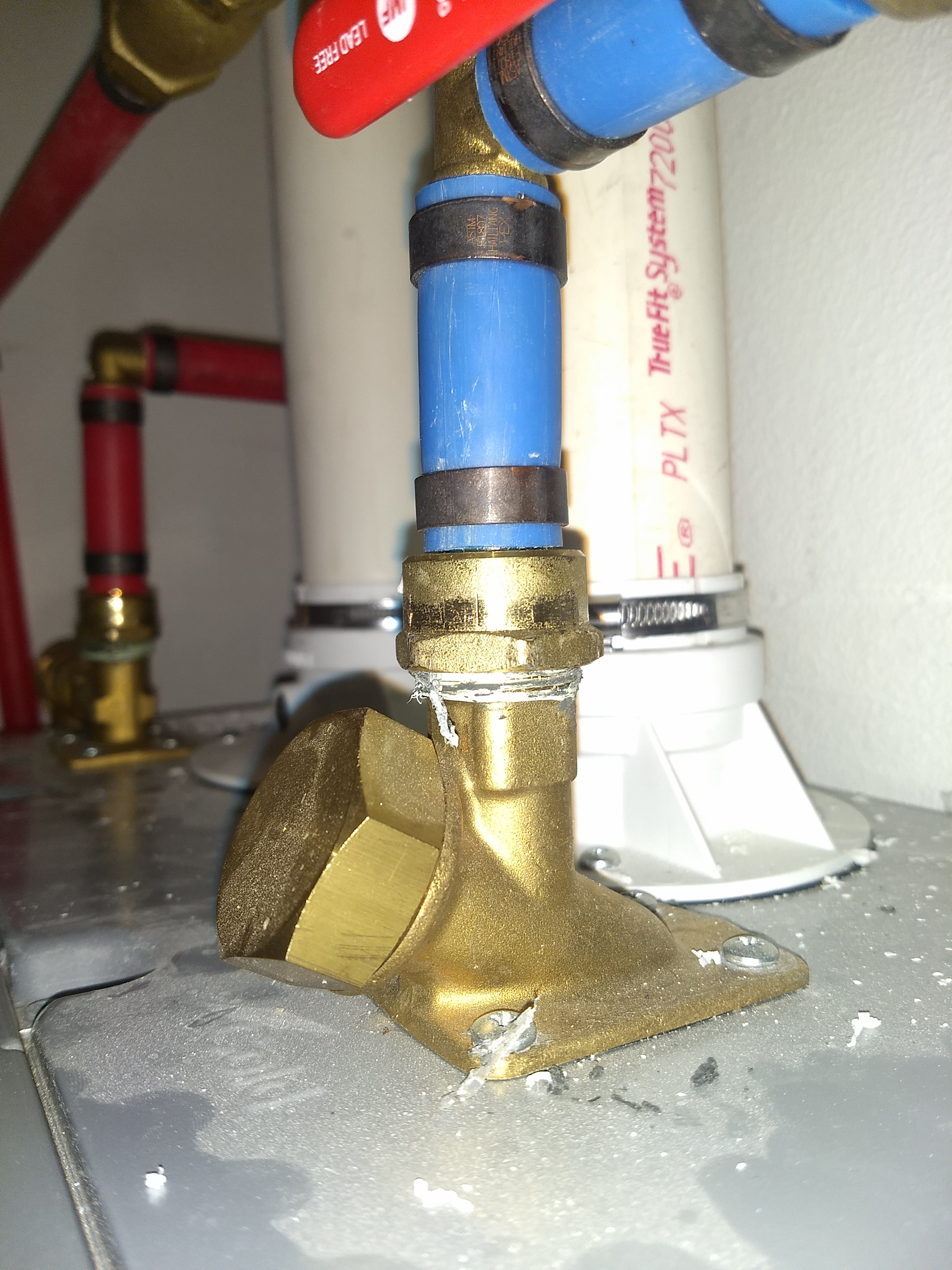

  • Teemok
    Teemok Member, Email Confirmation Posts: 757
    edited July 2024

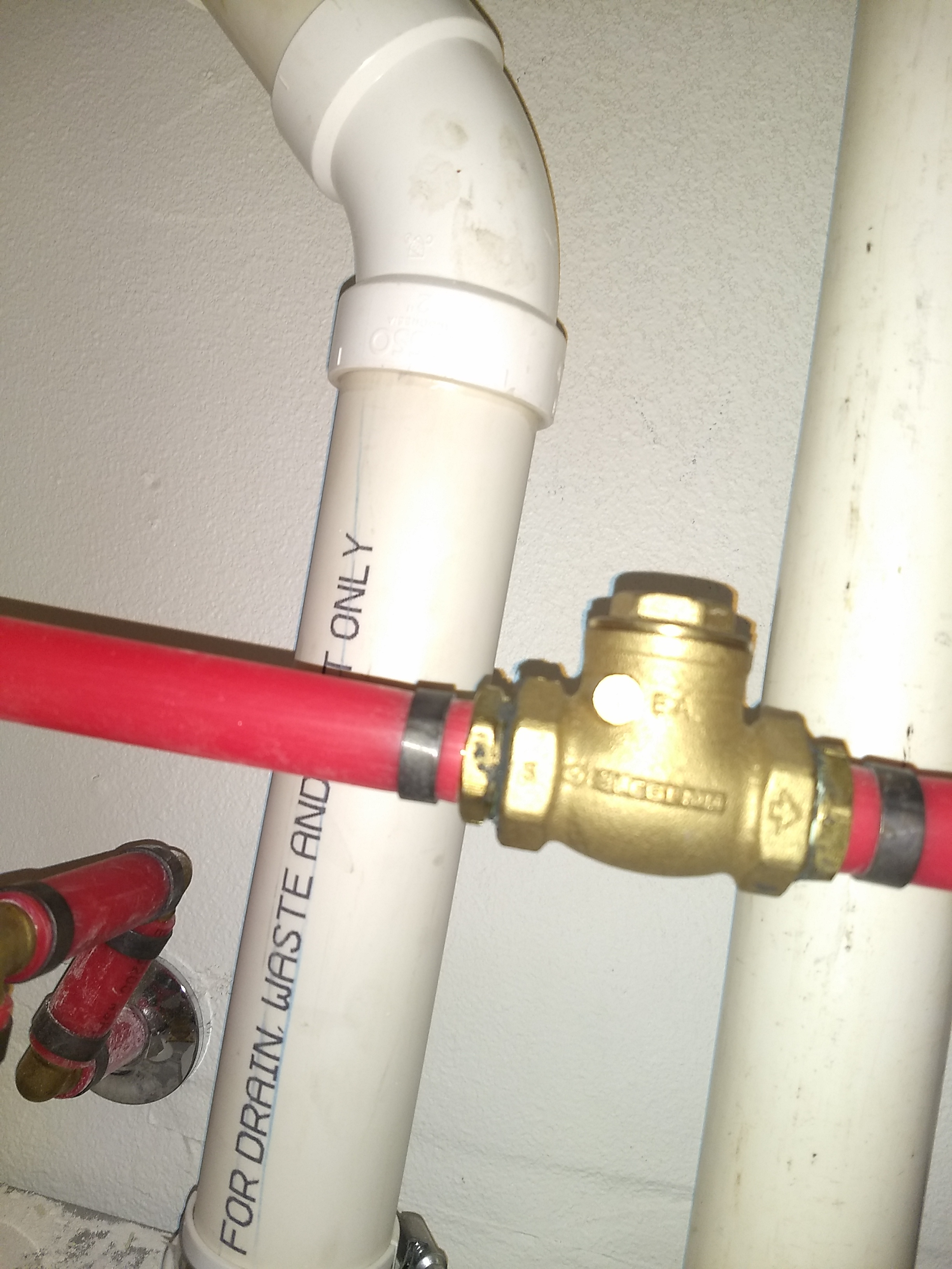

    @Ghost_Ride357 . Looking at your pictures I can see one that shows the two pipes connected to the cold side of the heater at the top and it looks like there is a swing check valve on the upper branch. THIS IS A PRIME SUSPECT for your problem. A swing check used on pex tubing is poor practice. Pex is hard if not impossible to keep straight or level when it is noodle soft hot or cold and bent. Replace it with a good quality spring check valve. That line that the swing check is on is "likey" a dedicated recirulation line. There's no recirc. purge valves or expansion tank and I can't see a relief valve though it might be there. I see pex connections on the lower ports in addition to the top connections but no service isolation valves. Is that lower connection blue pex with brass fittings being used as a condensate drain? If so, that's not good. The brass will fail at some point due to acidic condensate. I've seen it many times. Not a good quality installation. A good plumber can prove that the suspect check valve is not working in ten minutes or less.
    Ghost_Rider357Intplm.
  • Ghost_Rider357
    Thank you Teemok this is very helpful information!

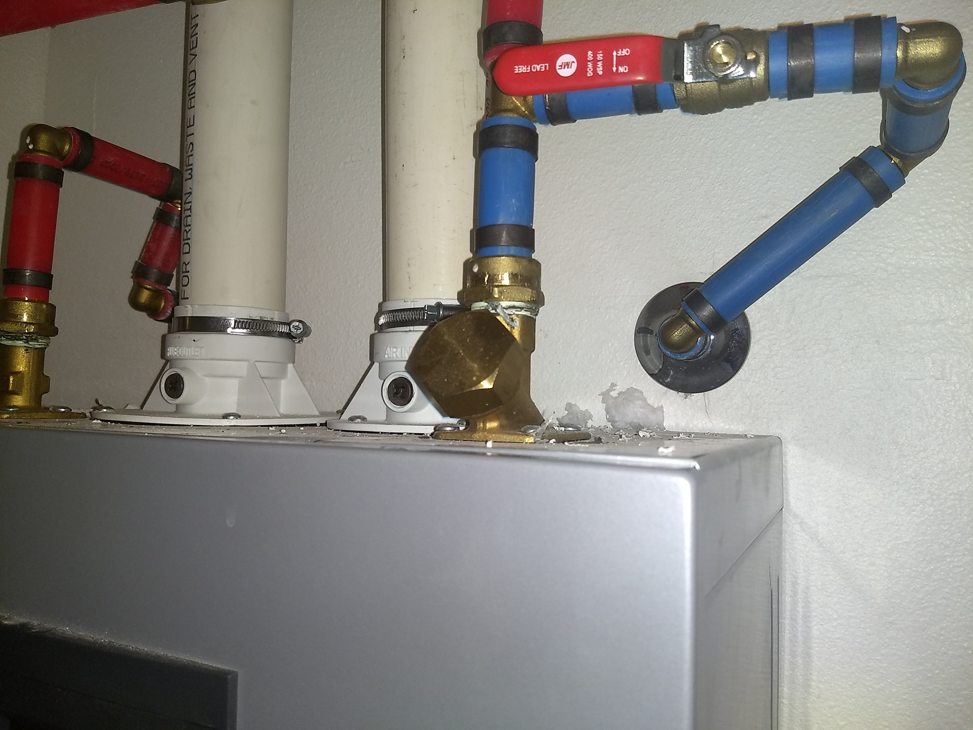

    here 3 more pictures close ups to all the connections on top.
    The top being the check valve. I also suspected this valve could be the culprit. I never would have thought brass would be a bad connector, what would be best?
    I have a number to a new plumber so they can make the repairs.
    What's your thoughts about this type of plumbing? The hose is good for freezes but when I saw all the crimp on connectors my thought was how often do those fail? In Chicago it was all copper. Pros and cons to everything.
  • DCContrarian
    DCContrarian Member Posts: 1,477
    If that check valve isn't doing it's job you'll get all kinds of havoc in the system. It could cause cold water out of the hot pipes.
    The third picture looks to me like a Wye strainer cleanout.

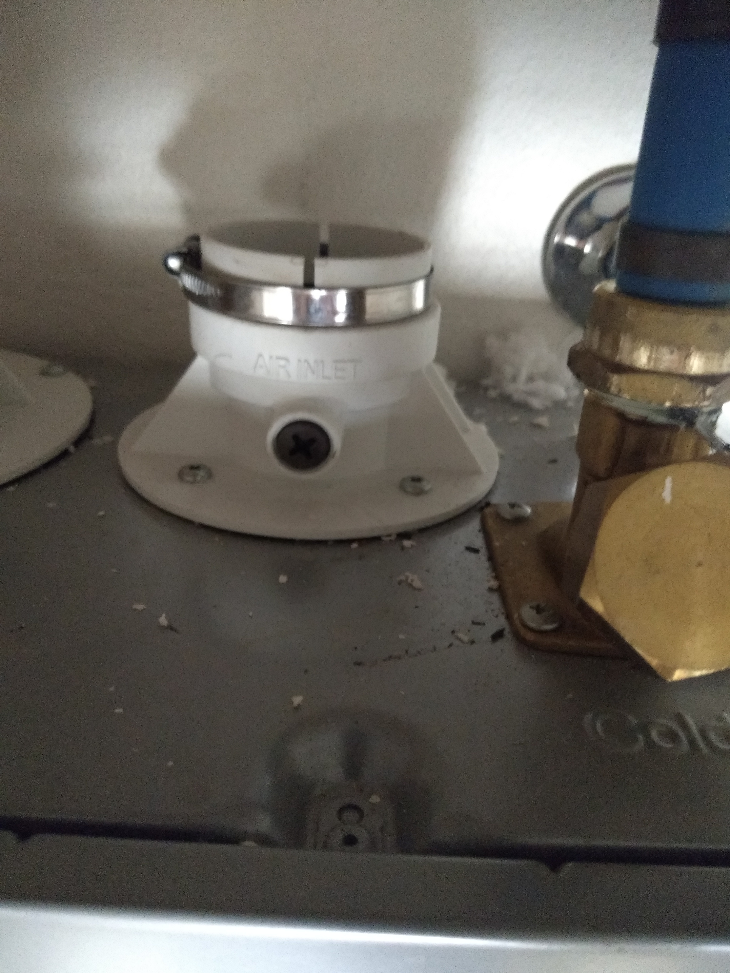

    @Ghost_Rider357 The condensate drain should be all Plastic. 3/4 pvc is the typical. The idea is no clogs, kinks, or acid degradation. Pex is acid tolerant and there are plastic crimp fittings available. They just don' t flow chunks well and maintaining proper pitch is a bit harder with bendy pipe. At the least switch to plastic fittings and pressure flush them after maintenance work. I've seen large acid burn cuts in to concrete foundations where the brass fittings failed and no one notices, understands or cares.

  • Teemok
    Water ALWAYS follows the path of least resistance to get from internal pipe pressure to atmospheric. If it is easier for cold water ( the source of the internal pipe pressure ) to travel a path via the leaking or backwards tilted swing check through the hot water recirculation line to get to the faucet (and I assure you it many times is) …it will. You will experience warm to hot at first, do to the recirc. pump doing its job and while the heater might be starting up and the normal slug of Cold Water Sandwich is heading your way, so is the cold water from the continuous check valve fault. You see, a swing check relies on gravity to close its swinging door. That's fine if the valve is in an up flow, water lifts the door to open and gravity drops it to positively close it. When the valve is in the horizontal position or worse tilted so that gravity holds the door slightly open, it will not close the valve and the swinging door fails to "check" the water flow in the wrong direction. The easiest path for most of the water at other fixtures might be the normal route through the water heater so the problem with the swing check valve is less noticeable if at all.

    I put a level on the check valve and if anything it's back pitched a little. I get what you are saying about needing to be installed level and solid.
    Not knowing how these devices work wouldn't the reverse water pressure close the flap?
  • Teemok
    edited July 2024
    Swing checks are notorious for not closing well, even when gravity is just right. That's why I previously said replace with a quality spring check valve.
    "wouldn't the reverse water pressure close the flap?" Great question. The best answer is it depends. A piece of thread sealant or debris can hold it open. A bad hinge can hold it open. The velocity of the water flow and the position of the door determines the force on the door. Sometimes it closes it and other times it won't. If it's stuck full open, it has very little water flow force on it.
    The door seal is a machined surface. There's no other seal. A corroded, contaminated or misaligned machined surface can prevent a good seal and after a leak path is established the metal surface can be eroded and a permanent increasing in size leak is created.
    After years of experience with exactly this application of check valves, I would never put a swing check horizontally if it's at all possible. To be clear, spring checks also fail from time to time. Especially crap ones. Like the cobblers children's shoes I have an intermittently sticky 24 year old 1/2" spring check on my own recirc. line. Nothing like a honey do list to back burner.
    Larry WeingartenGhost_Rider357

    It might take all of ten minutes to put a ball valve inline with that check valve — turn off the water, open a tap and let the water run out until the pressure dissipates, put a 5-gallon bucket under the line, cut the pex, slip crimp rings over the cut ends, insert a valve, crimp the rings. Turn the water back on and empty the bucket. In an exposed location like that I would have no problem using a SharkBite, which would be even quicker, like one minute. Something like this, 14 bucks on Amazon: https://www.amazon.com/SharkBite-22222-0000LFA-Valve-Connect-Copper/dp/B003128NXA/
    If you close the valve and turn off the circulator you can see if your problem goes away. If it does, bingo. If it doesn't, it's a good idea to have a valve there anyway so you can isolate the circulation return line so you can do maintenance without having to drain the whole system.

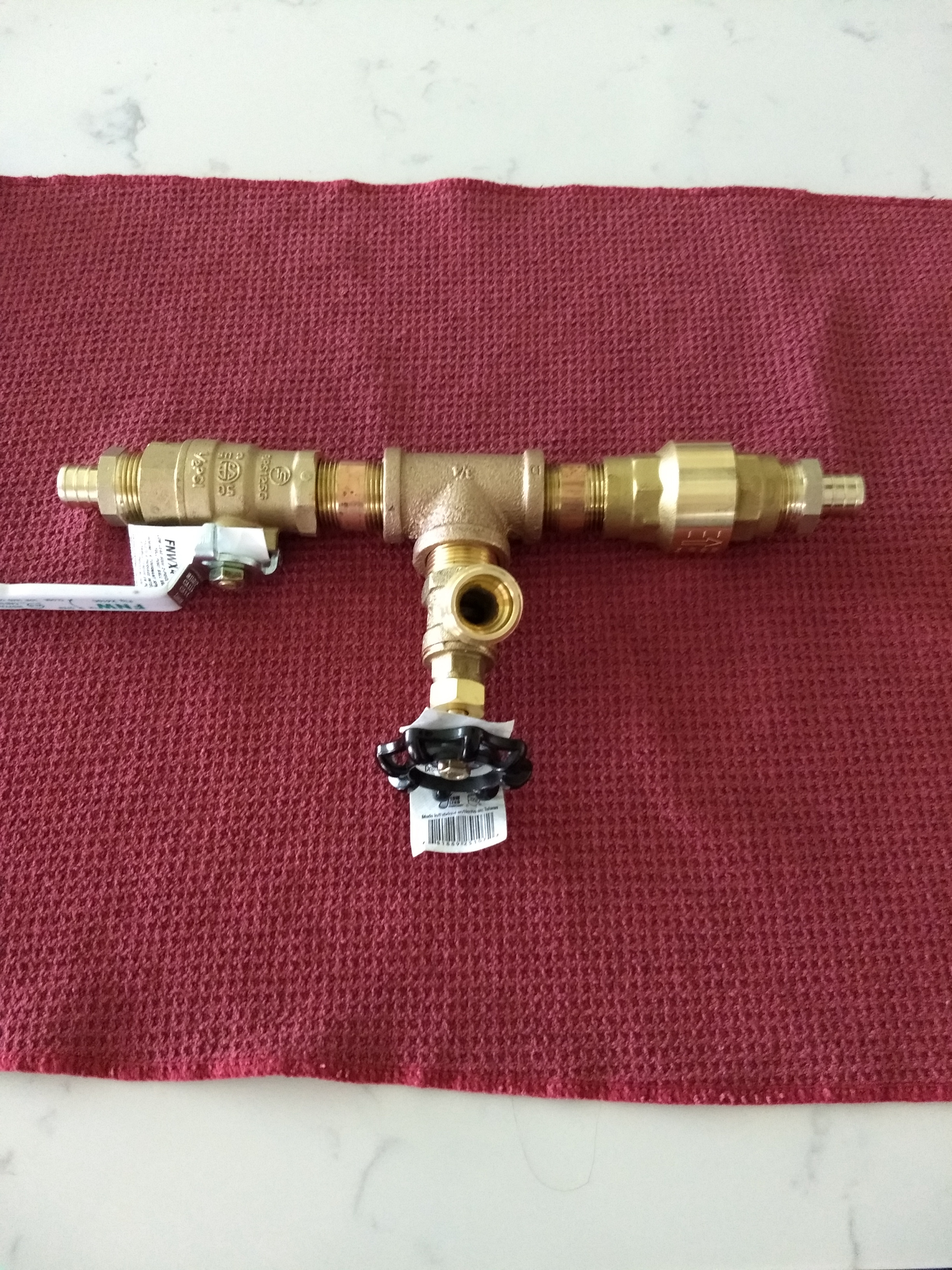

  • Ghost_Rider357

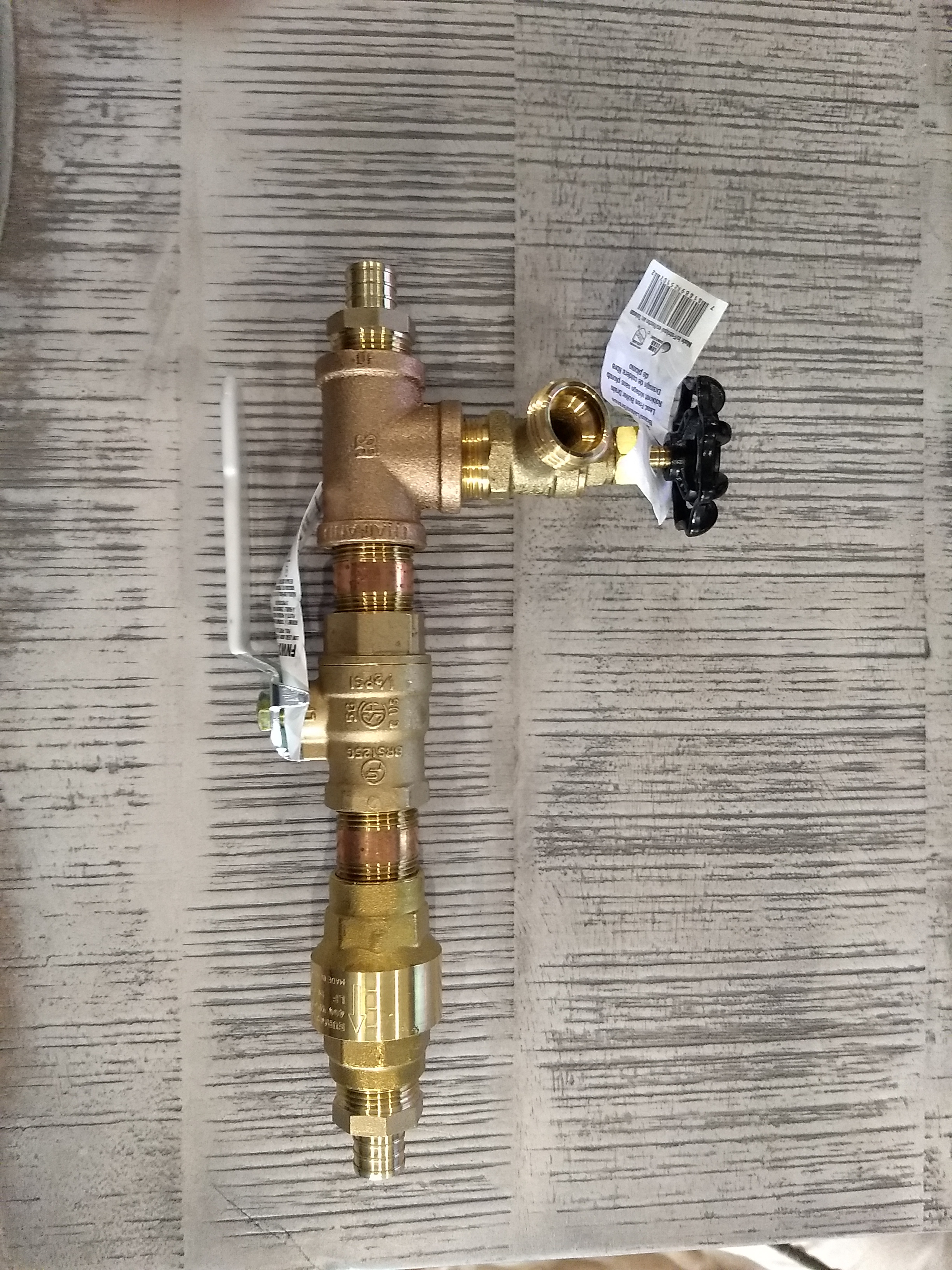

    @Teemok thanks again. So I went by the plumbing supply and got these parts. This makes sense to me and looks easy to install. He also said that the $30 Amazon kit would be fine for the tools.
    Teemok
    hot_rod Member Posts: 27,709
    edited July 2024
    Yikes! Here is a simple way to do it. A pex ball/ drain valve and a grip type check for easy disassembling. These T valves can purge from both directions.
  • Teemok
    @Ghost_Rider357 There's nothing scary about your local store build. Plastic check valves and shark bite like connections are suspect but that's just my opinion. The dual direction purge ports are good but not necessary. You did fine. Threaded connections are fine. Use some thread sealant and tighten well. It's pex you can always cut add or replace fittings later if needed.
    Ghost_Rider357niknova
  • Ghost_Rider357
    @Teemok thanks the parts store build seems like it will be easy enough. I planned on using Teflon tape and pipe dope. I have confidence in the threaded parts and I like there's only two PEX connections. The cost for all the parts was only $45
    I think the tee and boiler drain need to be on the other side of the ball valve, based on the arrow on the check?
    TeemokGhost_Rider357
  • Teemok
    @hot_rod Good catch! Drawings are better than words. I knew I should have posted one while I was writing. @Ghost_Rider357 The ball valve side is closest to the heater cold pipe and the arrow on the check points to the heater.

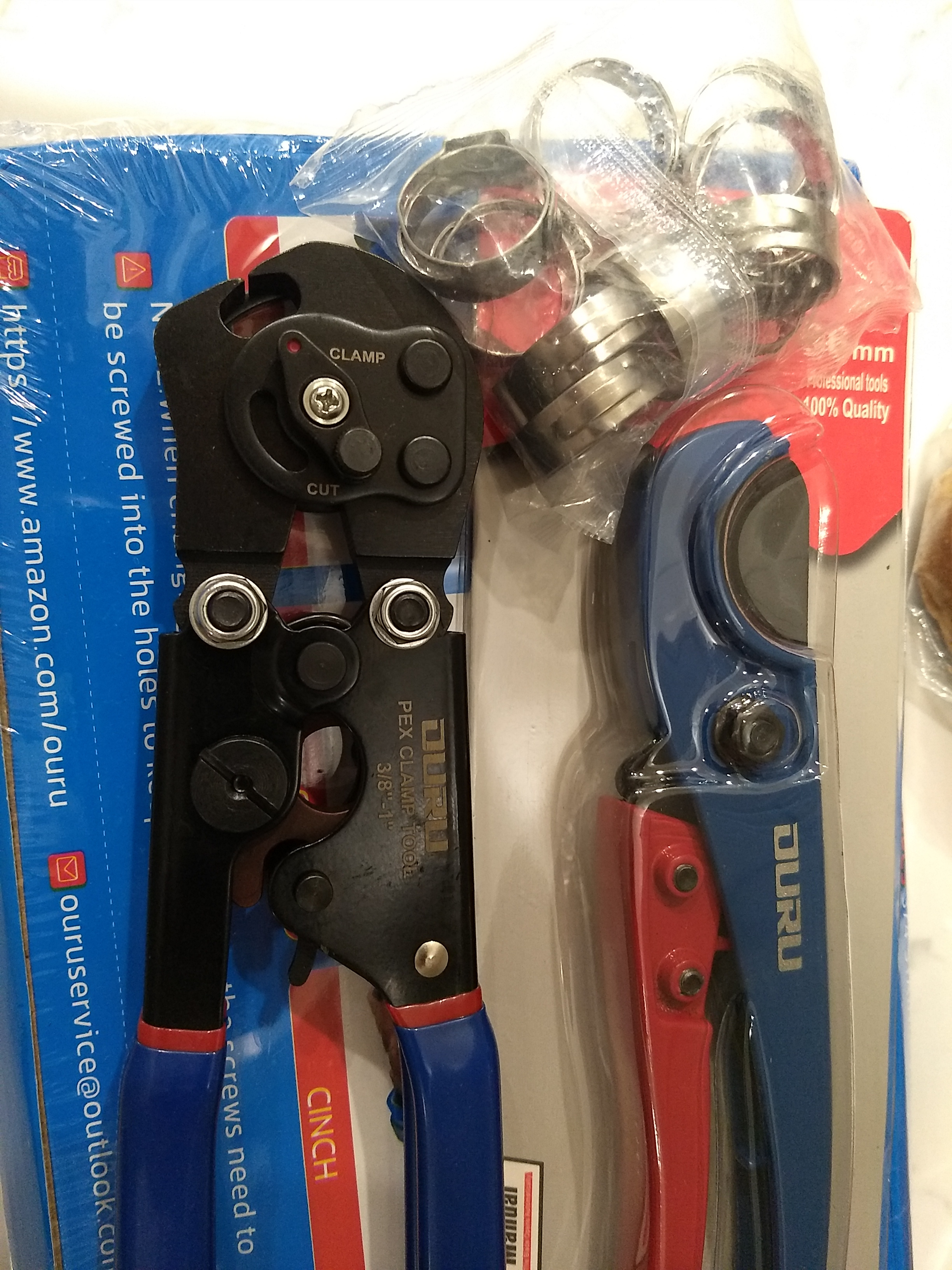

  • Ghost_Rider357
  • Ghost_Rider357
    @Teemok I got my PEX tools today. I'm not sure these are what I want. I would rather use the PEX rings the plumber used a solid black steel ring.
    These look a little cheaper. Maybe they are fine. I can return it to Amazon.
