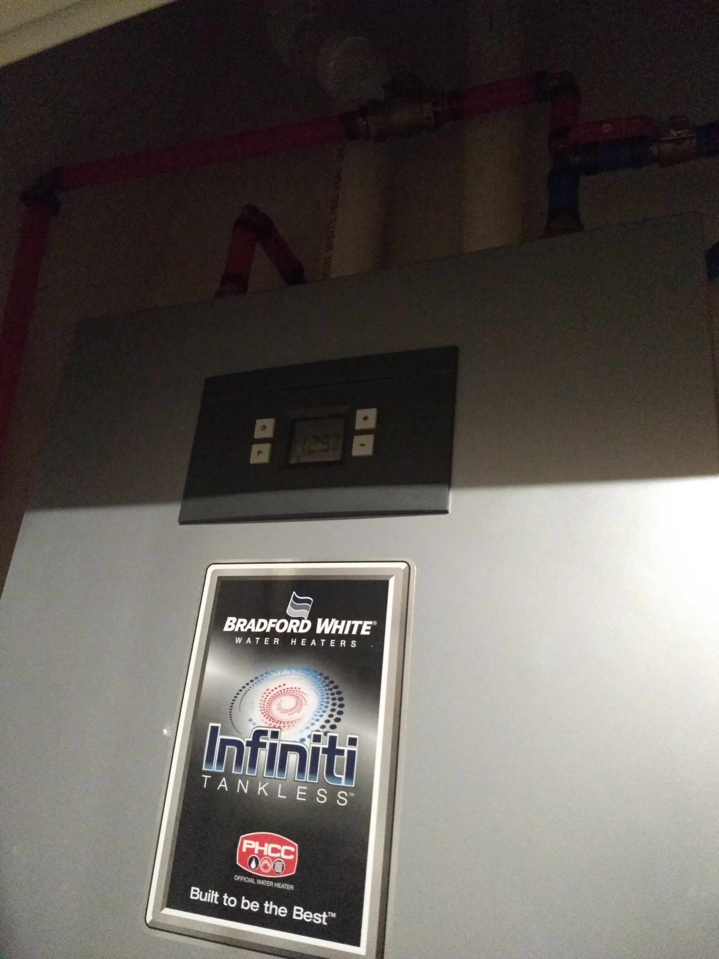

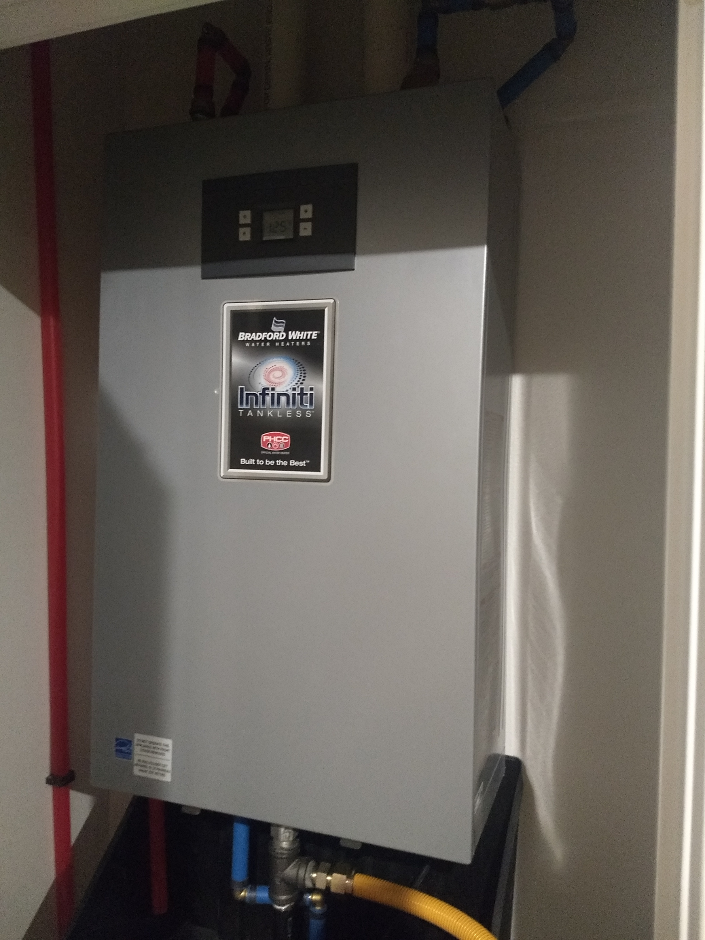

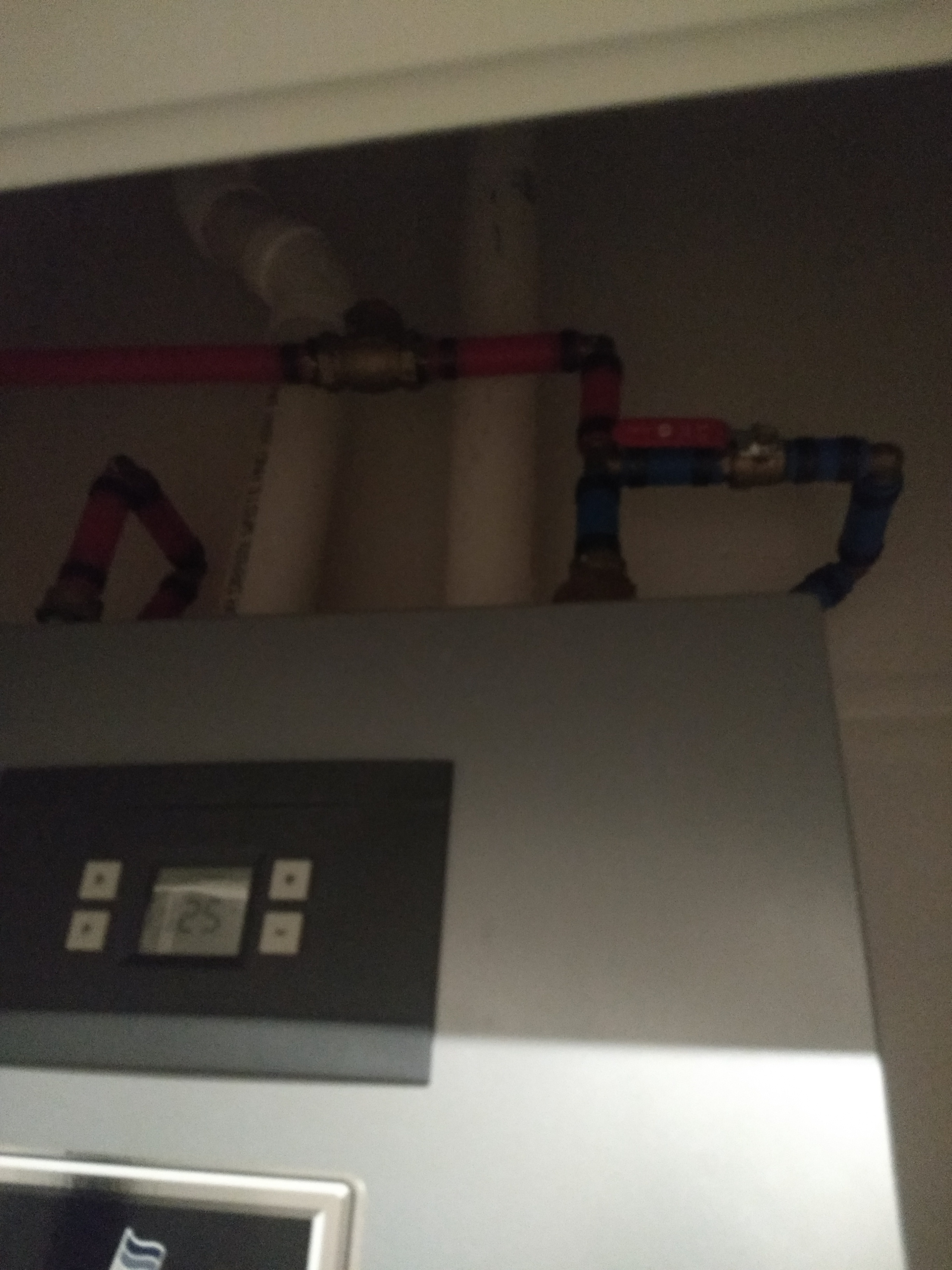

I was directed here from another forum. I have been having difficulty finding information to help me understand what has been happening with my tankless water heater.
When we moved into our new house. That has a Bradford and White tankless recirculating water heater. It seemed to work correctly for about 6 months. We were hearing about dozens of failing water heaters out of 70 new houses. FF to today they may have replaced as many as 36 of them maybe more. All similar issues primarily long wait times, inconsistent hot water temperature, I recently learned is called "cold water sandwich" others including ours a year ago suddenly get scalding hot water. At the time we were told we had a cracked solenoid. The builder's plumber replaced it under warranty.
We continued to have long wait times and other weird issues. Later the plumber told me that the problem is B&W came out with a improved model and installed 1000 of them, ours being one of them. Then they discovered a problem and updated the design and he has been a victim here because he has been having to replace them for free, eating the labor cost. He also told me when the heaters display on error code the unit can be replaced in a half an hour otherwise it takes hours to go through the diagnostic process to figure out what is happening.
So anybody with a error code gets a new water heater. Dozens, like us have the same basic issues but no code we have been told your warranty is up and you have to get it fixed on your own.
Our multiple issues one as far as I can tell is only at our house. The hot water is at the kitchen sink and the master bathroom is pretty consistent with occasional long waits a few times it was more than 8 -10 minutes having ice cold water. I ended up turning the unit off and on letting it recycle and was able to get hot water again. Often mostly if I get a shower at odd times during the day, say early afternoon after mowing the lawn. It will take a long time to get hot and I just get a cold shower and it warms up about half way through.
Here's the weird part that no one has been able to explain, neither plumber or the B&W Rep. In the 2nd and 3rd bathrooms the tub faucets when I turn them on "all" hot pretty much anytime but it may be worse in the morning. In seconds it's warm and suddenly it turns cold and stay cold. If I turn it off and back on within seconds it turns 90% hot only to turn cold again. This happens continuously, turning it off and back on again. Also in those bathrooms if you turn on both the sinks and tub one or both will turn completely cold. I have noticed that if several hot water valves are open it becomes warm possibly cold.
The builder's plumber was going to give me a new water heater but when he realized I had no codes and after showing him that scenario he stopped the replacement and said it must be the one of the 5 faucet cartridges in the house and that is part of home maintenance. Basically I'm on my own call a plumber.
So I did. He seemed like a knowledgeable guy and he over two different days diagnosed and came up with a few possibilities. He changed the 2nd and 3rd bathroom tub cartridges, changed a 1/2 inch flexible gas line to a 3/4 and fixed a better option for the intake PVC pipe.
Now I'm up to $595.00 and nothing is fixed. The plumber I hired also had the rep come and look at it during the 2nd day of work. I told him about the dozens that I'm aware of that have either been replaced or are still having problems. Last I talked to my plumber he was also suggesting that maybe the hot and cold water hoses got crossed but that is only a guess. He said he knows the builders plumber and would have to consult with him to try and figure out what might be going on.
Because it seemed to work normally for the first 6 months I don't think it was plumbed wrong. I think something is wrong with the water heater and because of how it was plumbed the 2nd and 3rd bathrooms react differently than the kitchen sink and master bathroom.
But really I have no idea what or how much it will cost to just blindly try and fix this.
I have learned for the most part how to live with it. If you run the 2nd and 3rd bathroom sinks hot for a few minutes then take a shower the temperature stays a constant 90% hot never 100%. I also turned the temperature up to 125deg and all hot at the kitchen is near scalding once in a while but never in the the bathrooms and certainly not in the secondary bathrooms.
Sorry for the long text and hopefully someone will have some answers for my complex issues.

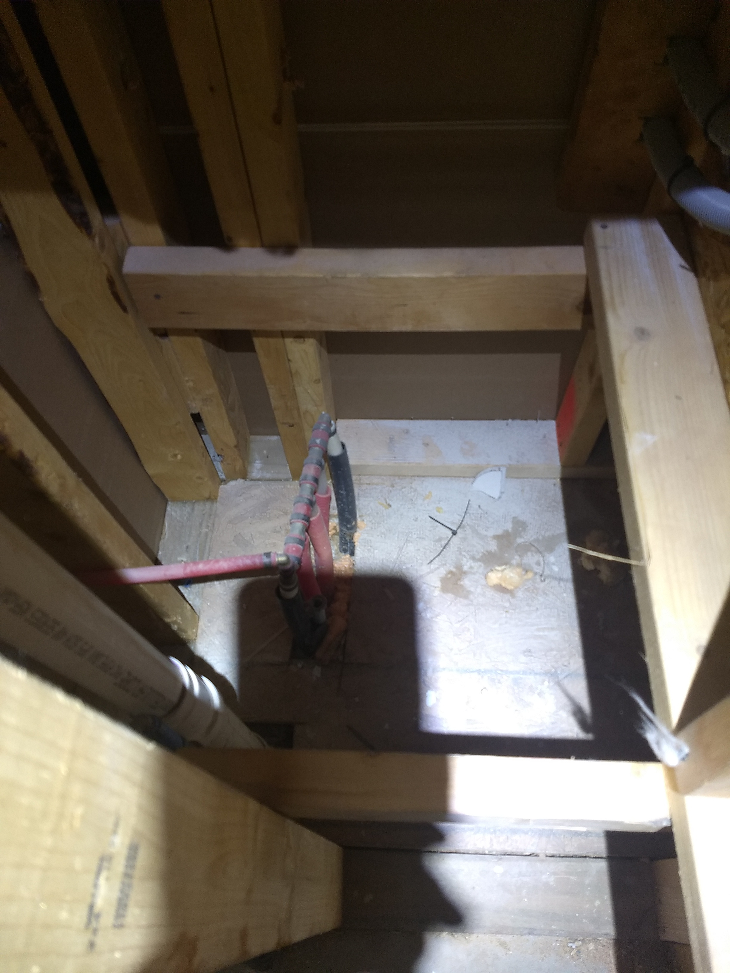

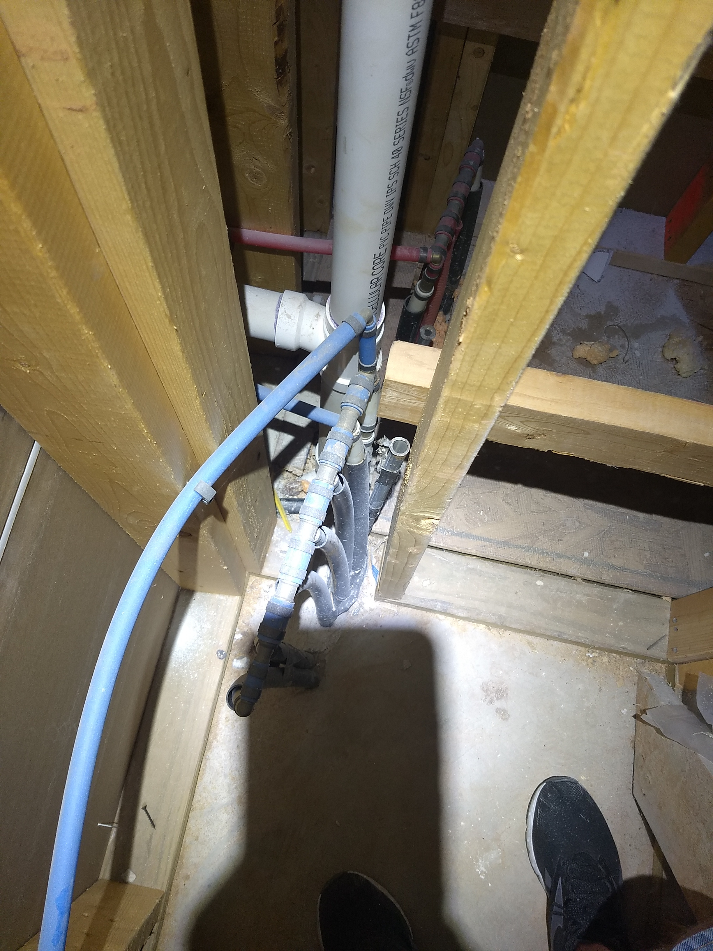

    The other two pictures are in a chase, that I have access to. You can see multiple hot and cold lines coming up from the slab. Hot on one side cold the other. All of these directly to all 3 sinks and one of the tubs for the 2nd and 3rd bathrooms.
    I have lots of pictures during construction showing the water hoses.

    The specific water heater is a Bradford and White Infiniti tankless L-series model RTGL199N1 the recirculating pump is built into the unit.

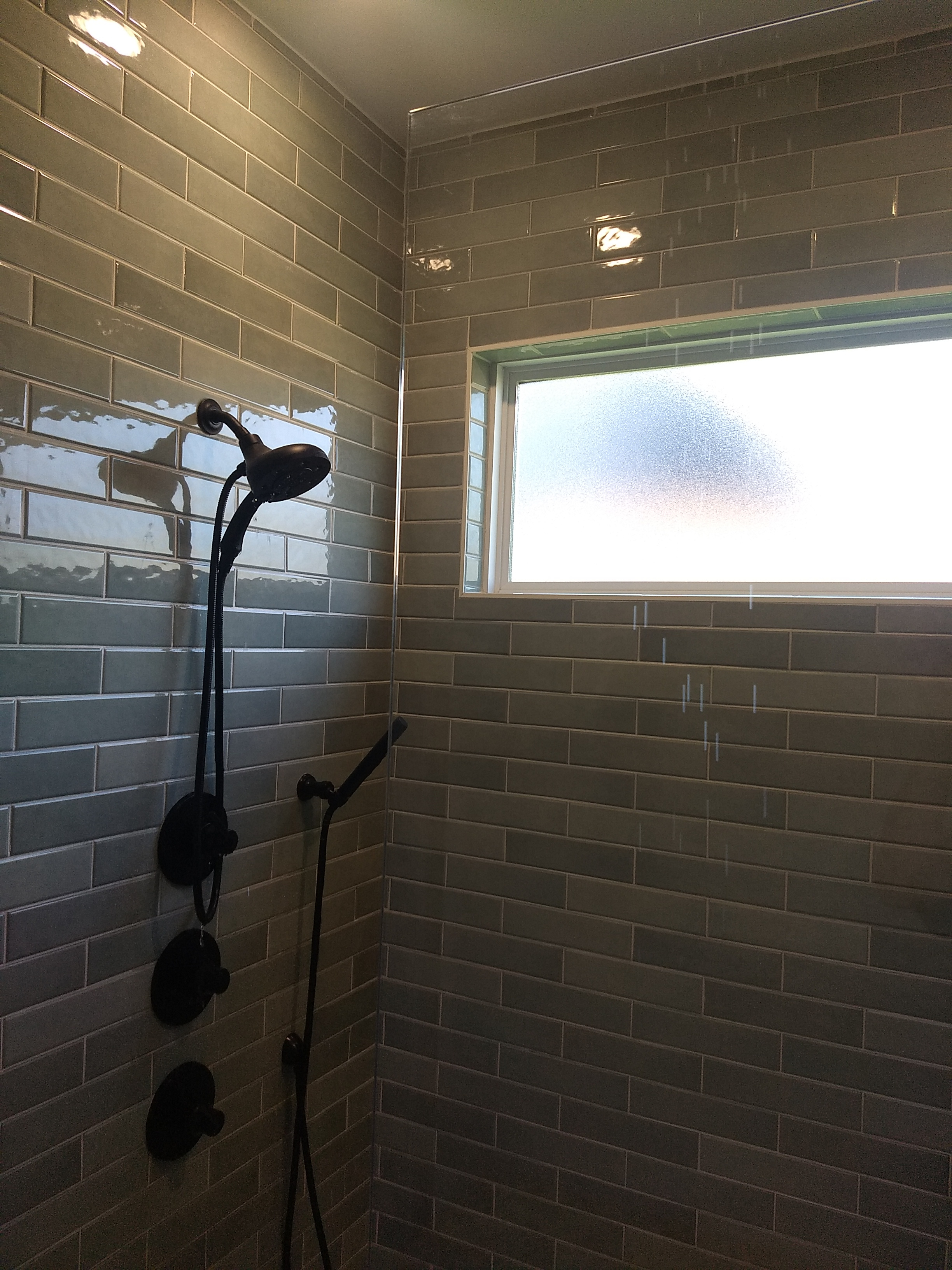

    Thanks for suggesting going through the manual. When I shut off the cold water intake to the water heater I went around and checked all the hot water valves. The kitchen sink, laundry room sink, 2nd and 3rd bathrooms all had a few seconds of drips and stopped as did the sinks in the master bathroom. In the master shower all 3 have continuous drips and no cold water either. Just verified that all 5 tub/shower valves don't have cold water either, not in the normal way. The sinks all have normal cold water and nothing but a few drips of hot.
    Again makes me wonder are these rookie mistakes how did neither plumber or the B &W rep not know this test.
    I think that my next test is to replace each cartridge in the master bathroom one at a time. Then preform the same test looking for difference.
    The picture of the shower shows the valves all 3 bathrooms have and that all 3 in the picture are dripping continuously.

    "In the master shower all 3 have continuous drips and no cold water either. Just verified that all 5 tub/shower valves don't have cold water either, not in the normal way. "
    I would expect that the shower valves are pressure-balanced to prevent scalding. So when the hot water is off there would be at most a small trickle of cold water.

    In 2nd and 3rd bathrooms it's just a few drops. What I meant when I said normal way is, in these bathrooms when I turn the valve to cold I can get a spert of cold then it stops. In the master all 3 just keep dripping pretty much the same whether they are all hot or a mixture of cold.
    That sounds like the pressure balance you are talking about. Still the master shower is different than the other two bathrooms. So that's pointing to it being the problem. The house is only 18 months old so is it worth changing the 3 cartridges in the master, perhaps with new. Or does swapping them one at a time using the ones from the other two bathrooms a more sensible start?

    All 3 valves in the master shower keep dripping heavily indefinitely, or so it appears.

  • Ghost_Rider357
    Ghost_Rider357 Member Posts: 46
    Larry the drip from all 3 shower heads after the hot water has been shut off combined is probably at least a gallon a minute. It's a continuous flow seemed like it would just continue never slowing down.
    Here are a couple of pictures for you guys
