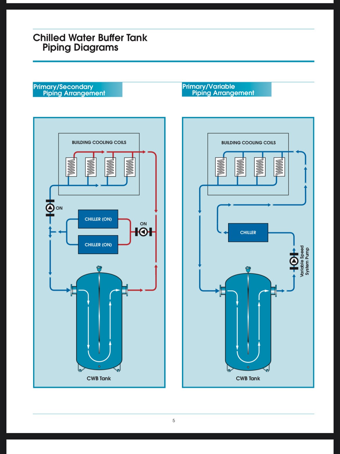

    There are two basic AWHP options. A split system has freon lines between the inside and outside, the monoblock fig 7-19 has a water or glycol loop between the inside.
    Notice that every 3 pipe schematic has two circulators and a hydraulic seperation at the large upper fittings.
    Screenshot 2024-06-15 at 9.48.26 PM.png Screenshot 2024-06-15 at 9.47.19 PM.png

    I have a two pipe buffer tank with a modcon boiler that works well, but I’m running it with a DDC control system. I’d like to simplify it but I can’t find a suitable off the shelf control to do it. It’s difficult to coordinate the outdoor reset between the tank and boiler, and for the buffer tank to work properly the boiler pump has to shut off in the off cycle to allow the tank to stratify. I have my DDC controller set up to determine the outdoor reset curve, and then the boiler gets its setpoint from the controller. I have a sensor towards the bottom of the buffer tank that I use to determine when to shut the boiler off., and a system temperature sensor that determines when to turn it back on.
    hot_rod Member Posts: 27,561
    edited June 2024
    are you running the buffer tank on ODR, or running the tank hot and pulling the load off with an ODR control?
    Pros and cons. If you are trying to keep the mod con in its most efficient mode, 130f tank temperature would allow the return low enough to start condensing. But the tank has less storage at lower temperature.
    If you ran the buffer to 180, you get more capacity, longer boiler off cycle, but mod con boiler efficiency drops when running at 180.

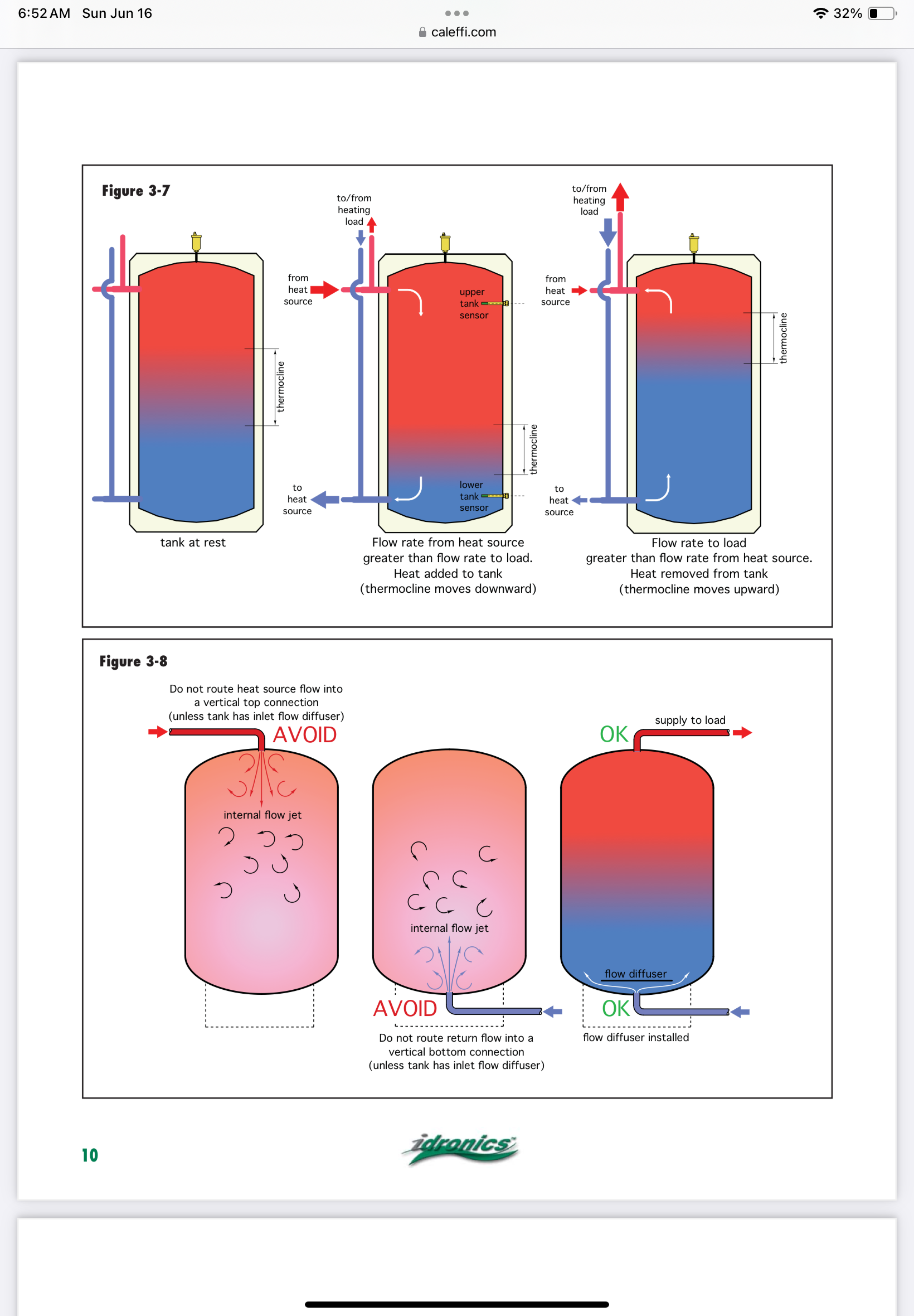

    The tank will be hard to stratify if one or both circs are running. The piping in and out of the tank can help encourage stratification a bit. Flow diffusers or sparge tubes help minimize the “stirring” of the tank.
    A 3 pipe buffer will stratify better as system return cross the bottom of the tank and doesn’t mix it up so much. It allows the coldest possible return to the boiler.

    The two pipe buffer can under some conditions cause short cycling because it doesn't engage the entire tank, always.
    The 3 pipe buffer, return must cross through the tank, so some of the tank volume is always engaged.
    Heat pumps need a lot of flow for max output, maybe 3 gpm per ton. So it becomes harder to stratify a HP buffer with that much movement through the tank. ideal.The exergy of a blended tank is not so good.

    Idronics 27 shows a handful of different HP piping along with the control logic. If the air handlers can take the all HP output, even with two air handlers with a two stage HP compressor, there there is no need for a buffer tank for chilled water. So a 3 way zone valve selects tank or not.
    If the heat side is zoned below the HP low modulation, use a buffer for that.
    These suggest a chilled water temperature of 45°F
    DHW from either the plate HX or the tank, depending on heating or cooling mode.
    This doesn't seem all that complicated.?

    Thinking about a single pump buffer tank, from your first drawing, for chilled water they build a specific tank like this, it has a baffle inside that runs top to bottom, so water is forced through the entire tank.
    A 2,3, or 4 pipe buffer will not do that. And this tank would not serve as a hydraulic sep. so it really depends on what you are asking the buffer to do. Lengthen cycles, storage a higher temperature for more boiler off cycle, raise efficiency?
