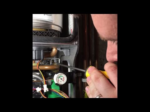

    hot_rod Member Posts: 28,250
    There are some You Tube videos showing how to remove that flow sensor. If this looks like the same boiler you have?
    https://www.youtube.com/watch?v=zRodAou4wqc
