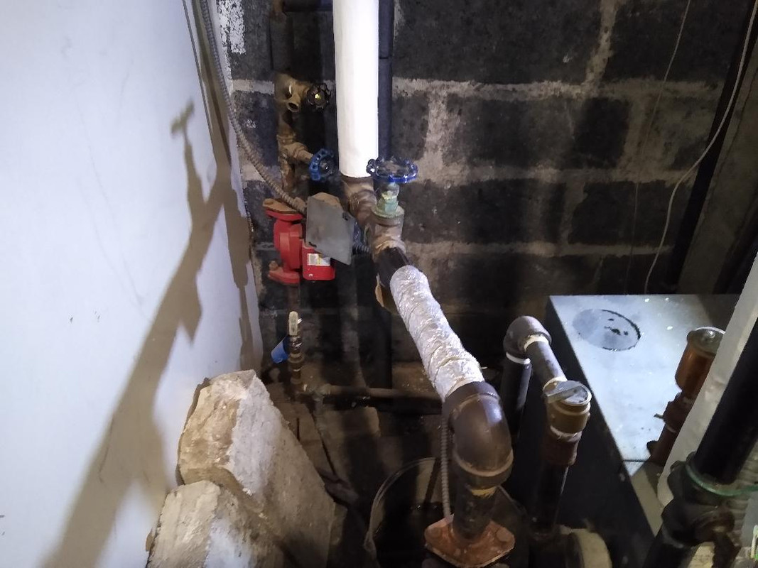

I have a mixed cast iron, Slant Fin water heating system and just replaced 5 Slant Fins with new cast iron Governale radiators. Now, after running the boiler for only a half hour, the pressure rises to 45 -50 psi triggering the pressure relief to release water. My system is about 35 yrs old and is a 179k BTU unit with a large, old metal cylinder expansion tank that doesn't have an air valve and only a water release valve. Before I installed the radiators, max pressure was only about 20 to 30 psi and used to release water every few weeks from the expansion tank. Can any one here give me some ideas as to what might be the issue(s) here? Thanks.

    Your conventional expansion tank must be water logged. Depressurize the system and vent and drain the tank - and refill. Don't install an automatic air bleeder with a conventional tank - it will deplete the air cushion. Good luck.

    I already drained the tank multiple times with the same result. I don't have an air bleeder on that horizontal old tank and just have a water release valve on it. When you say depressurize the system, are you referring to releasing water from the pressure relief valve so the gauge reads 0 and then release water from the expansion tank? The pressure gauge on my boiler currently reads 10 - 15psi when cold. Thanks.
    Jamie Hall Member Posts: 26,826
    There are two slightly different procedures, depending on whether you can isolate your compression tank from the rest of the system.
    If you can isolate the compression tank, do so. Otherwise, you will have to drain enough water from the system so that the pressure in the system is zero at the top of the boiler. Do NOT use the pressure relief valve for this. Use the boiler drain. If you are very careful indeed, you won't empty the pipes and the radiators; if you do you will need to purge and bleed in the usual way.
    Now with pressure off the compression tank, drain it right down to empty. Close the drain.
    Open the isolation valve to the tank or, if you had to drop the pressure on the whole system, raise the pressure back with the fill valve -- to about 15 psi, no more.
    Now I note that you say "I already drained the tank multiple times". If you drained the tank according to the above procedure and it filled right back up with water, it has an air leak. It will need to be replaced, and I would suggest a conventional expansion tank.

    Gilmorrie, to answer your question, I first shut off the water valve that's on the right in the first pic which leads directly to the tank then I open the valve from the tank and it drains maybe what looks like about a half gallon of water. Once it drains completely, I shut that valve and then open the valve on the right in first pic again.

    I'm going to assume that you mean the diameter of the tank is 12 inches. A 12 inch circumference is pretty small... and it doesn't look like that. If so, that's a 15 gallon tank. It may not be big enough.
    However, if you are only getting "about a half gallon" of water when you are attempting to drain it, either it simply isn't effectively connected to the system at all, or you simply aren't draining it. You should get about 7 gallons of water out of that tank when you drain it.

    Jamie, you are right. I meant the diameter is 12". The hose attached to the tank goes directly to a drain, so I never could measure exactly how much water it is. Next time, I'll place the hose inside a big bucket to see how much really gets drained. My plumber now wants to install a 30 expansion tank. Do you think that's sufficient for my system based on my previous specs and new rads? Thanks.
    There's your problem. You're not draining the tank completely.
    What you need to do is close the valve in the tank line. Position a bucket under the drain and open the drain. Some water will leave the tank, then you'll hear air being sucked in with accompanying "glug" sounds. Let this process continue until you no longer hear air being sucked in, which may take up to an hour. Then close the drain, open the tank line valve and you should be good to go.
    I like to install special tank-draining fittings on the systems we service, which are designed to let air re-enter the tank as it's being drained, speeding up the process. But that tank would need some piping changes to make this work. To me it would be worth it- I prefer this type of tank since it has no moving parts.

    Ok, I finally fixed the problem all thanks to you guys! Apparently, as Steamhead pointed out, I was not draining the expansion tank properly and my air purge valve on the boiler was completely open. Initially, when I started draining the tank, a flush of water came out for about 2 minutes and then a trickle of water. I thought that was it but that trickle of water needs to drain for about an hour and a half until it was completely empty and the pressure gauge pointed to zero. Also, as mattmia2 stated, my air purge valve was open and it needs to be closed for my setup compression tank. Once that was done, I turned my boiler on and the pressure rose to a steady 17psi with continuous running. Even though that pressure seems to be low, all my rads became hot even on the second floor. I was just wondering why my plumber used copper tubing as opposed to Pex piping for the new rads. Wouldn't it have been easier for him to work with flexible tubing so the rads can be moved if need be? Just want to say again you guys saved me a lot of headaches not to mention money as well. Time for me to look for a real pro than a wanna be ripoff plumber.
