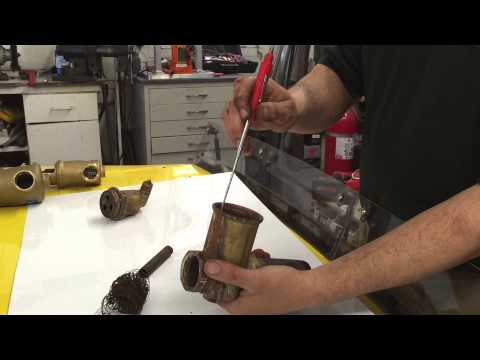

I don't mean to hijack this thread, but I went searching on this topic and came up with this video.
https://www.youtube.com/watch?v=ptEKP23nXSk
At about 2:45 in, Ray says that the Spirovent element is manufactured from an old piece of baseboard. C'mon.
