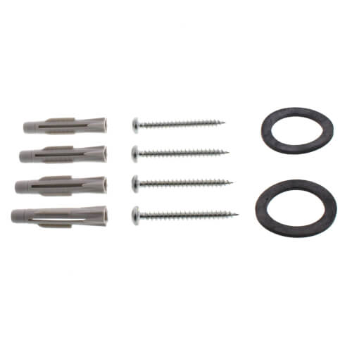

  • Are you planning on using a manifold for supplies and returns?
    https://s3.amazonaws.com/s3.supplyhouse.com/images/products/zoom/a2700502-1.jpg
