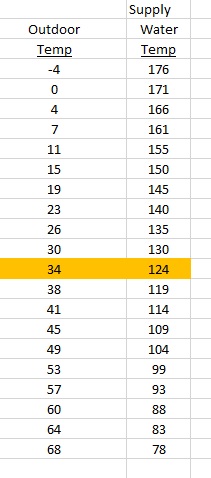

    On page 54 of that manual it describes the "Design Temp" and shows the default Outdoor Reset Curve below. Right now it looks like your boiler will supply 124F water at 34F outdoor temp (see red lines on graph).
    You need four numbers to set your ODR Curve:
    1)Min outdoor temp
    2)Max outdoor temp
    3)Min supply water temp (that is the water going to your radiators)
    4)Max supply water temp.
    Looks like the default curve is set as follows:
    1)Min outdoor temp: -4F
    2)Max outdoor temp: 68F
    3)Min supply water temp: 78F
    4)Max supply water temp: 176F

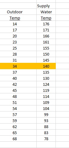

    If you put these in excel you get 124F Supply Water at 34F outdoors:
    Since your house and radiators were designed to use 180F supply water, the current supply water temps are too low for your home's actual heatloss. So, you can add radiation, swap out existing radiators for "low temp" radiators, do both, or raise your supply water temps using your outdoor reset curve. In your case, if you change the Min outdoor temp from -4F to +14F look at the new Supply Water Temp at 34F outdoor temp, it's 140F vs.124F on the old ODR curve:
    With that in mind, you will need to make adjustments to get the best comfort in the house, you may still need a higher Min outdoor temp setting and/or you can adjust the Minimum Supply Water temp up from 78F to maybe 100F and see how that works.
