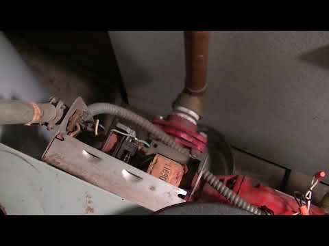

  • Forrest_2
    Forrest_2 Member Posts: 44
    I tried Hot Rods suggestion of turning the two thermostats by setting up a video cam (I live alone). Might give a better idea of what is going on.
    https://youtu.be/rkjRufV1fnM
  • rick in Alaska
    rick in Alaska Member Posts: 1,513
    At 24 seconds in, the relay opens to fire the burner. At this time, the pump should be running, and should have 120 volts to it. The reason the boiler shuts off and the relay is still open is because the thermostats are still calling for heat, but since the pump isn't running, the boiler got up to its max temperature and shut off. The relay is still open trying to to get the pump to come on though.
    There should be 120 volts on C1 and C2 as soon as that relay clicks. Assuming there is no quirky thing going on between the C1 and C2 terminals on the aquastat and the pump, such as a bad wire, then you have a bad aquastat and needs to go.
    Also, you have Taco zone valves, and as such, it takes up to 3 minutes for them to open up and send a signal to the aquastat. So, moving the thermostat is not an instant response at the boiler.
    Rick

  • Forrest_2
    Looks like we got nothing at C1 and C2. So I guess this means a new Aquastat is the call.
