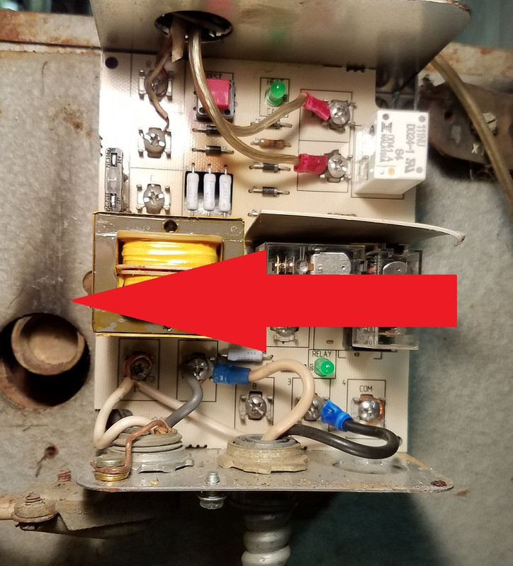

    Yes, I know this is an old thread. Same problem, but now I can fix it. My mom wouldn't let me or anyone else fix it. She was rather difficult to reason with in her old age. She passed away recently, so now I *CAN* fix it.
    Attached is pic of aquastat, and controls. Looking for recommendation for good aquastat, maybe new control - whatever will solve the short cycling problems.
    First, I'm thinking it needs a good flushing out. Hasn't been done since my Dad passed in 2002. Like I've said, Mom wouldn't let anyone fix anything.
    It's hot water, only for baseboard fin-tube heat.
  • Patchogue Phil_2
    Patchogue Phil_2 Member Posts: 312
    Inside of control
  • STEVEusaPA
    Sorry to hear about your Mom.
    It probably has a fixed 10° differential. More important is to figure out why it's bouncing off the high limit.
    Adding on to all the other advice, you (and/or your heating professional) just have to go thru and check each component. ----Check that the system is properly filled.
    -Check that it's purged of air.
    -Check that the circulator is working properly and moving water.
    -Check supply/return water temps, see if they are matching up to the aquastat settings.
    After all of that, add up the btu's of the emitters vs. the btu output of the boiler.
    It just may be that your severely oversized.

  • NY_Rob
    NY_Rob Member Posts: 1,370
    edited October 2018
    Hi Phil,
    Sorry to hear about your Mom as well.
    Although not related to your original post, you seem to have some exhaust leakage in the area indicated by the arrow. You may want to have that looked into before putting any additional $$ into that boiler.
    I had the same boiler in my 1963 home in mid Suffolk (they probably installed thousands of them here on Long Island back in the 1960's). It developed an exhaust leak between the sections and was not worth fixing in 2016. It was leaking low levels of CO into my basement. Luckily the leak was very near the draft hood, so once the draft was established it pulled most of the CO up the chimney with the hot flue gasses. After running for 45min in the morning I could measure 12PPM CO in my basement. Sometimes it was higher if the boiler didn't run for long periods.
    It was 53 years old when I replaced it.
    Please be safe......
