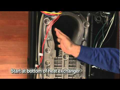

    hot_rod Member Posts: 25,174
    The service should go like this
    https://www.youtube.com/watch?v=Rp8C8VgFySc
    If the sensors have been tested or replaced and the temperature is in fact rising too fast, either the pump or plugged HX should be checked. It sounds like a lack of flow.

    The service guy has cleaned my heat exchanger each year, but of course on the fire side of the exchanger. If the issue is a plugged heat exchanger, I assume the water side would need to be flushed or cleaned in some way.

    Aluminum block boilers can be sensitive to aggressive fluids and they require special formulated glycol and inhibitors. Some aluminum boilers ship with treatment for the water side.
    Any pex or rubber tube in the piping?
    If in fact the control is telling the truth and you are seeing high temperature across the HX, it is probably time to clean and flush.
    Use a cleaner designed for aluminum blocks, Rhomar, Fernox and others blend a specific cleaner.
    Run the boiler up to temperature so the cleaners work well, run for a day if possible.
    I'd use a purge pump to get a good flow velocity through the boiler to flush out everything the cleaner loosened up. Flush into a white bucket or two to see what comes out. Just flowing fill water many not give you enough flow velocity to scrub all the passageways. A 1/2 hp purge pump is usually adequate to flush the block if you isolate it from the system piping.
    Then make sure the fill water meets the boiler spec, hard and or high TDS water, high chloride levels should not be used. Buy or filter the fill water. Test it onsite or send it to a lab for analysis.
    Lastly I'd add a aluminum friendly treatment after it is filled and purged. It will add a thin micron thickness film protect those cleaned, bare aluminum surfaces.
