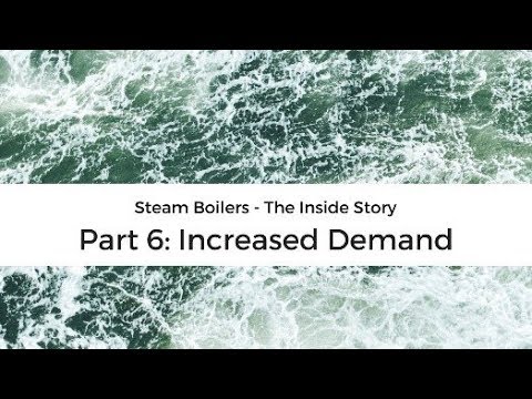

    These videos of commercial boilers from Spirax Sarco tell the whole story, in my opinion and more importantly under normal conditions.
    Here's video 1. You'll have to go to their Youtube page to find the other ones, I believe there's 9. Some even showing water being pulled into the takeoff just as we're discussing here.
    https://youtu.be/_NOftnDDOyE
    Video 3 shows exactly what you were talking about with the gauge glass vs water level.
    https://youtu.be/HG0M9wPDnzY
    Video 6, shows the water being draw into the riser.
    https://youtu.be/4yW2mKqi8Gc
    Obviously these are high pressure commercial boilers, but the behavior is likely very similar even with a small low pressure steamer. As water gets drawn near the supply tapping, higher velocities will tend to draw it upward and in. The larger the tapping, the less likely it will happen.
