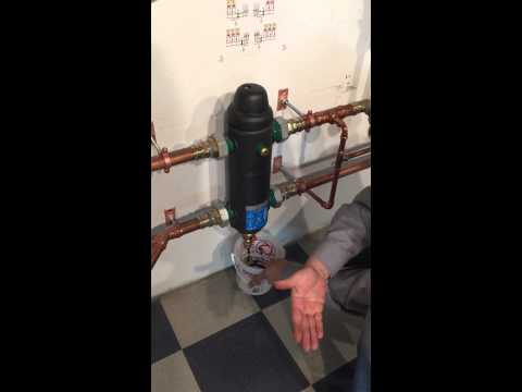

    hot_rod Member Posts: 26,475
    Magnet separators are designed to catch the very fine magnetite particles as they flow through a system. These particles are much too small for a filter or strainer to trap.
    So the magnetic separators are used in systems to catch and remove these particles before they cause problems like you seem to have :)
    We have greatly increased the offering of these devices after seeing how well they protect modern hydronic systems, up to 14" pipe size.
    Manufacturers of ECM electronic pumps are strongly promoting these type of separators to help eliminate potential binding caused by the particles attracting to the permeant magnet rotors.
    The one, red bucket photo is from Kevin, a long time contributor here.
    here is an example of one of the 4 in 1 magnetic devices being blown down.
    https://www.youtube.com/watch?v=9fIQ-z794bc
    And a DiscalDirtMag with Kevin in the driver seat.
    https://www.youtube.com/watch?v=WEGbtwuc6dg
