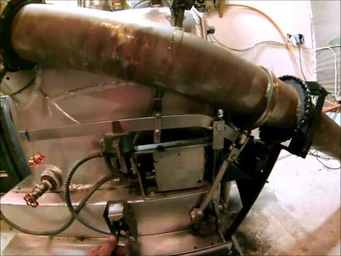

I was thinking of taking on a new project. I have a stoker boiler (Axeman Anderson 260). It has a 1/2 HP 120VAC motor that drives the auger, and reduction gear for the automatic ashing mechanism. Soon it will have a vaporstat, and I will be adding some proper venting to the mains. The system is single pipe steam.
I was thinking of a VFD to control the fan speed while operating, instead of it going full blast @ 1725 RPM. The auger and asher turn at a specific RPM, and work in unison with the fan. There are 2 pulleys off of one motor. One drives the fan, and the other drives a reduction gear that connects via chain to the auger, which is also connected to a cam that shakes the ashes off of the lobe that is part of the auger tube.

https://www.youtube.com/watch?v=aXRrZGkx4m0
That is of an Axeman Anderson 130. Same setup as far as operation (though they might have
Here is another one.
https://www.youtube.com/watch?v=emwHCuZ0thk 0 -
