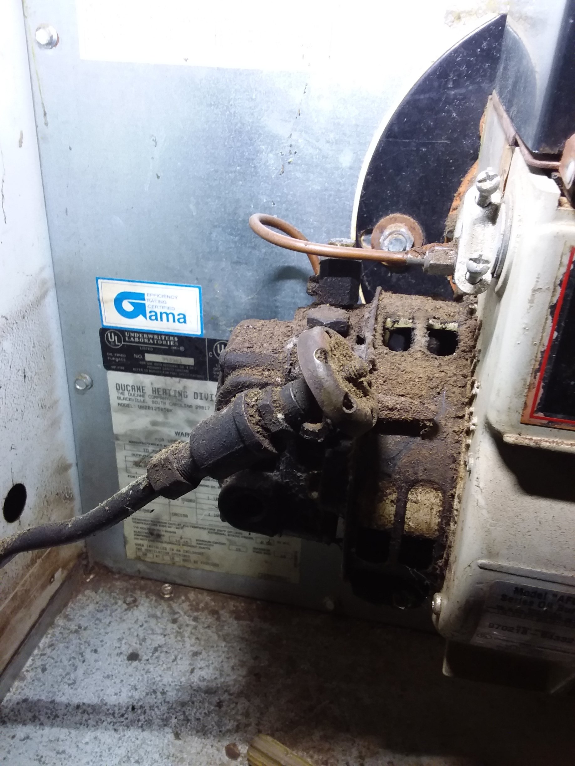

    WWhat is the best replacement for this I have one that is not working was thinking genisys

    What model burner do you have? You'll need the Igniter, primary, and eye assembly with lead. Is there a delayed oil valve? Is there a junction box above the motor?

    Model. AFG. Serial #970218-94332 no junction box not sure if it has delayed oil valve

    Genisys 51531 is a kit has control ,ignighter, eye, junction box but I am not sure
    HVACNUT Member Posts: 7,622
    When was the last time it was professionally serviced? Looks a little neglected. And compression fittings? In 2025? No delayed oil valve.

    that really needs to be cleaned, vacuum and brushes, pull the motor off, because I guarantee, that crud you see on the out side will be on the inside and interfering with proper air flow. an up to date primary control and ignition module doesn't cost to much
    EdTheHeaterMan Member Posts: 12,675
    • Genisys 51531 is the proper control kit for you to get rid of that Genisys 51531.
    • 3/8" brush is the proper part for cleaning the crud off of the burner fan
    • Combustion Analyzer Kit is the proper tool for checking the combustion adjustments after you clean that burner and the flue passages thru the boiler/furnace.
    I strongly recommend that you do not purchase the Genisys 51531 or the 3/8" brush, If you don't have the Combustion Analyzer Kit to make the proper adjustments when you are finished.
