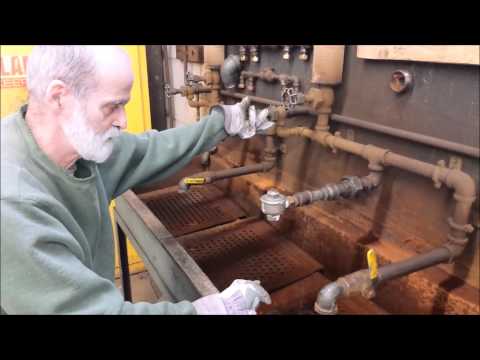

    Cool... you were able reuse the original cap .. no pics of what was originally in there ? Should of mic'd Danny :)
    Well @slater kinda like hitting the lottery on one ticket ... you came to the right place with your question... probably time to change them all out ..
    @Sailah Something I've been kicking around..any thermostatic element that runs on an expansive liquid you can probably fit ?
    A mic on Danny would have been...interesting ;)
    The original cover sealed up perfect no leaks. On the video it was just hand tight.
    Our thermostatic elements are filled with a top secret liquid...
