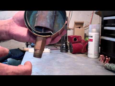

I mounted two Gorton #2 at the end of the dry return (see photo). I just fixed one leaky radiator valve union, so I turned up the thermostat to see how everything else is working after a big setback. The primary intent was to verify the pressurtrol. This is the first time since installing the Gortons that I've really turned up the thermostat. Normally the PSI stays at about 0 and the thermostat is controlling the boiler. Pressuretrol dial is at 1 with 1/2 on the cut-in.
When the pressure got up to about 0.4 PSI I noticed that the Gorton mounted on the elbow was hissing out of the top of the valve. By this time all of the radiators were hot and vents closed from steam. I was also getting a few drops out of the last elbow of the antler too. It seemed to be from the nipple end, not where the Gorton screws in. I'm going to pull the antler down and see if I was a little too gentle in my assembly process.
It seems pretty clear that this Gorton is bad. Any thoughts on anything else that I should check? Until now, I've never really been sure when the Gortons close. They do get "hot" though and that seems to coincide with the radiators getting hot.
To test again and also verify the pressurtrol, is it a bad idea to close off all (or maybe all but one) radiator and let the boiler build its pressure and avoid waiting for the radiators to heat up?
The boiler is a Burnham Independence IN4. The water in the sight glass drops about an inch and only bounces about 1/8". I skimmed yesterday.

I took the antler down (thanks again for those that recommend mounting on a union!). When I tipped it, a bit less than a teaspoon of water came out. When I installed the antler, I was careful to be sure the horizontal run where the Gortons are mounted has some slope back towards the dry return. What I forgot to check was the horizontal coming off the vertical. I reused the tee off of the dry return where the installers had mounted a #35 and it "looked" vertical. Unfortunately, it isn't so condensate is collecting at the horizontal elbow before the Gortons. The Gortons heat up but could this bit of water be messing with the steam that should be closing off the Gortons? That doesn't seem to explain why one closes and the other doesn't but I will to fix this problem and retest. The T is 12 years old and wouldn't budge. I think I'm going to replace the first 90 after the union with two 45s and remount.Home owner, 1927 2-story, single family

I tightened the antler up and swung it around so that there is some pitch all the way back to the vertical nipple. No drips, but still getting continuous venting on one Gorton and the outside of the case went up to 190 or so. When I had it off the antler today and turned it upside down, the vent closed off. The other had no evidence of venting and the case only went up to about 150 before cooling off a bit. The misbehaving Gorton is only a couple of weeks old. I think I will return it and get a replacement.Home owner, 1927 2-story, single family

That is a bad reflection on Gorton's quality control I guess. According to the Gerry Gill video they will start to close at around 110 F and at about 130 F it may be closed, so for it not to close at 190 F is pretty bad. Did you try cleaning it with vinegar? I know that is nearly brand new but you never know if a bit of rust or grit got blown into it already. Another thing I've wondered about is how sensitive are they to not being vertical? You want the pipe to it to have pitch but maybe the vent itself still needs to be fairly vertical.
https://www.youtube.com/watch?v=Wl8vQ2MYhMs
