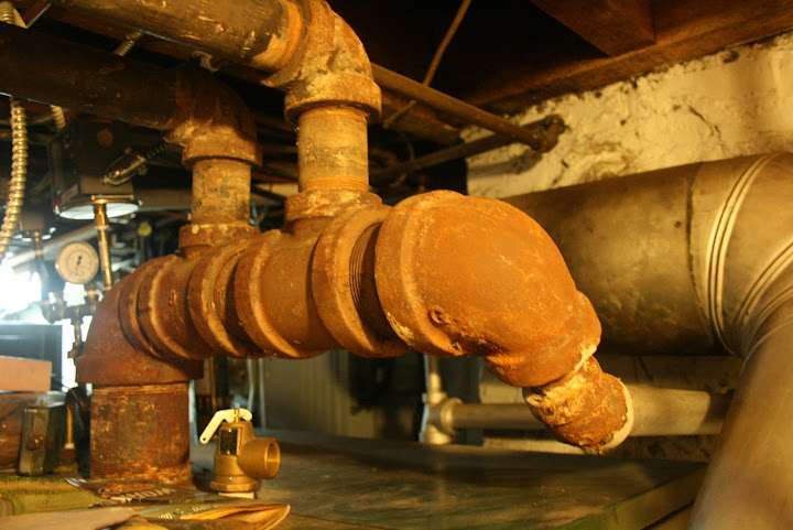

I've attached some pictures.
The furnace is a Lennox Series PVSB-6D Model GSB8 187S
The PSI info I'm little fuzzy about cut off but I'll give it a try and I took the cover off the controller and took a picture
The outside cut in is set to 0.5 (I actually adjusted this down after reading the We Got Steam Heat book and it did cut down on the noise a bit (I got it out of the library after the 5th time they came to skim the boiler with no change in teh noise). The cut off I'm not sure . . .inside the box the white wheel is set at 1 "Diff" so maybe 1.5???0 -

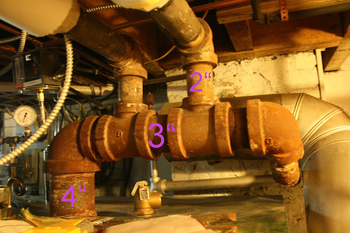

hartford dirt leg??
It's hard to tell from the picture, but is that a hartford dirtleg? can you provide one more of the bottom left piping from a more straight on view?
i don't like the piping above the boiler myself, this could be part if not all of your problem. likely the old boiler was much taller .. and it looked a bit more like my piping (below).. at one point .. i don't like how they tee'd one of the mains off of your vertical pipe section.
the piping that runs direclty across your boiler also looks a bit lower than the 24" it likely should be above your waterline.1-pipe Homeowner - Queens, NYC

This furnace replaced one that was probably 30 years old and was definately bigger. Fortunately it was not the original one that came with the house. The previous owners had to dig that bad boy out. You can see blocks under the furnace and the entire thing sits in a depression from the original furnace.
I think I'm coming to the conclusion that I need to get a different company to come and at least look at the whole set up, but I want to have all my ducks in a row before I do that.0 -

I was thinking firing rate too.
That lennox looks ecr/dunkirk-esque and can be quite the wet steamer if the gas manifold pressure is too high. Also have had to resort to surface blow-off with the boiler running. Those 2" header lines may be what's in the manual, although we all know going at least one pipe size larger on the header would be better.Terry T

I can actually answer two questions!! Radiators and yes I have the manual. The manual seems to indicate use of 2 1/2" pipe.0 -
good...and is the piping
actually 2 1/2''? hard to tell via the pictures.gwgillplumbingandheating.com
Serving Cleveland's eastern suburbs from Cleveland Heights down to Cuyahoga Falls.0 -
piping going up to pipe feeding radiators is 2 1/2"
Pipes going to return on lefst side of boiler are smaller.0 -
