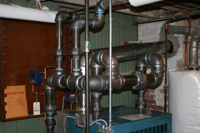

    Pipe layout at boiler
    Here is the near boiler layout. The main that supplies the non heating side of the house is on the left (B) along with it's associated dry return and common vent.
    I have cranked the pressuretrol down as far as I can, I am see 1-2psi (gauge is useless 30-0-30
    There is one small radiator that gets hot (in and out) real quick on the A leg. I have cranked down (to about 50%) all the rads on the hot side, and there is a slight improvement (bedroom rad now about 60% full Vs 30%)
    So if this is a Vapor system, at sometime my boiler was upgraded (mistakenly) with a Pressuretrol, so where can I find vapor stat and this a straight swop for the pressuretrol.

    You have some piping issues way beyond simply changing to a vapor stat. more piping photos would be helpful. What type of pipe is under that wrapping?

    Main B should not be bullhead from the riser for main A .. it should be its own riser .. I attach some pictures of what should be a fairly easy change .. perhaps using 2 pcs of 45deg Elbow...you piping also looks a bit small although you don't say anywhere what the brand and model of your boiler is.
    fyi, my fix might be helpful, but it still violates the rules of having the steam travel in the same direction .. i'm trying to find a boiler that has 2 side end taps that is well piped ..
    FOUND ONE .. From Mr. Gill's Website .. [url=http://www.gwgillplumbingandheating.com/webapp/GetPage?pid=221]http://www.gwgillplumbingandheating.com/webapp/GetPage?pid=221 .. notice how there are no risers to mains until AFTER the boiler risers .. this means that all steam is moving from LEFT to RIGHT .. and his main risers are in the extreme right .. AFTER the 2nd boiler riser.
    AFTER A 2nd LOOK .. i realized that your tapping are on top of your boiler .. you should strive to pipe it more like this (Also from Mr. Gills Website) http://www.gwgillplumbingandheating.com/wahelper/GetImage?id=78534
    Lastly, if in the future you could upload your photos in higher resolution (larger size) that would be helpful.

    While there is obviously some piping problems with the near boiler piping, I'm a bit confused about the other pipes going through the house.  We have two steam mains leaving the boiler and following one steam main at a time, we should have two mains (a Steam Main and a Return Main) ending in the Wet Return (unless there is a Crossover Trap which doesn't seem to be used with this type of system) There should be a main vent on the end of the Dry Return Main (see attached drawing) and also a main vent on the end of the Steam Main (though this wasn't probably needed in the "coal days" but would be very beneficial now)
    With the two Steam Mains, we should have two pairs of pipes (4 pipes total) ending up in the Wet Return.
    Present Piping- From what we can gather from the pictures, there is one vent and one drip pipe to the Wet Return serving two return pipes.  The first question is : Are these return pipes from the Steam Mains or the Dry Return Mains?  The second question is: Where are the other pipes?   Trace down each Steam Main and let us know where the piping goes and how it terminates (should be in the Wet Return per the drawings)  Then trace down each Return Main let us know how they terminate (should be in the Wet Return per the drawings)
    Once you get the piping straightened out you should have a system which is very comfortable and economic. You might want to take a look in the "Find a Professional" at the top of the page, scroll down to the "States" Listings and see if there is a Steam Pro listed near you.  Let us know what you find with the piping.

    As has been mentioned there also seems to be some problems with the piping near your boiler, If you could take some more pictures of your boiler's header piping from different sides so it shows how it connects to the boiler and to the equalizer it would help a lot.
    (A previous picture just shows the top of the boiler and pipes, but not how they are connected to the boiler). I think with just a few minor changes in piping of the return and possibly the boiler, you'll have a much more efficiently running system.

    Piping Needs to be Changed
    Hi Again-  Sorry to hear you are getting more snow. We're expecting more this weekend though the temperature is unusually high so it maybe rain. Just keep in mind that spring is (supposedly) on its way!
    Thanks for the kudos though I don't deserve them as I was just passing along what I have learned from Dan and the Steam Pros, who graciously share their  knowledge on this board.
    The result of shutting down your "good side" and that then the "bad side" works, shows the problems of the "combined return"  Splitting and venting the returns individually should correct that.  I had a chance to blow up and take a look at your boiler header and you have a some problems there. The two exit risers coming out of the boiler are connected wrong. (If you have "The Lost Art this is discussed on Page 51) As they are configured now the steam streams coming out of the boiler oppose each other and collision between the steam streams and with the steam stream and the condensate. The result is inefficiency and the dreaded "wet steam". Correcting this and giving each main ("X" & "Y" ) its own individual riser pipe from the header to the main, should make a much more efficient system both from the comfort and economic standpoint.
    - Rod

    Near Boiler Plumbing- Manufacturers take
    Look at the diagram from the original Peerless Manual. It shows more or less what they have installed, so even the manufacturers get it wrong. One fault however is that for my size boiler Peerless say use 2" outlets and 3" header supply (1.5" equalizer). Who ever plumbed my boiler used only 2" for the header supply (same as mains). Another poster directed me to a super setup : (http://www.gwgillplumbingandheating.com/wahelper/GetImage?id=78534) which looks like 4"... I wish he lived nearer me!
  • So much for Boiler Manuals
    It's hard to believe that a manufacturer would make such an elementary mistake. They must have been thinking hot water at the time rather than steam. Are there any other drawings in the manual that show it this way? Yes, Gerry Gill designs some very righteous headers! Here's another link that shows a piping correction he did to a boiler that had opposing boiler exit risers. http://www.gwgillplumbingandheating.com/webapp/GetPage?pid=221
    See this info from the Peerless Steam Survey doc (this is a very useful form for people to understand their systems... and would have a been a great help to whoever installed my system wrong.
    See the updated page from Peerless compared to the orginal.
