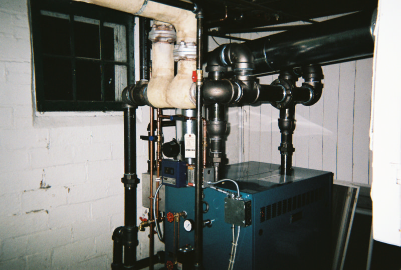

I had a boiler installed with an incorrect header configuration (as per the mfg's installation instructions)which causes an unequal distribution between the two steam mains, because of bullheading on the system risers. The problem with correcting this - by putting the two system takeoffs between the equalizer and the boiler riser nearest to the equalizer - is that providing the recommended spacings, the first system takeoff at least 15" from the nearest boiler riser , comes in close conflict with a beam. The old boiler had its supply tapping in the tops of the boiler sections and at right angles from the present boiler tappings - this allowed a more direct connection to the system connections.

I was wondering if the header configuration used by the installers in the following link (provided via E-Mail by a forum contributor) would meet the mfg's recommendation. http://www.gwgillplumbingandheating.com/wahelper/GetImage?id=41492 Their header seems to have a right angle turn, and then the system risers take off and the equalizer terminates the run. If this could be done in my situation it would greatly simplify obtaining the recommended 15" between the last boiler riser and the first system riser, and would make the connections to the system mains much more direct. Sorry for the uninformed question, but I made the mistake of dealing with some uninformed installers. My appreciation to anyone who takes the trouble to consider the matter.0 -
hey Bill could you try and upload some pictures of your current header and near boiler piping?
The link to the literature you provided bounces tot he main page of the manufacturer. What model boiler do you have?
Also the photo of the dropped header you linked to looks great! I see no problems with turning the header 90 degrees.

I've got a picture of my piping setup as an attachment. If you use the vent pipe as a means of orientation, then to the left of the vent pipe a boiler riser can be seen connecting to the header. Just to the left of this it tees in above the equalizer. Then the two system risers run in one pipe or bullhead I guess until they diverge and go to the two system mains. The system riser towards the back of the picture, or closer to where the vent pipe goes into the chimney, goes fairly directly into the system main. The system riser towards the front of the picture diverges from the common system pipe at a right angle, and then does a horizontal run, and takes more turns before it goes into the other system main, which is the one getting shortchanged on heating.
I'm thinking that if the present header made a turn towards the front of the boiler, this would provide the necessary 15" separation called for between the last boiler riser and the first system riser. It would also make the system riser connections to the system mains much more direct and easy. Where the new header section ended in the front the equalizer would be situated after the last system riser.
In order to accomplish these spacings otherwise the present header would have to be run straight out to the left for a good distance, where it would come in conflict with a beam, and necessitate long and awkward system riser connections to the system mains. Of course I would have the 2" copper(should be 2 1/2" according to the manual) replaced with the schedule 40 iron pipe, and have the header size increased to 3" inches? Any advice is apreciated.0 -

As Norm said it would be helpful if you could provide more pictures. We need to see all the boiler plumbing, high and low. Take pictures at distance in high resolution from all sides and then they can be blown up and each area individually examined.
My first thought is that it is almost winter, wouldn't it be better to put this off till the spring /summer? With that thought I'm wondering how well your system is working now and what can be done to improve it as it now stands. You say that you aren't getting enough heat in one main. Is it possible that the "no heat main" isn't properly vented?...meaning that the vents on the end of that main aren't working properly?
As you seem to already know, copper, at least on the steam side of the boiler, is a rather a "no-no". I would use a drop header myself, something long the line of the picture you posted of the system (with the elbow) done by Gerry Gill (who does very excellent work BTW). The use of elbows on the risers allows movement which lessens the strain on the boiler and its sectional joints when the header pipes expand and contract.
Just for consideration...since you get more directional flexibility (tees limit you to a 90 degree layout)when using the elbows, you can route the risers to a more optimum location for your header layout. Speaking of tees,I also might mention that in a lot of photos I've seen of pro work on this type of boiler, a "plugged" tee rather than a elbow is used at boiler connection to bring the riser to the vertical. When installing the header,keeping slope for drainage toward the equalizer and not forming pockets for water to gather,is very important and especially important if you use an elbow in the header.
Proper insulation of the headers/piping also makes a big difference. I was told by the "experts" that plumbed my system I "didn't need insulation - It'll will keep your basement warm and the heat rises". While they may have actually thought that, I have a tendency to think it was just so they could avoid doing the insulation. After reading Dan's books I insulated my headers (plus replumbed them) and now the system works very much better.

Bill: If you go into the library section of this site you can see several examples of dropped headers installed on boilers with supply tappings just like they are on your boiler. There are atleast two examples that have the 15" length requirement you need.
I am fairly familiar with the diagrams for this Lennox boiler. Keep in mind what is shown is the very minimum that is needed to allow the boiler to make dry steam. If you read some of the fine print it is stated that off-set headers ect. will more than likely be needed.
Anyway check out those pictures in the Library and it will be much easier for you to picture how this boiler should really be piped.0 -
