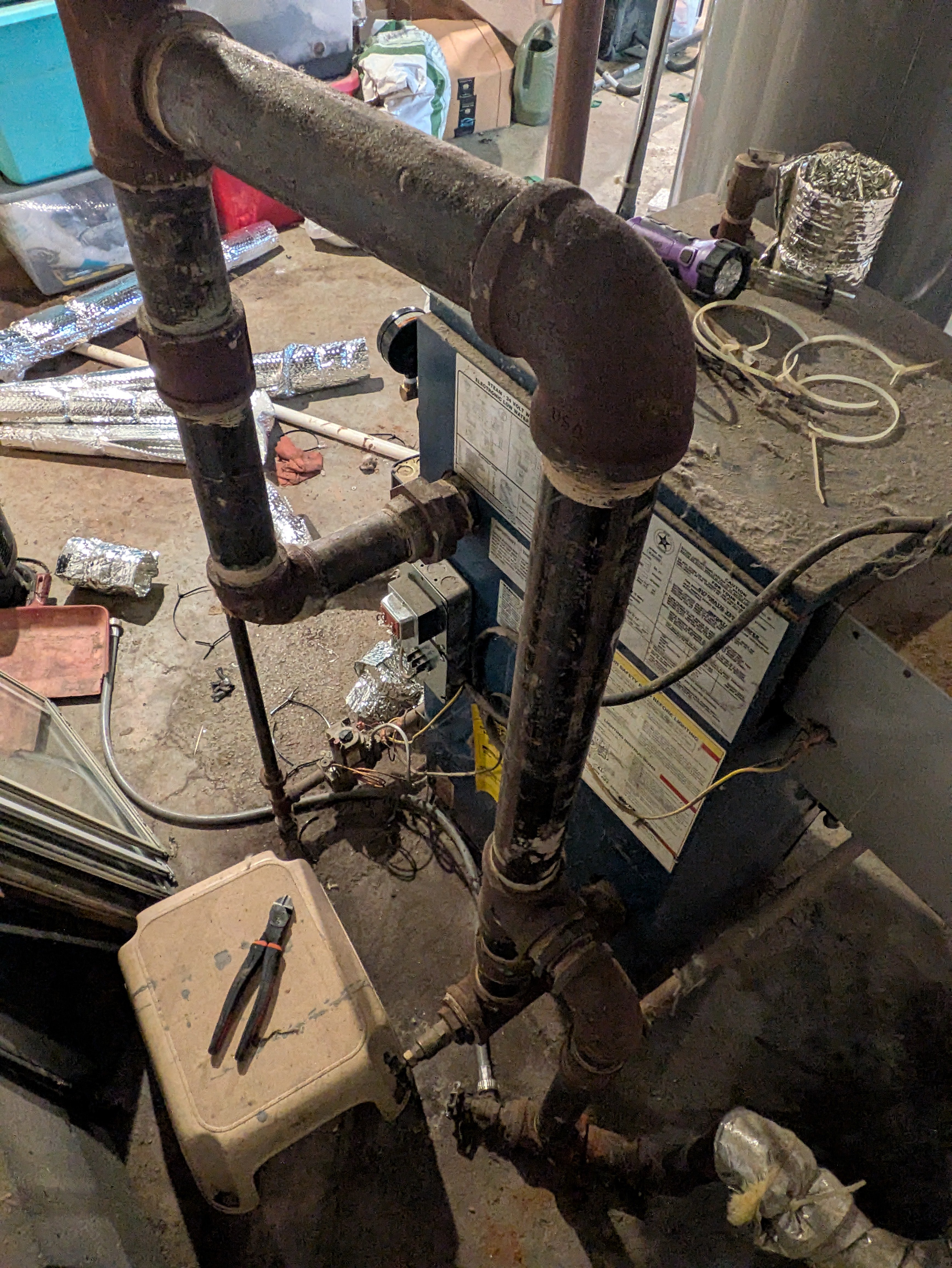

I've got a 20 year old Utica PEG150CDE that has improper near boiler piping but seems to run ok with minimal hammering (although it does use a lot of fuel). There's only 1 riser on the boiler (the other side is still plugged) and it's not clear to me if this boiler should have 1 or 2. In any case, I'm getting my system ready for the winter and have installed 1.5" fiberglass insulation on all the pipes to allow the steam to travel further. I have observed excessive surging in the sight glass in the past. I would like to skim the boiler, but don't have a skimming tee installed. At this point in the season, I'm hesitant to attempt to remove the plug in case the boiler cracks. I saw a youtube video posted by the Silent Steam Team https://www.youtube.com/playlist?list=PLPrJrk_ajqszjb6EkLkHwiBvzpINiL612 that showed him skimming a Utica boiler via a valve installed at the bottom of the sight glass. Is this the best option for my scenario? Anyone have any advice on the best way to skim using this technique or a better alternative?

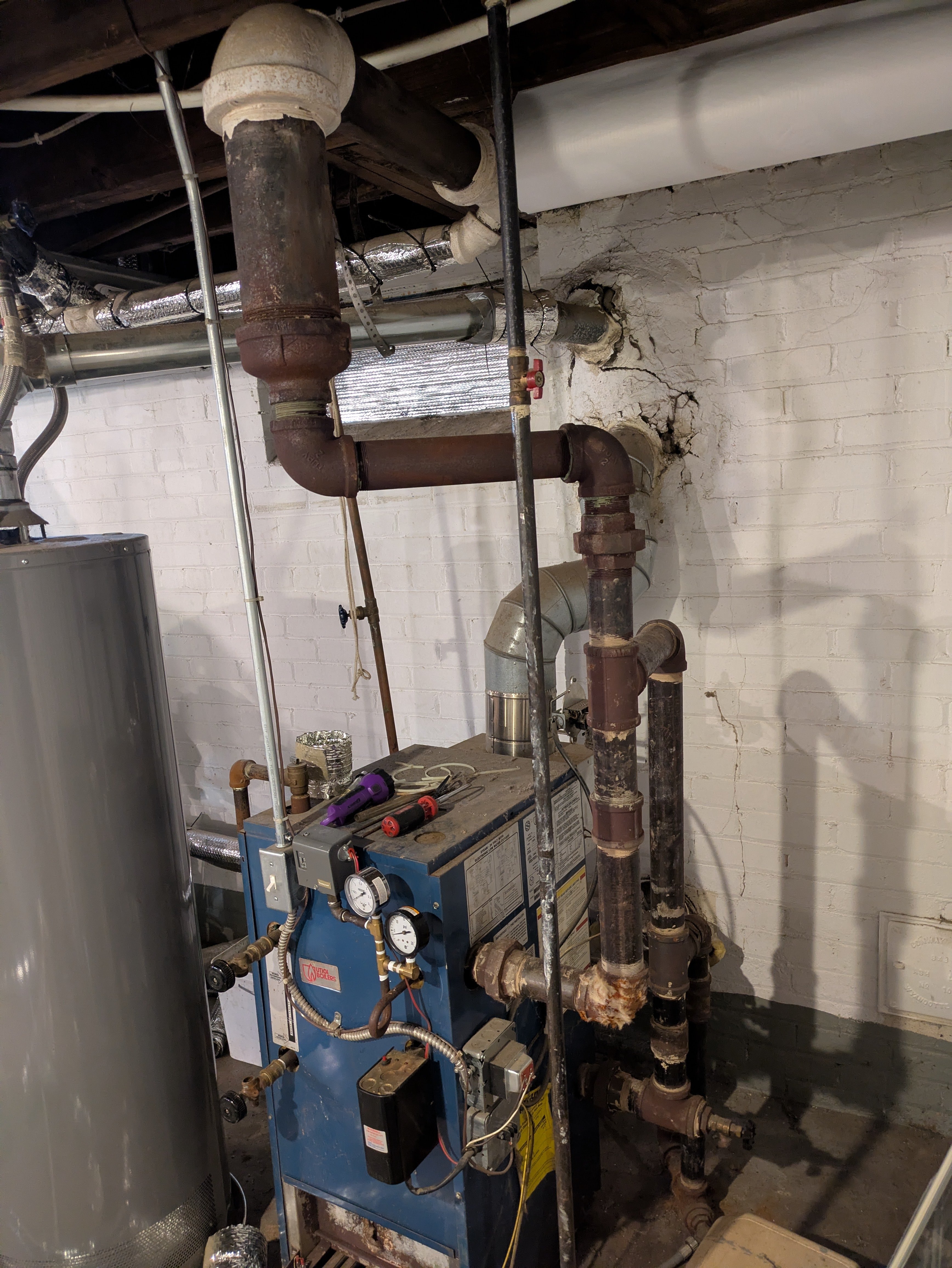

    PEG 150 is supposed to use a minimum of (2) 2" supply tappings with a 2" header. Post some pictures if you can. Usually with the steam tapping off the side a 2" tee is used at the boiler with a plug or cap for skimming
    EBEBRATT-Ed Posts: 21,400
    I would not skim from the bottom gauge lass tapping. The water level would be to low with the burner firing. Although the burner is usually not fired while skimming I would use the top gauge glass tapping. Best bet would be two risers
    Post pics so we can see. Skimming may help enough to get you running better

    Hire a local plumber to separate that union that is right there where the outlet exits the boiler jacket, then remove that elbow that goes upward and replace it with a tee instead. Put a bushing in the tee from 2" to 1-1/4" then a short nipple and a ball valve, then you're all set.

    Who ever installed the boiler didn't do you any favors. If you go on Utica's site you can download the manual and see how it should be piped. Not all that bad to fix it right. You may try adding the tee as @ethicalpaul mentioned to see if you can get by the way it is. The equalizer is also all wrong.

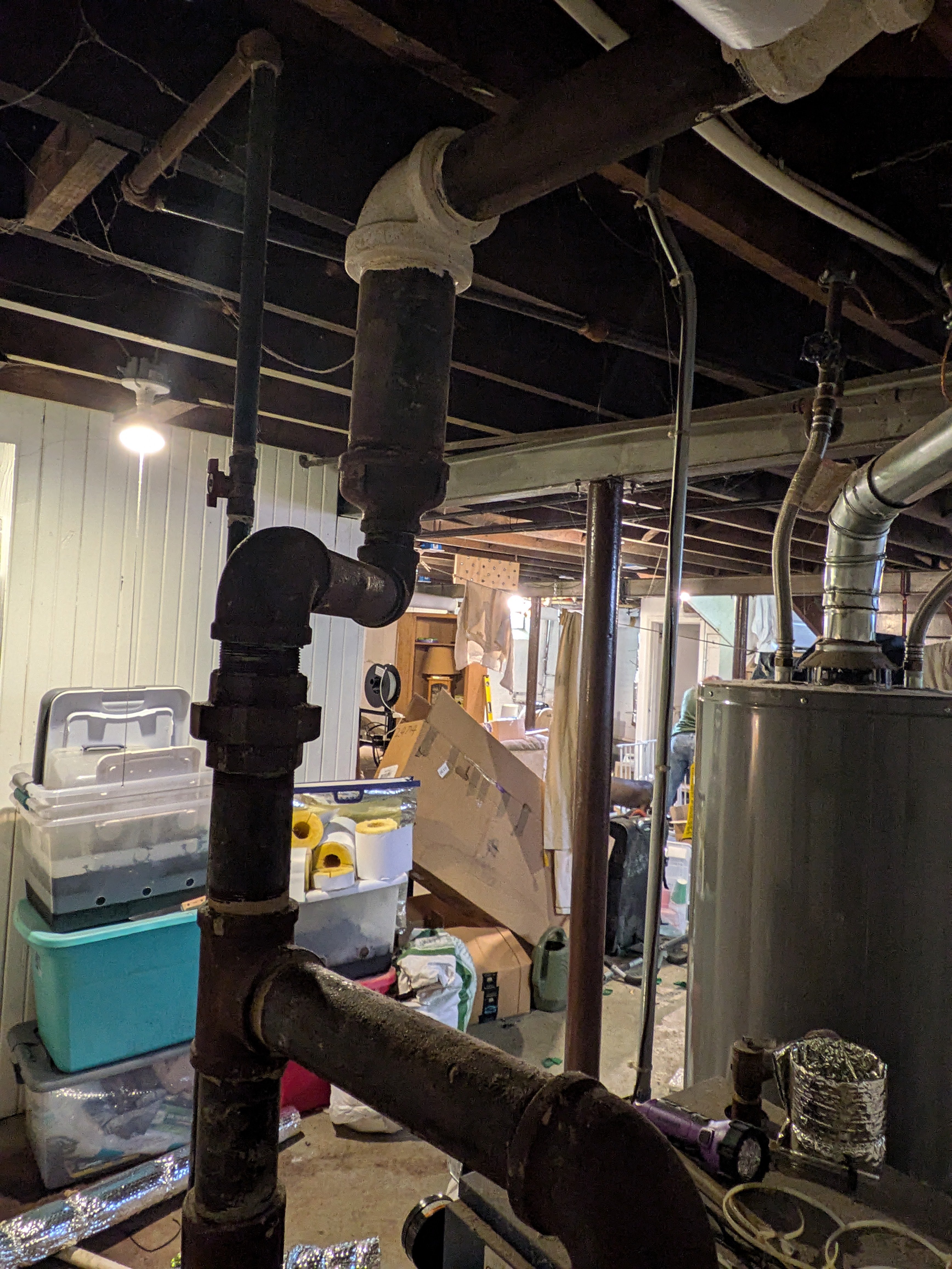

    Is that a 2-inch pipe going up into a 4-inch pipe?

    Take the 4 x 2 reducer off. Put 2 4 x 2 tees on the drop with the 4 x 2 reducer back on the bottom for the equalizer. Feed the two boiler risers into the new tees. it will look like crap but it will work. Headers don't have to be horizontal.
