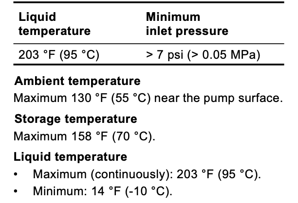

    That is unusual to replace 3 circs in the time periuon. Could be that zone never gets air free? Is there a central air purger?
    You need at least 5 psi at the circulator inlet. It is a temperature/ pressure relationship to prevent cavitation. If for some reason the boiler runs hot, maybe 203°, you need about 7 psi at the pump suction.
    Dirty fluid takes out bearings also.
    Is the motor mounted vertically by chance?
    I am not sure about this. I think so. Here is the boiler meter. Temps ~175 when hot, pressure at the boiler is ~20. I can't measure what the pressure is at the inlet to the circulators, but because the expansion tank is between the boiler and circulators, I think 12 PSI? One thing to note is the other circulators, which I would think have the same inlet pressure, don't have an issue.

    hot_rod Posts: 28,816
    you might try a different circulator. Maybe a 3 speed or one of the ECM versions.
    Typical zone pumped system. A circ on a zone probably needing just a few gpm. Typical 3/4 fin tube specs show 1-4 gpm.
    So the pump is running way off to the left of curve. It would like to be running near the middle 1/3 of the curve. I’d guess the others are in a similar condition?
