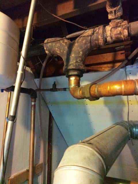

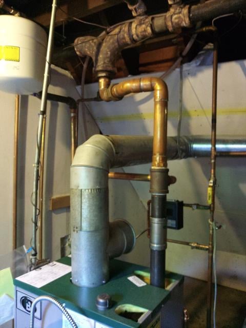

Client says it bangs loudly.
    Intplm. Posts: 3,164
    "Bangs with very loud noises."
    And has anyone ever seen this type of Y-fitting on a steam system? I haven't seen it before.
    The customer said the banging started when the "plumber" replaced the old steam boiler.
    EBEBRATT-Ed Posts: 21,400
    Should be perfectly quiet!!!😎😎😎😎 Looks good from my house!!!
    Looks like a drainage fitting up there. Never saw one of those at least on a boiler. That tee is doing a good job getting the water out of the vertical header
    Jamie Hall Posts: 28,029
    You have got to be kidding. Never seen the like, and I'd be much more astonished if it didn't bang.
    Steamhead Posts: 19,026
    ISTR that tee is actually called a "dual elbow" or something like that, and was frequently used on steam systems where the boiler had only one riser. it should work OK as long as the piping leading up to it is right, which this is not.
