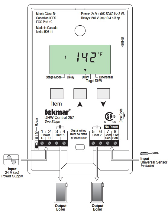

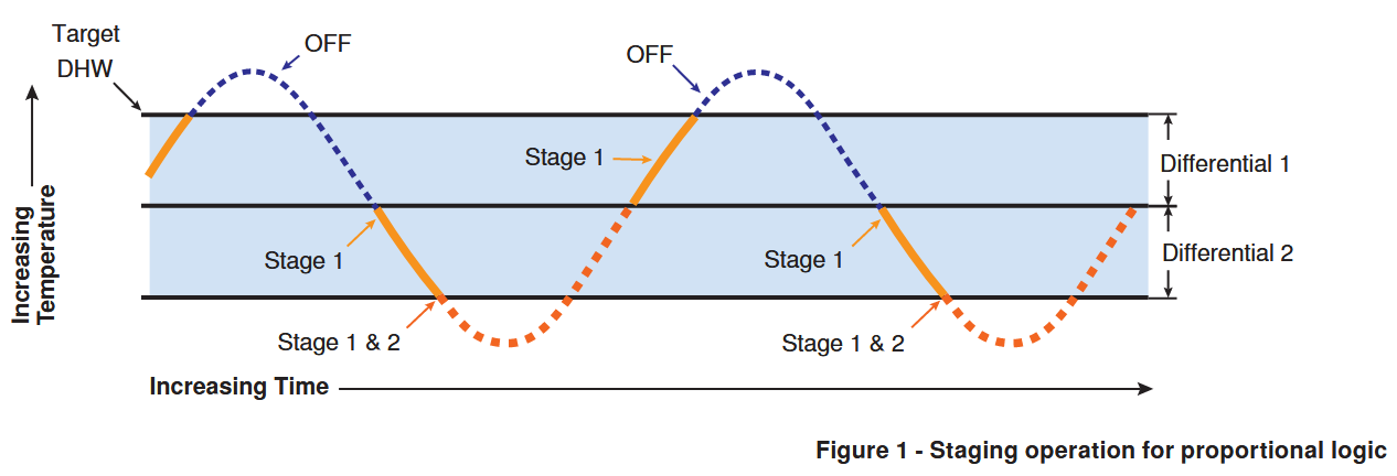

    The Tekmar 257 possibly could be utilized to do the boiler staging control. Since it does not have a demand input, the heat demand thermostatic control would have to interrupt the T-T to both boilers from the Tekmar 257 controller. The Tekmar 257's literature would have to be read, and understood to verify it will do what is actually needed for your application.

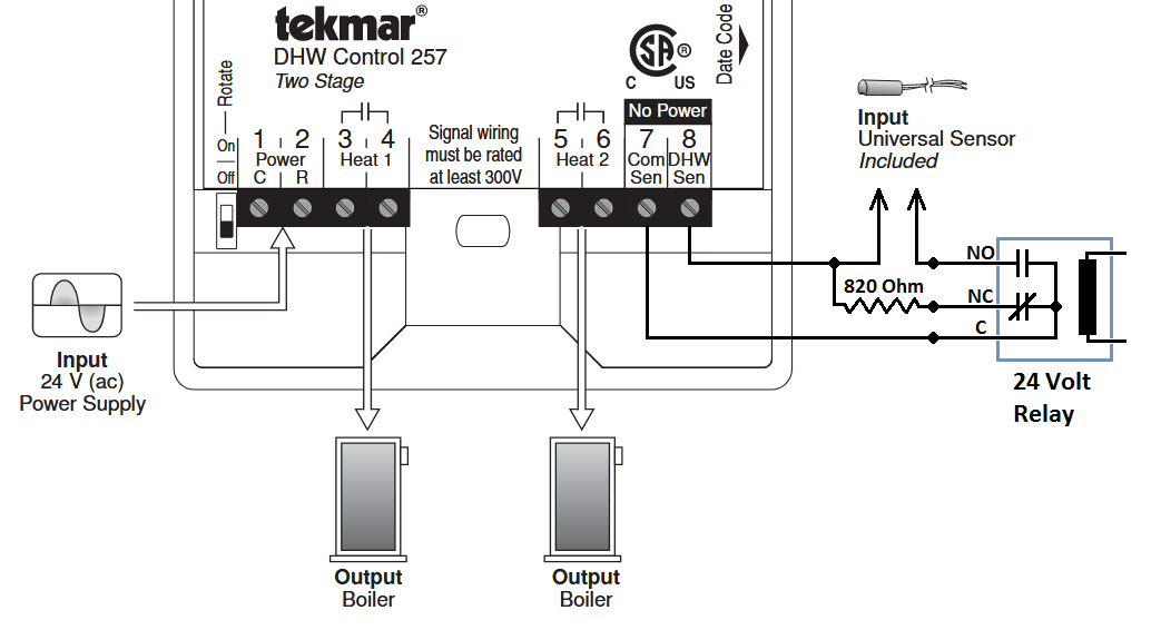

    You may be able to use the Tekmar 257 like this. (No Tekmar 257 to boiler T-T interruption needed, like above)
    When the 24 Volt relay is de-energized (no call for heat) the 820 Ohm resistor is connected to the Tekmar 257's sensor terminals so the Tekmar 257 thinks the water temperature is about 200 degrees shutting the boiler(s) down.
    When there is a call for heat the 24 Volt relay is energized connecting the Tekmar's normal sensor to the Tekmar 257's sensor terminals for normal boiler operation as per the Tekmar 257's programming.
    The 820 Ohm resistor is not critical, it just has to be a value that represents a temperature that is above the Tekmar 257's target temperature. The connections to the 820 Ohm resistor should be very secure, no poor quality crimps.

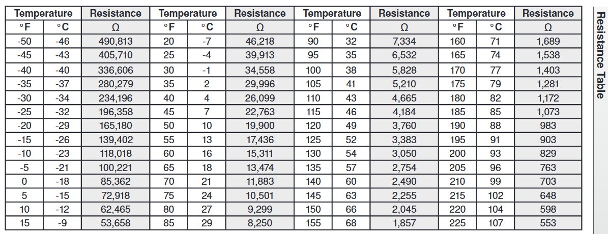

    The used Tekmar didn't come with the temp sensor. Is there anything special about the Tekmar one that is around $50 vs a regular 10k one that I can buy for a few dollars each?

    Appears the B-Constant or Beta is different. You would have to compare the resistance curves to see if the difference is acceptable to your application.

    Apparently the material NTC thermistor sensors are made with is very manufacture specific, standards are limited.
    In the range you are probably going to use it in, it may not matter much. Or you could use a second opinion for the actual temperature.

    Thanks for the info on the thermistors. I wasn't sure what the 3892 meant.
    I did a bit of digging and using the 3950 when the controller is expecting the 3892 would mean
    Controller reads 140*, actual temp about 139*
    Controller reads 160*, actual temp about 158*
    Controller reads 180*, actual temp about 178*
