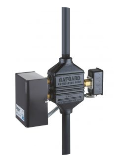

    @109A_5 , that Hydrolevel comes with the chamber.

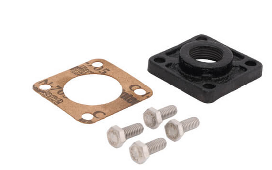

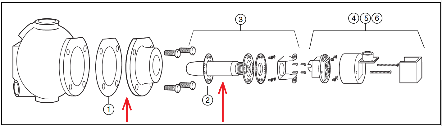

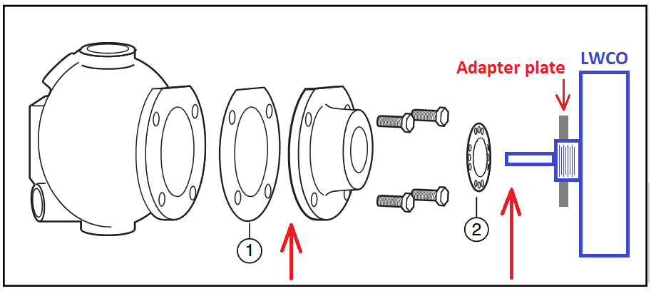

    Additionally if you really want a probe type LWCO and you are handy you probably could reuse the McDonnell & Miller 61 main assembly for the probe chamber. You would have to fabricate an adapter plate to close off the M&M housing assembly and provide a tapping in the plate for the probe. It could go at either place (red arrows). May not save any money, but since you have had this area apart it may save some re-piping aggravation.
    A modified Dirt Pocket Cap may work for the adapter plate.

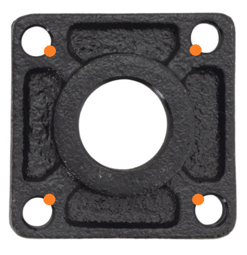

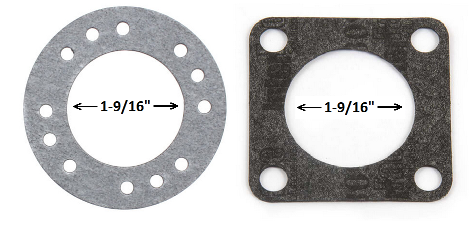

    The mounting holes are not on the same centers. The Orange circles are about where the screw centers are for the switch assembly mounting to the cast Iron assembly.

    I believe that is why they make the larger (than a Tee) cast iron chamber as an 'add on' modification. And you still need to Blow it Down.

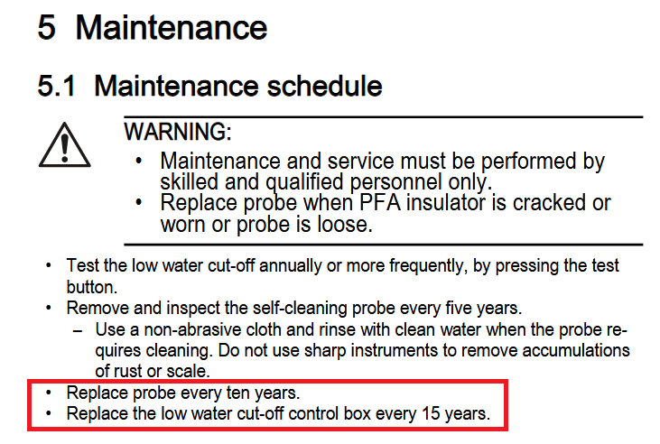

    A probe type may be simpler from an onlookers point view. No moving parts to stick and no float to sink. However there are many more electronic parts that can fail leaving the unit in an unknown state unless tested. To me calling that "simpler" is an illusion. A float type gets tested with every blow-down if you do it correctly. When the probe type is installed in the boiler's block who drains the boiler to test it ? And if they do, how often ?
    And the probe type still has a manufacture's change-out interval that is not much better than a float type.
