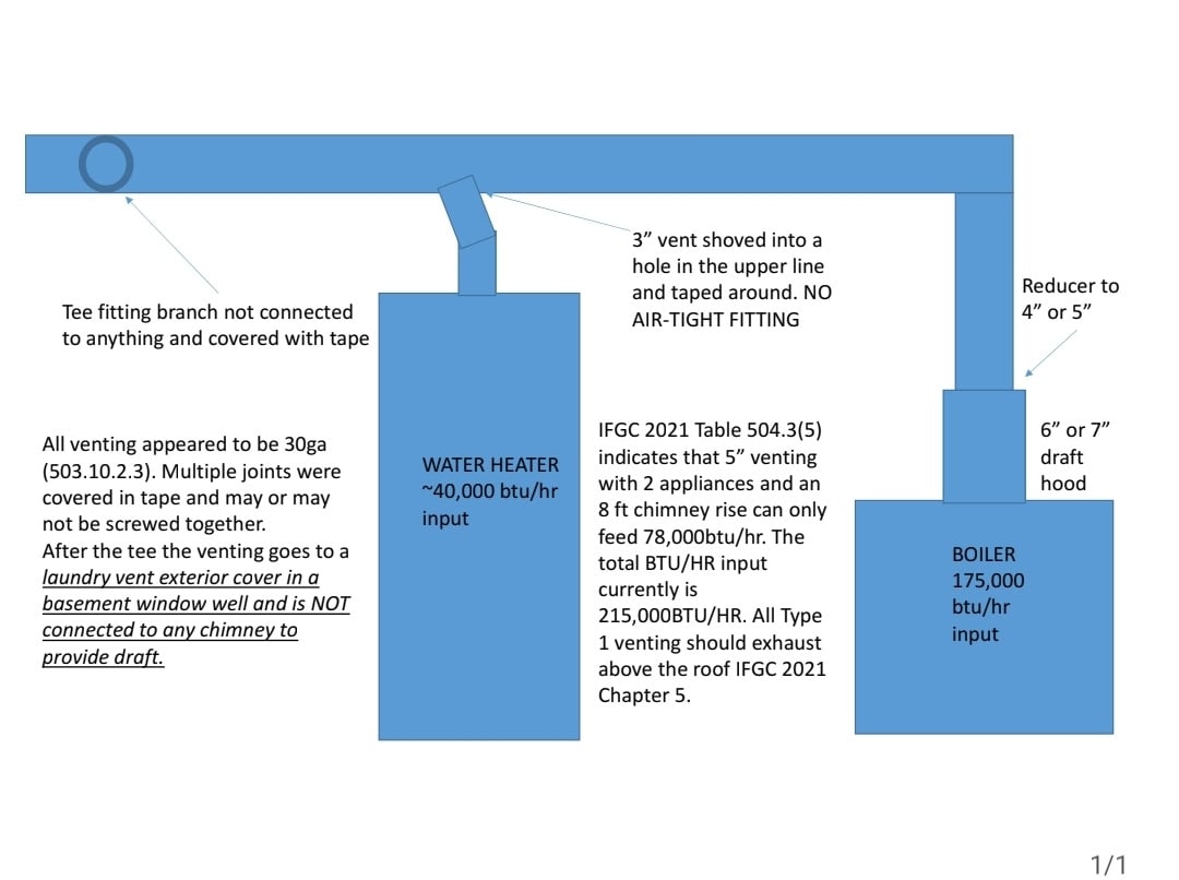

While I was on a service call this week I found the following venting. I couldn't take a picture because after I shut off the gas the owner started freaking out so I left. But this was crazy. I called the mechanical inspector and state fire marshall about it.

Wonder if the owner put it in like that?
sounds like you did the right thing. I wouldn't expect the HO to call you back though, but he should call you and thank you. You may have saved his family.
2 -
I've been in your position many times. You did the right thing ethically, morally and legally. And, no, don't expect them to have a scintilla of appreciation. I always put in a call to the gas utility too. Mad Dog
