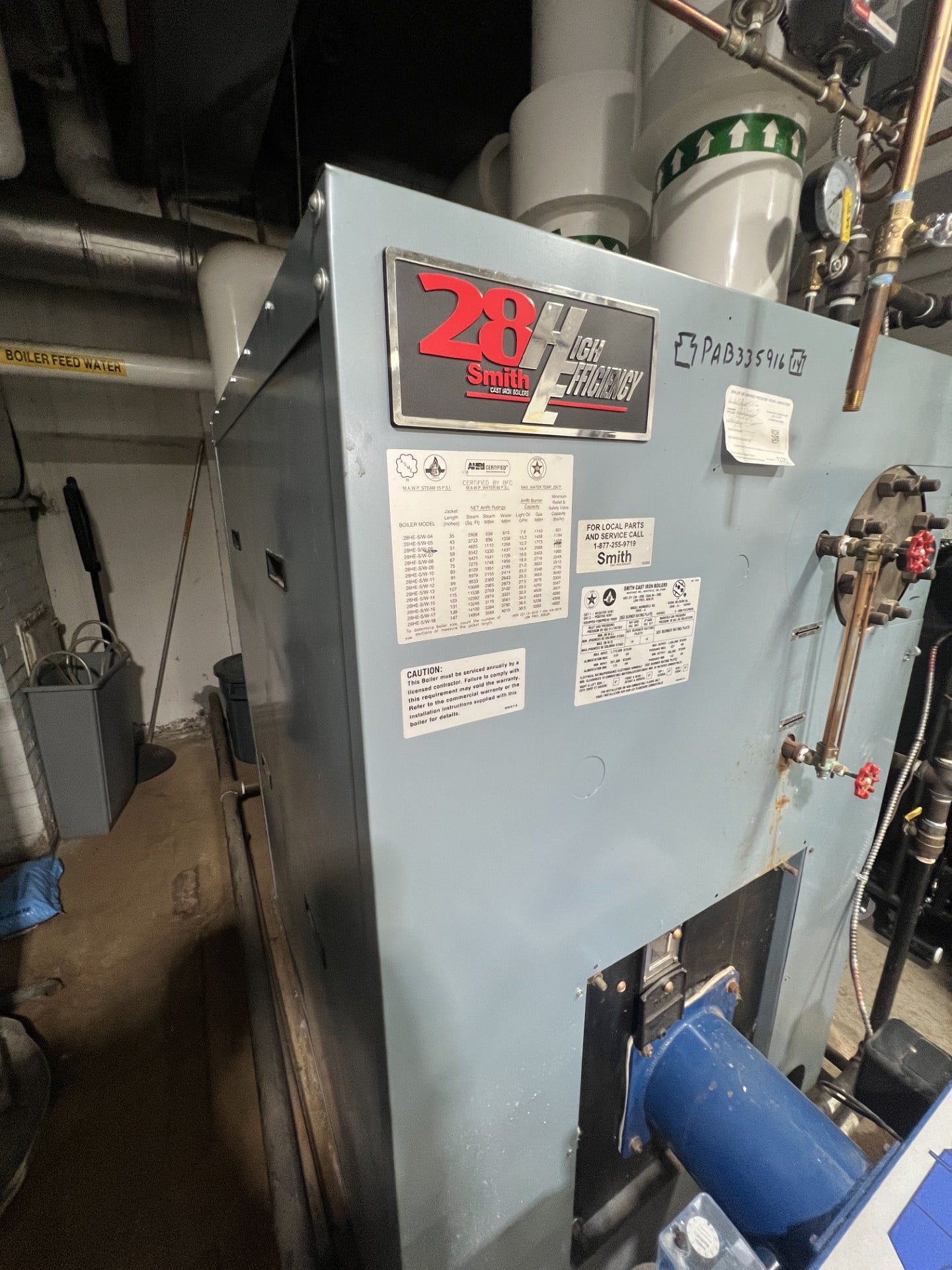

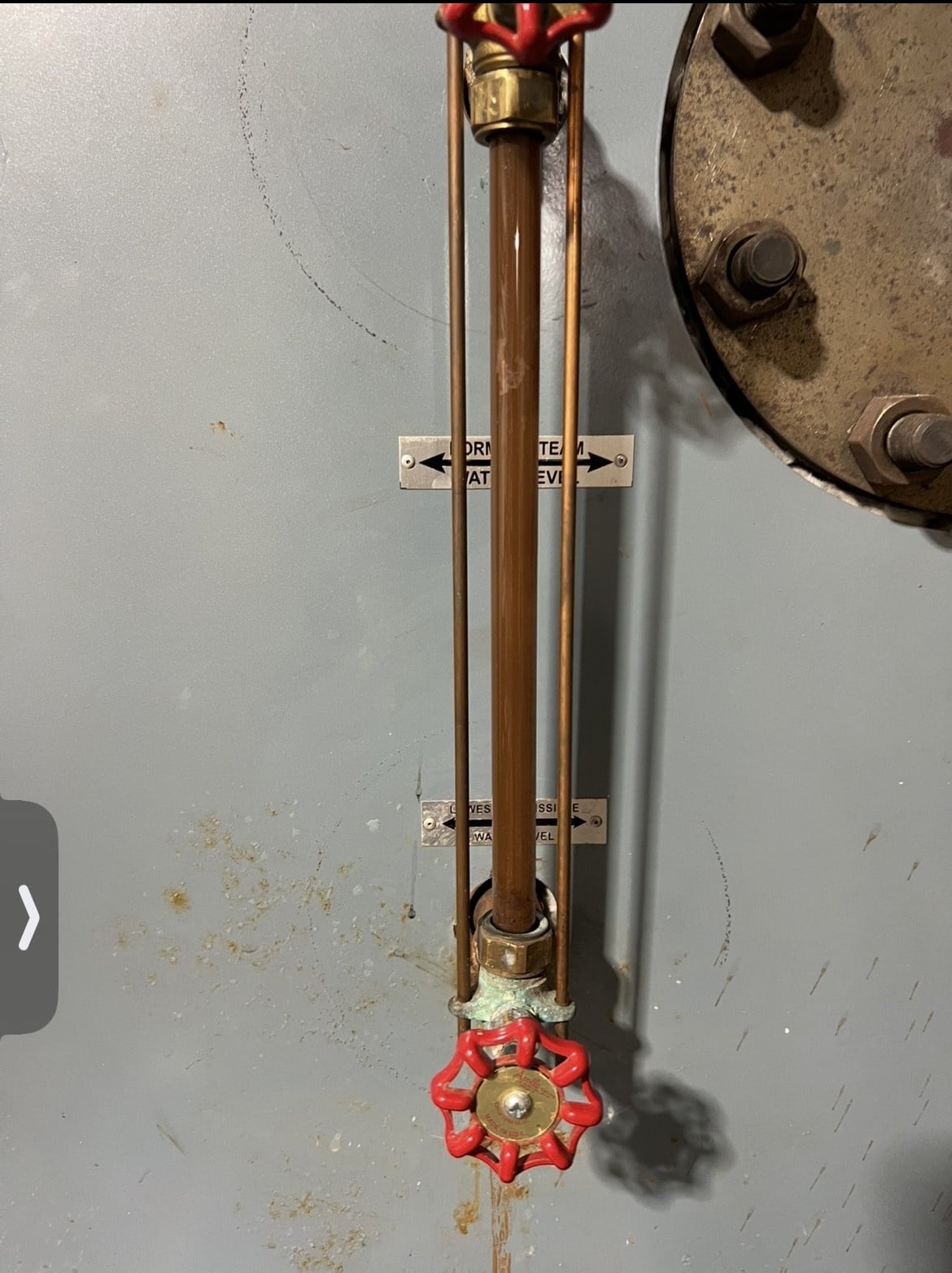

Fired up my boiler for the first time this year. I had cleaned my sight glass prior to firing it up. Shortly after firing it up the water got dirty. Seems like my water is surging when I watch the site glass. After reading through old posts seems like I may need to skim my boiler. I am not familiar with the process at all. So any input would be very helpful.
You should only need to skim it if oil was recently introduced by pipe work or new boiler install (which it doesn't look like it's too new).
You can get surging from other water quality issues than oil. Yours looks like chocolate milk with lots of suspended solids. I am not a fan of draining and refilling boilers just for fun, but you might need it here. Do you perform any water treatment? If not, you should consider adding a little 8-way when you refill, but keep the amount to like 1/3 of the directions…they want you to add too much.
See what others say, but that's my opinion from here.
Is there a valve on the return that is closed? I can't tell what that valve is.
There could be oil in the system if work was done elsewhere in the system.
May want to flush the wet returns also if you can. Do the flush when you can use the system immediately after.

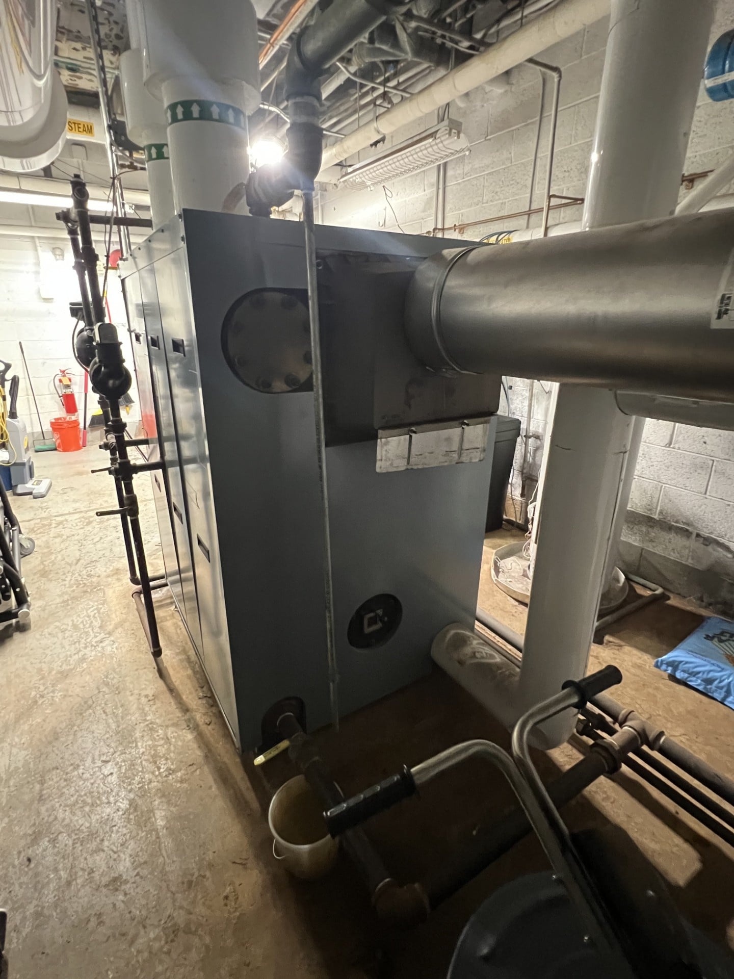

The older Smith 28s did not have a skim tapping. You can take the flange off the back of the boiler near the smoke pipe.
3 options
If the blind flange is cast iron, you could drill and tap it. Smith has an 1 1/4" (maybe 1 1/2") tap on the newer boilers
Or by a steel blind flange and have a welder weld a tapping into it.
Or call Smith and buy the new flange
Chances are the poor thing has never been skimmed
